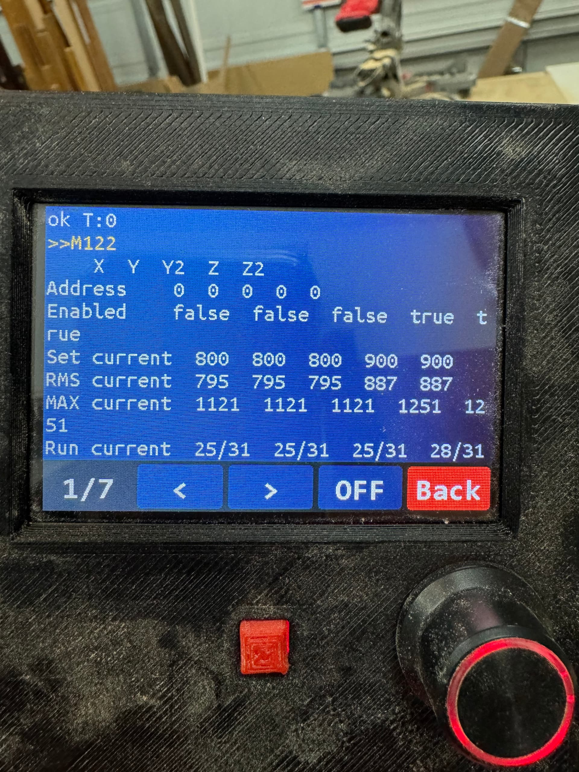

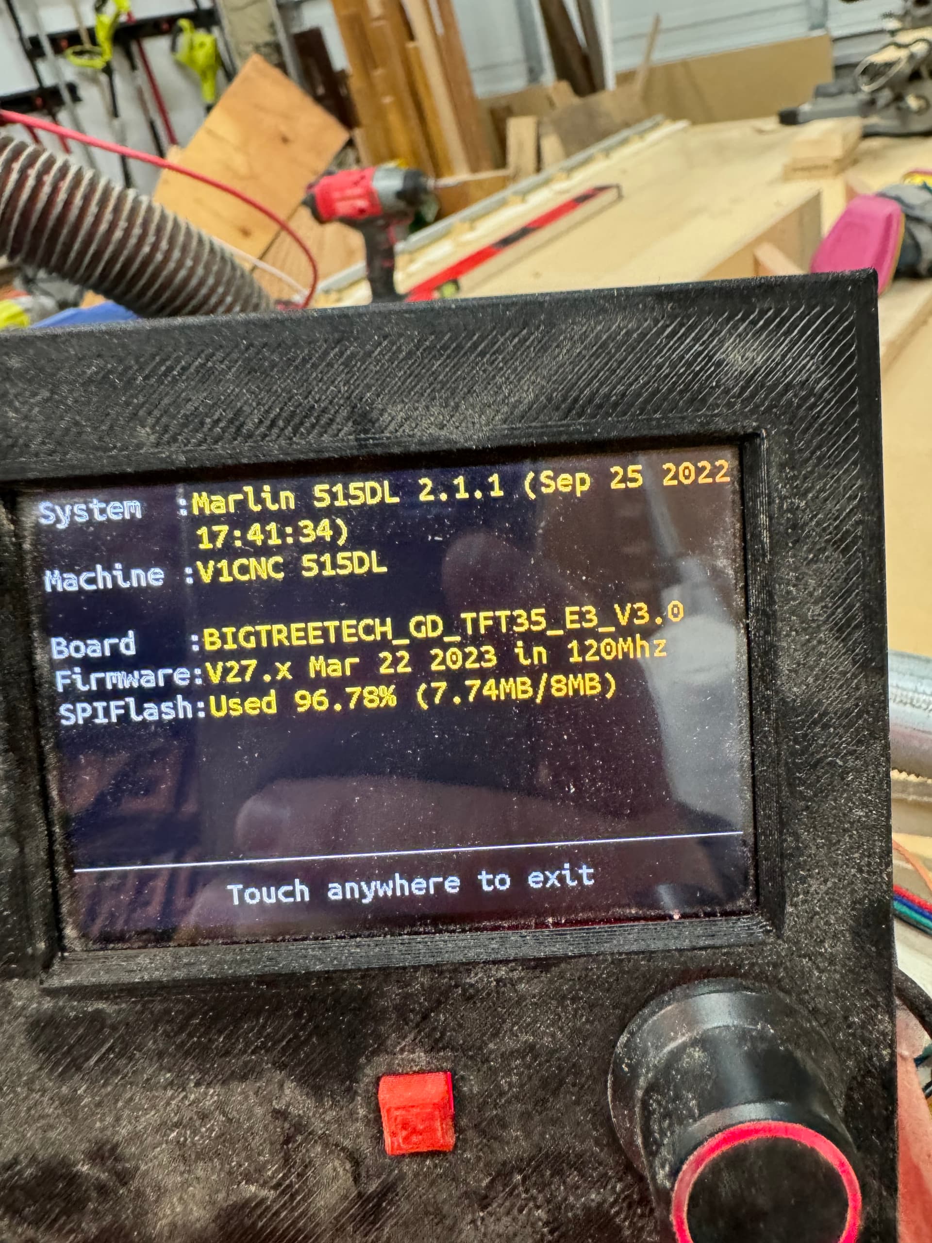

Edit: I tried updating to a new firmware but got the same issue where the max current increases with the set current.
Sorry, I thought you were talking about something else. That is like a peak reading, the tmc change if needed we are only worried about RMS.

Updated firmware to latest version

What exactly does this mean? Are you controlling the board with estlcam or are you exporting gcode and controlling with your screen?

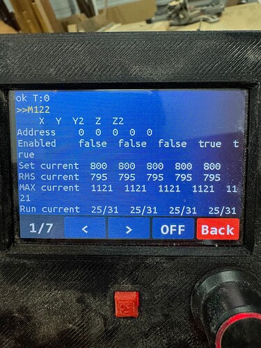

This is also suspect. How are you turning up your drivers, does it stick after a reboot?
The steppers need to be in motion to heat up, when not moving the current turns down by itself.
Exporting and used on tft or octoprint had issues with both, usually after the finish of a job or during a tool change.
M906 X# Y# Z#
How long should I use them for to test?
Use the onscreen menu and remember to save it to eeprom. 1200 should not work it should get smoking hot on your drivers and steppers.

I would say try 1000, and see if they warm up some. They are a different rating then mine. You will probably be juggling driver temps. Keep turning them up until your steppers get enough power but anything over 1000 and you will need a fan on your drivers.
Seems like you might have bought slightly overrated steppers. They need more current to get the same torque as the ones offered in the kit.
