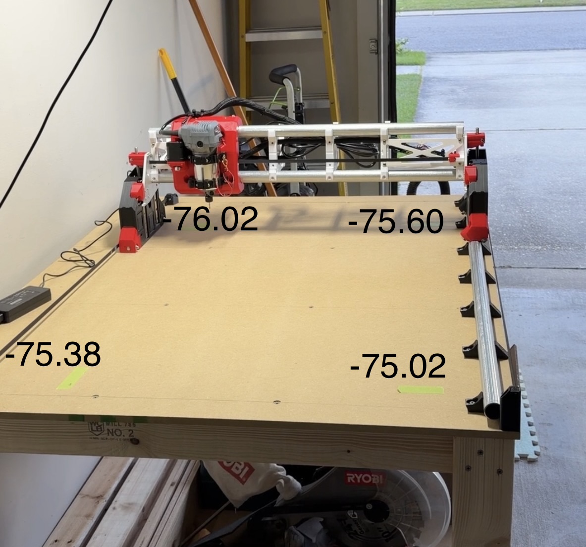

Hey all, noob here. I have been trying to level the z, and seeing some issues I hope are just my poor craftsmanship in table building.
I averaged based on instructions in 4 locations. I am assuming what I have should be fixed by surfacing the spoil-board, but wanted to make sure I am not missing something. Appreciate any help from the wise!

I think my concern is the 1mm difference in opposing corners. I was under the impression I couldn’t fix that, without throwing other things out of whack. Its completely possible I am real dumb here though, this is my first time.
My concern was the 1mm difference in the opposing corners. I was thinking if i fix back left (lowest) it will throw out other areas, but I am completely new, so I could be missing something for sure.
You can fix the left to right with pulloffs. The front to back would require surfacing. What kind of work do you plan on doing? Tweak the pulloff and that’s plenty good for through cuts.
You can fix the 0.4 left to right.
The 0.6 back to front can’t be fixed with limit switches or pulloffs.
The 1mm diagonal, you have to split in two axis because of that.

Which two corners would you recommend I use as the basis of pull off adjustment? Front or rear?
i cut my first strut plate, it cut through fine, but i noticed over the length run in Y, i was milling into spoilboard fairly deep in the front, down to nothing at the back end. Thats where I decided I needed to reach out to the forums.
Usually it’s done for the front which seems reasonable for your values.

i will correct the .4, and then look into a surfacing bit and try to correct the front rear after I cut my second strut plate.

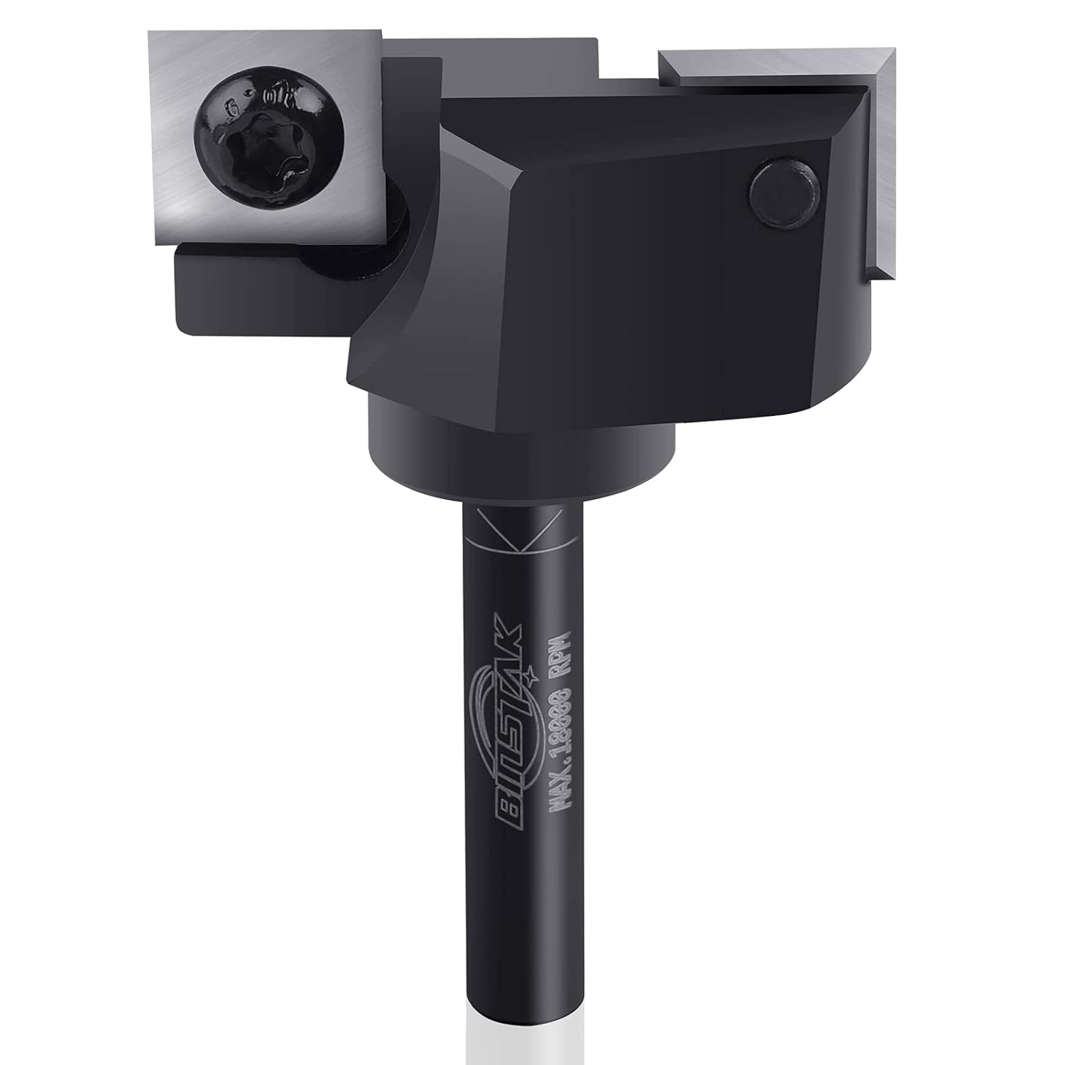

Better don’t use a surfacing bit in a trim router, they can’t slow down enough.
A dovetail bit or a stubby, larger endmill are the better choice.

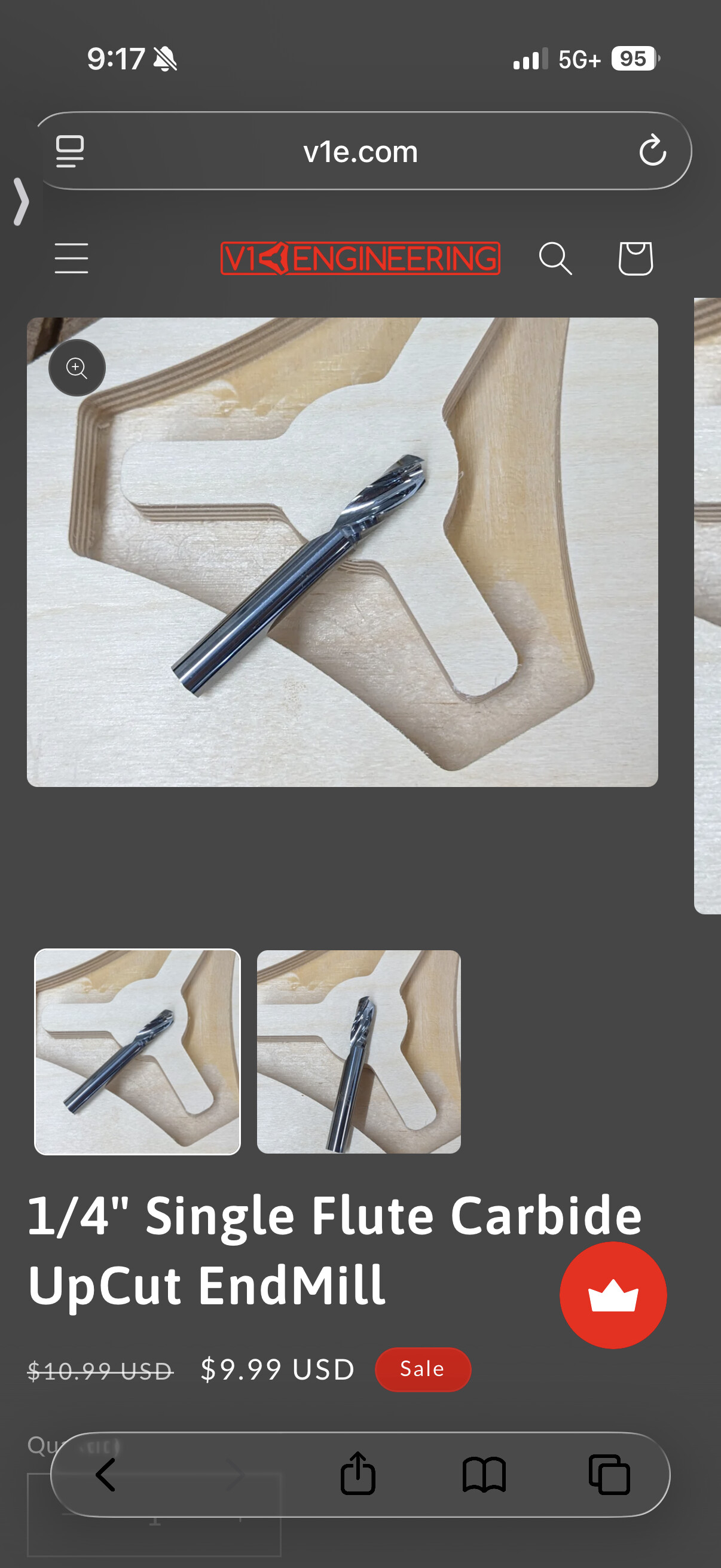

Goad you chimed in, I had no idea! I purchased this bit when I bought the kit. Would it be favorable to resurface?
Glad you chimed in, I had no idea! I purchased this bit when I bought the kit. Would it be favorable to resurface?
It will be a very long job to surface with that 1/4" bit. You’ll want some overlap, so you’ll be getting between 1/8" and 3/16" complete surface with each pass (after the first one), so divide your whole surface by that and see how many passes you’ll need.
The reason dovetail bits are recommended is that the bottom cuts flat but is quite a bit larger diameter, so you’ll need far fewer passes across the surface to flatten it out. I’ve already got a dovetail router bit, so it’s an easy call for me to make, but I would buy one for this task if I didn’t already own one. You may want to “do the math” on babysitting the machine for the full duration of the surfacing job to decide whether it’s worth investing in one.
Something like this. This is the one I bought.
https://www.amazon.com/dp/B00002241Z?ref_=ppx_hzsearch_conn_dt_b_fed_asin_title_2
I have that exact one as well.
