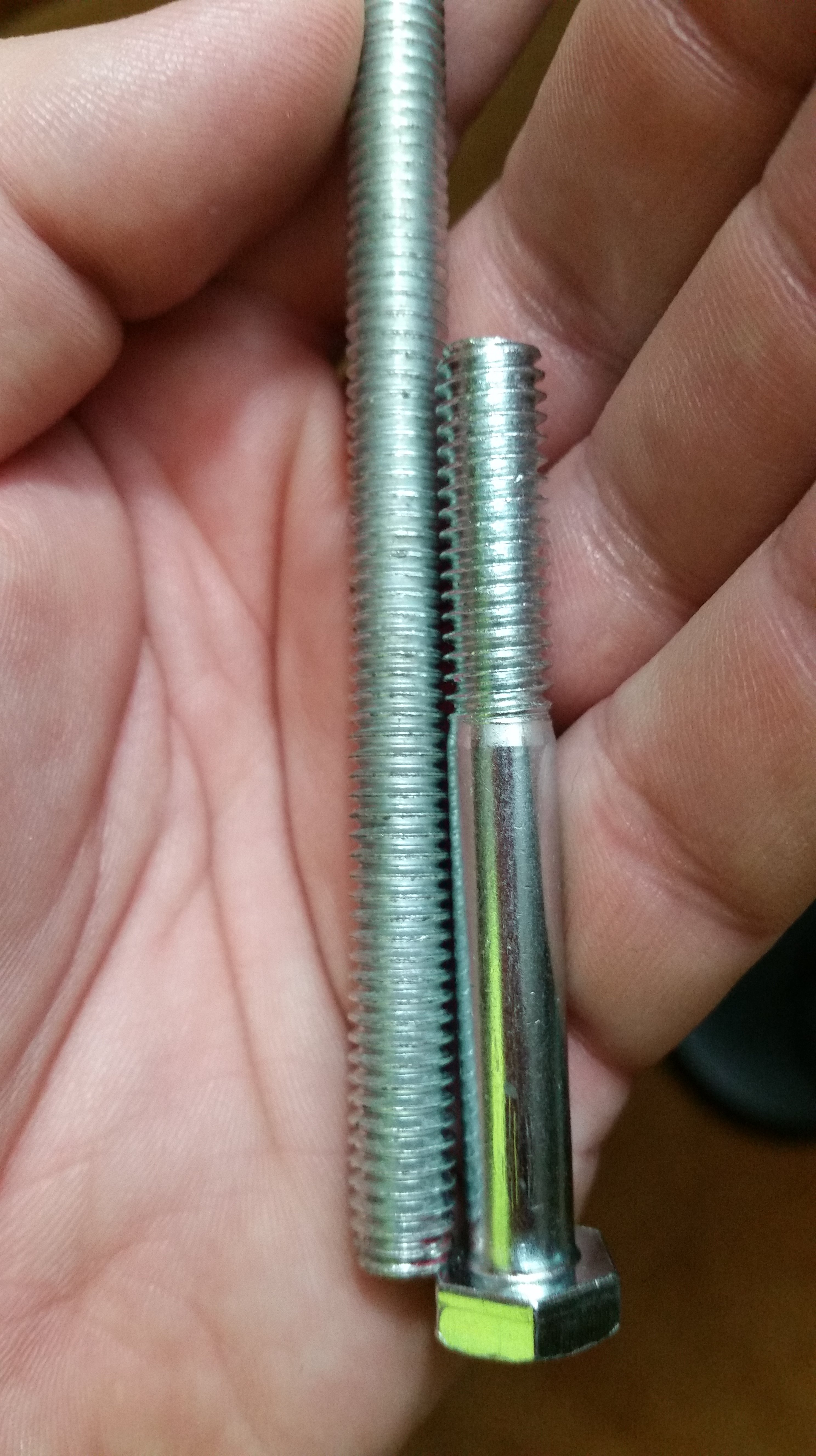

Well, after jacking with this the last 2 days(buying a file, hacksaw, angle grinder, etc to try and get a nice clean cut on this threaded rod, I figured something out. I bought a foot long stick of this 5/16 threaded rod at Lowe’s, but finally looked at it closely, and discovered that the threads are not “angled”. I can stick my fingernail down an inch from the end in the groove, spin it around, and it never moves up or down. Not sure the technical term, but this piece of krap isn’t angled. So that would be a good reason that this won’t fit onto either a regular nut or coupling nut. Has anybody ever heard of something like this? The grooves are basically flat across it. I will try and find another piece tomorrow, but super frustrating. Been stuck on this since Saturday.
What? I have not seen that. I hope that is some crazy bad batch, not an actual product.
Here’s what I’m talking about, 5/16" bolt on the right, “threaded rod” on left. You can see this krap doesn’t angle like the bolt does.
That is crazy, I have bought so many sticks of that and had some crazy threads but never, NO threads. Shoot how frustrating.
Hahahahaha! That usually doesn’t make it past qa! Have you ever seen how this stuff gets made? It’s not run through a cutting die, like if you made a bolt yourself at home. It’s standard smooth rod run between two ribbed roller dies that press the grooves in. Sometimes the bar will get caught and cause weirdness.
