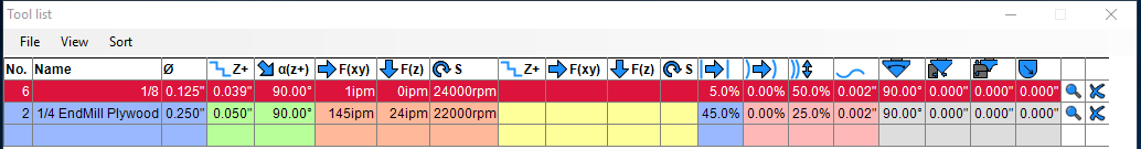

Ok so I’ve aligned a few things differently as follows and still have the left side lower by 2mm consistently than the right.
  1. moved the pipes further out from the table
  2. checked the tension on both the top and bottom side plates on the stainless steel pipe
  3. loosened tension on the M3 nut by 1/4 and 1/2 turns testing in between
  4. Modified my tool settings in Estlcam according to the pix for Z plunge
Although it's better- it's definitely still out consistently at 2mm. I've run the Z axis up manually to 50, dropped it ran it up at least 10 times to monitor the amount of change.
My M3s are a bit stretched out due to the z axis going negative twice by accident on testing a few days back. I’ve ordered in 2 more M3s and they should be in tomorrow late.
However- even with the above, the 2mm is still there.
