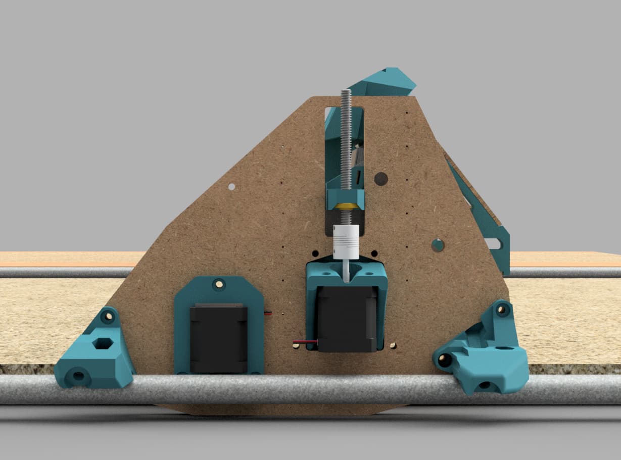

So it looks like I would need to drop the Y rail by 27mm, and the belts by 36mm to get them both even with the table surface.
My initial impression is thats not great, but not the end of the world if I don’t go too overboard with spoilboard thickness. The effect is roughly like adding a very thick spoilboard.
I had been hoping to take a bit off the bottom of the LR core to compensate, so I could mount the router a little higher to compensate. That seems tricky due to nut clearance for the rear bearings. It’s already quite space efficient.
I’ll think on that, there may still be a way.
The other thing I can do to help compensate for the reduction in stability is giving up some Y space efficiency - which I can afford as my table is already oversized - and move the Front and Rear rail rollers further apart as I move them down. That doesn’t compensate for moving the belt down but it at least helps with the roller position.
I may be wrong, but my gut feel is the reduction in performance will not be earth shattering. Perfect from an engineering standpoint, no. But possibly an acceptable compromise.
To compensate for the lowered belt position, so far my only solution is to make the Y drives stiffer - more material or stiffer material so the extra leverage doesn’t cause deflection of the parts. May need to do the same thing for the YZ plate as it will be taking the brunt of that extra leverage once the Y mount is stiffened up.
Have not explored how I would approach the design of that yet - that is for another night.

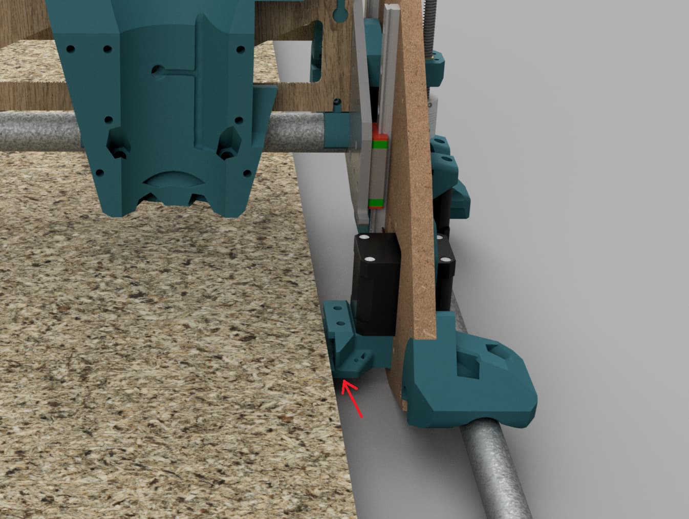

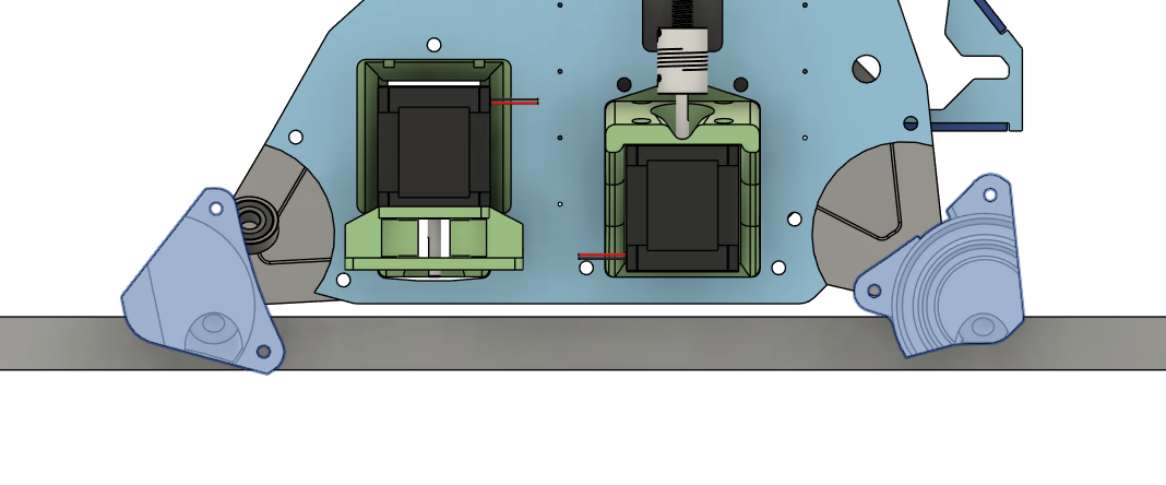

So where I have ended up is modifying the side plate and essentially just mirroring the Y drive and rollers so the rail is on the outside and the belt is on the inside just below the table surface.
The fornt rollers moved forward 30mm and 27mm down, the rear rollers moved back 30mm and 27mm down, the motor mount moved down 38mm. Rollers spaced out like that to lengthen the wheelbase to counteract the larger moment caused by dropping the rail 27mm
Can keep the other side essentially stock, except for a new motor mount which I have yet to model - should not be too hard.
Then I just need to do rail mounts and belt mounts/tensioners and I can start printing and cutting and building while I finalise the rest of the table resign.

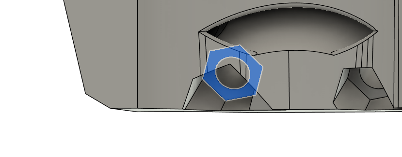

I have decided to use a smaller pipe for the Y rail - 21.3 as the way the bearings sit on it should be more stable than with a 25mm pipe
This sketch shows the bulk of the changes from stock

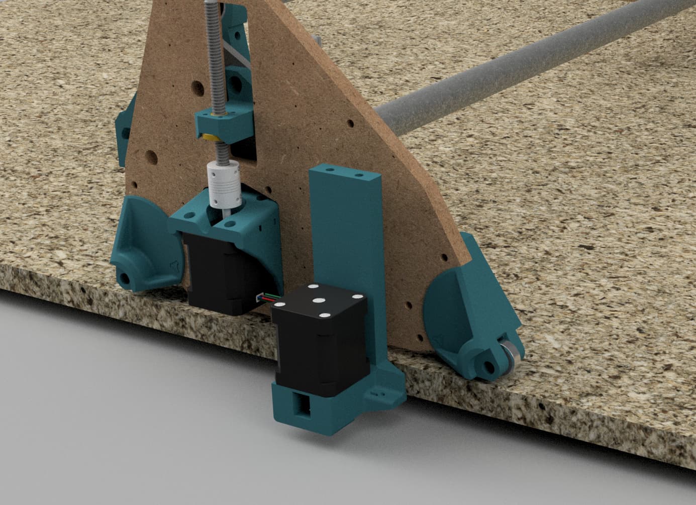

The only change I am going to make on the left side of the gantry is to move the belt so it runs just below the surface of the table. See the last picture.
The goal here is not to run two rails, just to move the belts and rail to be flush with or just below the table surface, so I can pass stock over the top without hitting the rail or belts.
on the left side, the only change to stock will be to the Y motor mount lower so the belt sits just under the surface of the table. I have not done the cad for the part yet, but this render shows the rough positioning.

To be clear, the changes I am intending to make to the base low rider design are as follows
  1. New belt mounts/tensioners that bring the Y belts just below the surface of the table.
  2. New semi adjustable rail mounts that allow me to side mount the rail to the table and fine adjust it so it is straight, parallel to the side of the table and most importantly flush with the surface of the table
  3. On the right side of the gantry mirror the belt mount and Y rail rollers so that the belts are on the inside 4mm from the table edge and rail is on the outside, 6cm or so from the table edge.
  4. modify the ZY plate on the right hand side so that the front roller is 30mm further forward, the rear roller is 30mm more rearward, and both of them are 27mm lower so they can ride on the new lower than stock Y rail.
  5. On the right hand side the motor mount is moved 38mm down to lower the belts below the surface. I recognise this will introduce minor instability as it means they are no longer in-line with the spindle I will attempt to increase the rigidity of the parts to help counteract this.
  6. on the left hand side of the table the motor mount is redesigned so that the belt runs in a similar position to the right hand side belt - that is 4mm from the table edge, moved 38mm lower so it sits just below the table surface.
