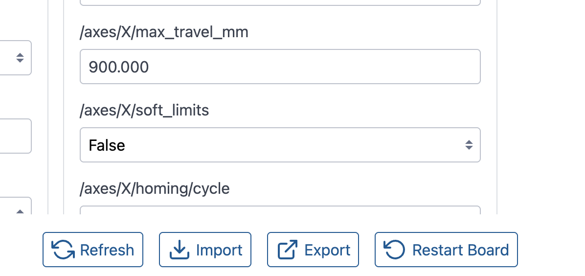

I have LR-V4 moving and square to within 1mm (!). My table is roughly 3x5’; I’m trying to set X and Y max limits to 930mm and 1220mm.
I’m changing [ /axes/X/max_travel_mm ], saving then restarting the jackpot 3 controller, but I’m still able to move past these limits. Is the the right parameter?
That only works if soft limits are also enabled. They can sometimes cause grief though.
Makes sense! I’m coming in from 3d printing (Klipper) where build space is pre-defined. I can see where limits here, depending on co-ordinate space could be an issue.
