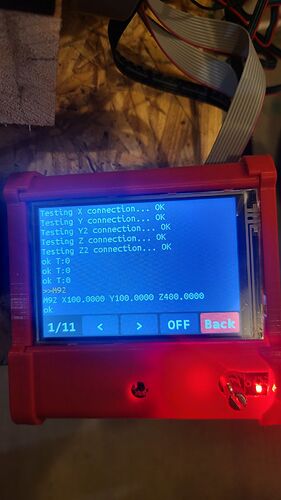

That is what we needed to see.

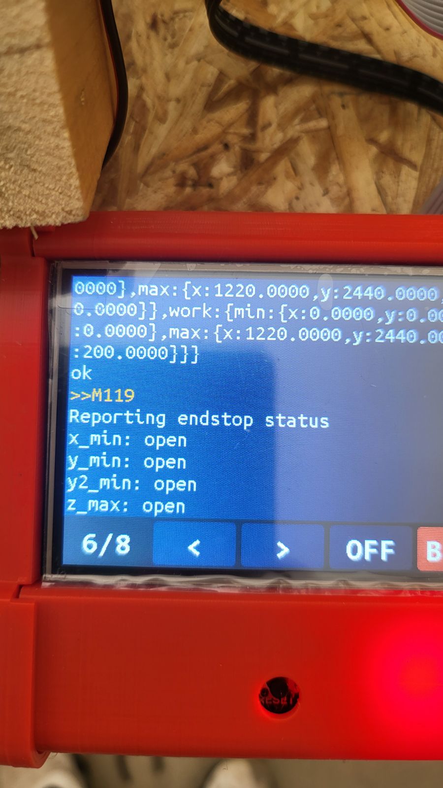

Those two should not be triggered, they should not affect anything but for now just unplug them. Give the steppers another try. Try moving them both ways as well please.

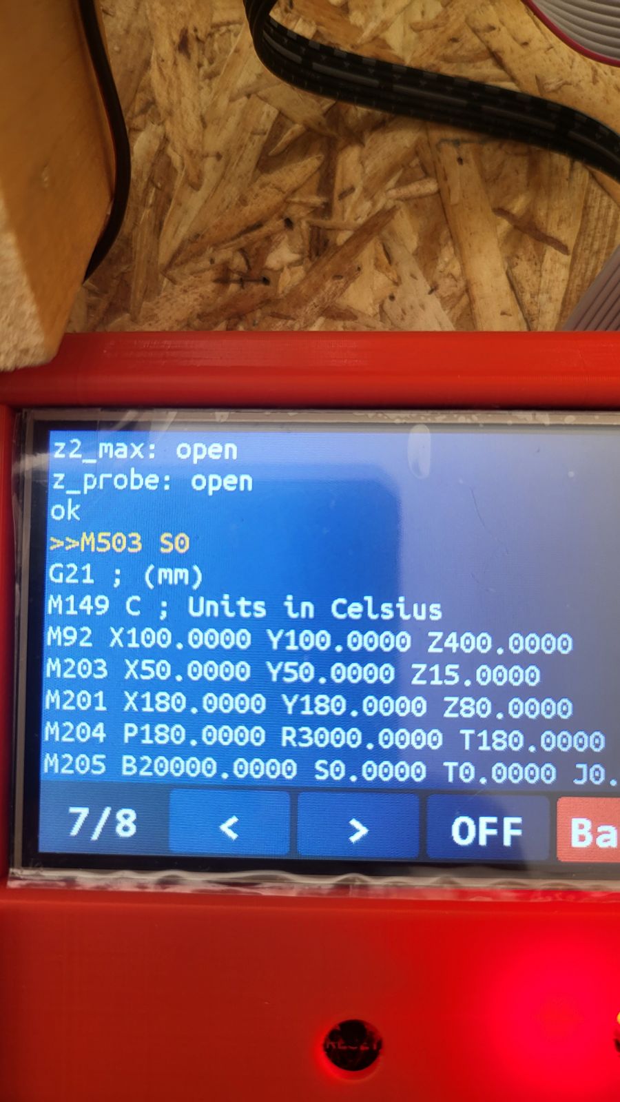

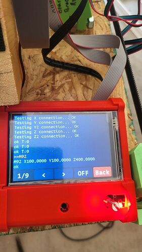

It shows you have the correct firmware, your m92 is really odd but that could just be from testing.
When unplugging the ends tops, all say triggered and x axis does not work+ or -. When all ends tops are plugged in. They register ok. X axis still does not move, left or right. I did notice when I move the x axis manual, it registers at the top on the screen. But no physical movement on the stepper.
Y an z axis both work in + and - movement
That looks right to me. 100,100,400.
