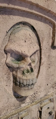

I too am interested in what pab-IO will be making with material that is that thick. I built my machine to allow for cutting props in 2" foam panels. I don’t do it frequently, but it is nice to be able to do. This Dawnguard War Axe from Skyrim is cut from 2" foam. The cutting is done, but it is waiting on my daughter to be home from college to do the texturing to turn panted foam into metal and wood.
And I carved the face of a skull for a Halloween tombstone decoration:

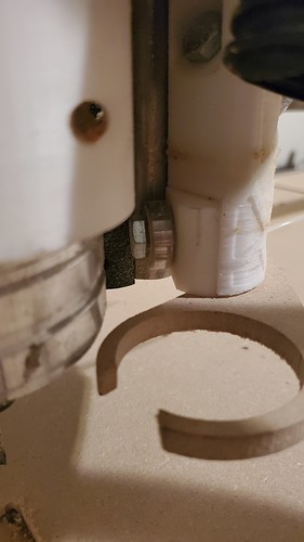

Gonna jump in here because I have a 24x48 primo and I cut these out for powder coating…
Keep the aluminum work near a corner if possible, at least near a rail if not, and attach it to a stack of boards.
This is the piece I cut out on, and that was on another piece of mdf, which was on my spoilboard, which is on top of the base, which is on top of the desk, lol.
The idea is to keep the z tubes in the core, close to the bearings while cutting, right around here…
Not so low it lets the router get leverage on the z, not so high it pops out of the bearings on retracting to the safe plane. This also forces/allows you to choke up on the endmill…the more it sticks out, the more it flexes, too. Maybe not as important for 1/4, but I think it helps somewhat for 1/8.
If you want to cut aluminum in the middle at the bottom of travel, it’s gonna be tough, but do those two things and you get a LOT of your rigidity back. When I was cutting those, I noticed more flex coming from my 611 mount than anywhere else.
