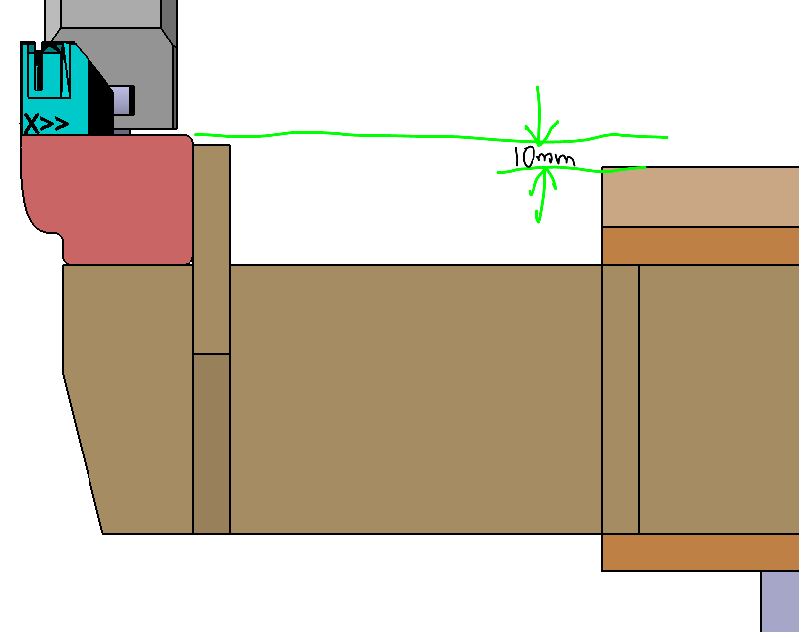

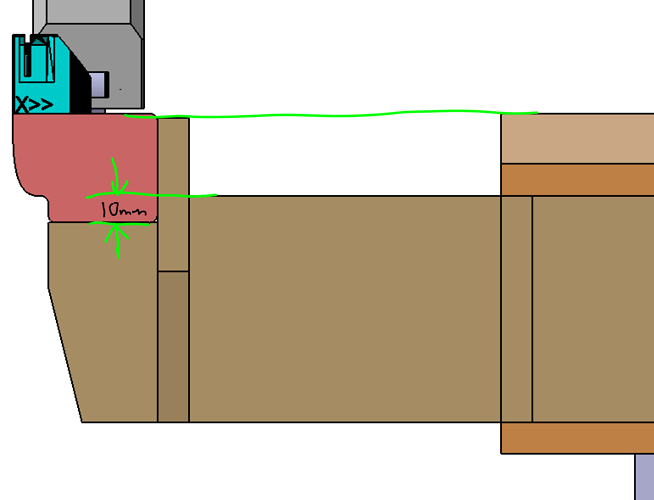

But one last question… I currently have my table designed to level the top of the uni-strut with the top of 0.75” MDF spoilboard. That detail requires a secondary notch cut in my cross-rails to level things up.
The notch is 10mm deep in Z. Can I skip this notch and just build with the top of rails ~10mm above the spoilboard? I’m assuming “yes”, but just wanted a confirmation before I start cutting…
Thanks!
Notched version :
Un-notched version
