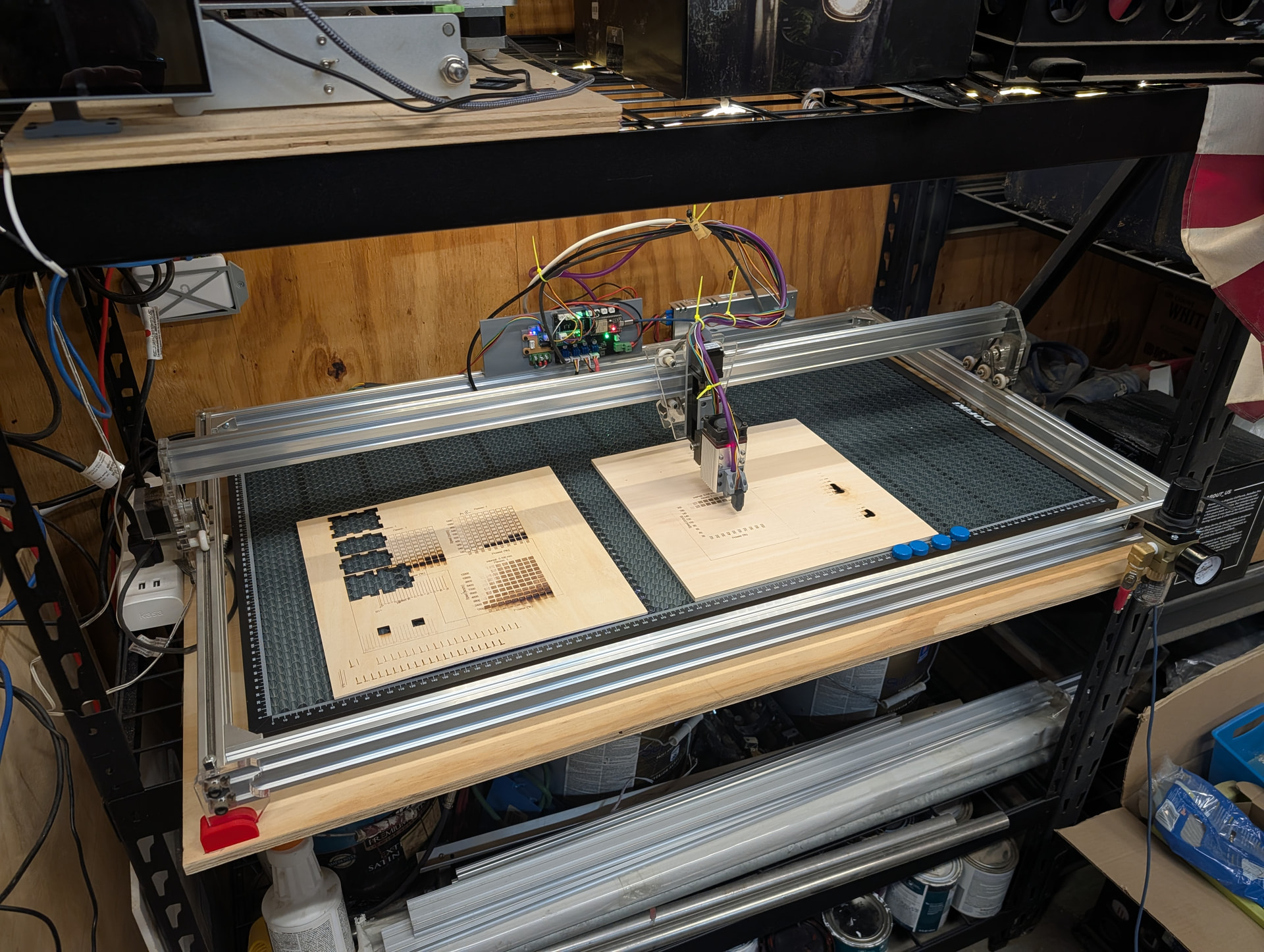

I was able to burn a cut through 3mm and 6mm plywood last night. Took a few tries to find the right combination that would cut through the 6mm without causing charring.
Here’s what I ended up with. Both using air assist.
6mm: 300mm/s, 3 passes, 100% laser, 1mm step down per pass
3mm: 200mm/sec 70% single pass.

Ok. Everything is working now. SD Card issue ended up being the card I was using. I picked up an 8G card, formatted it FAT32, and it works fine.
I’d say this project is complete.

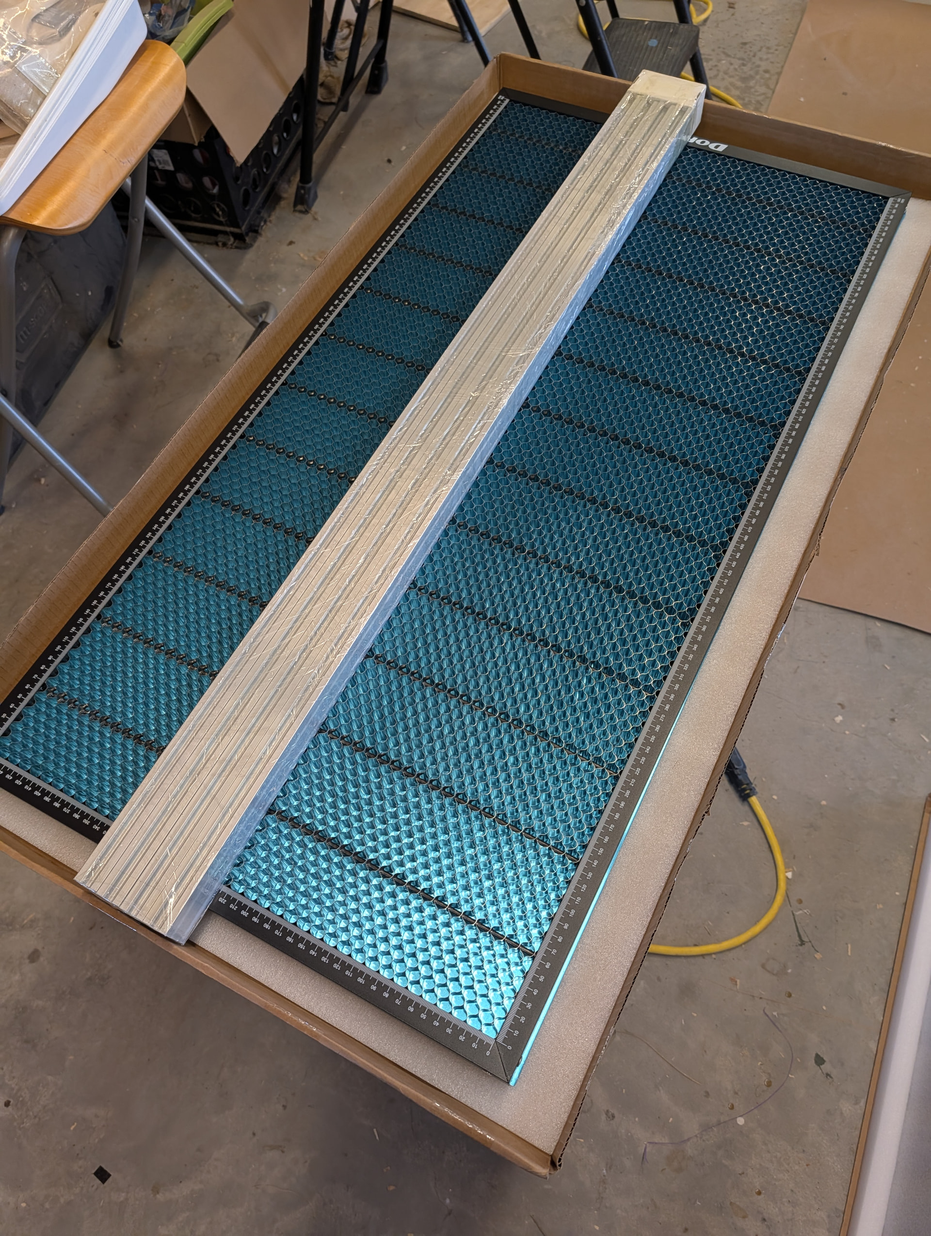

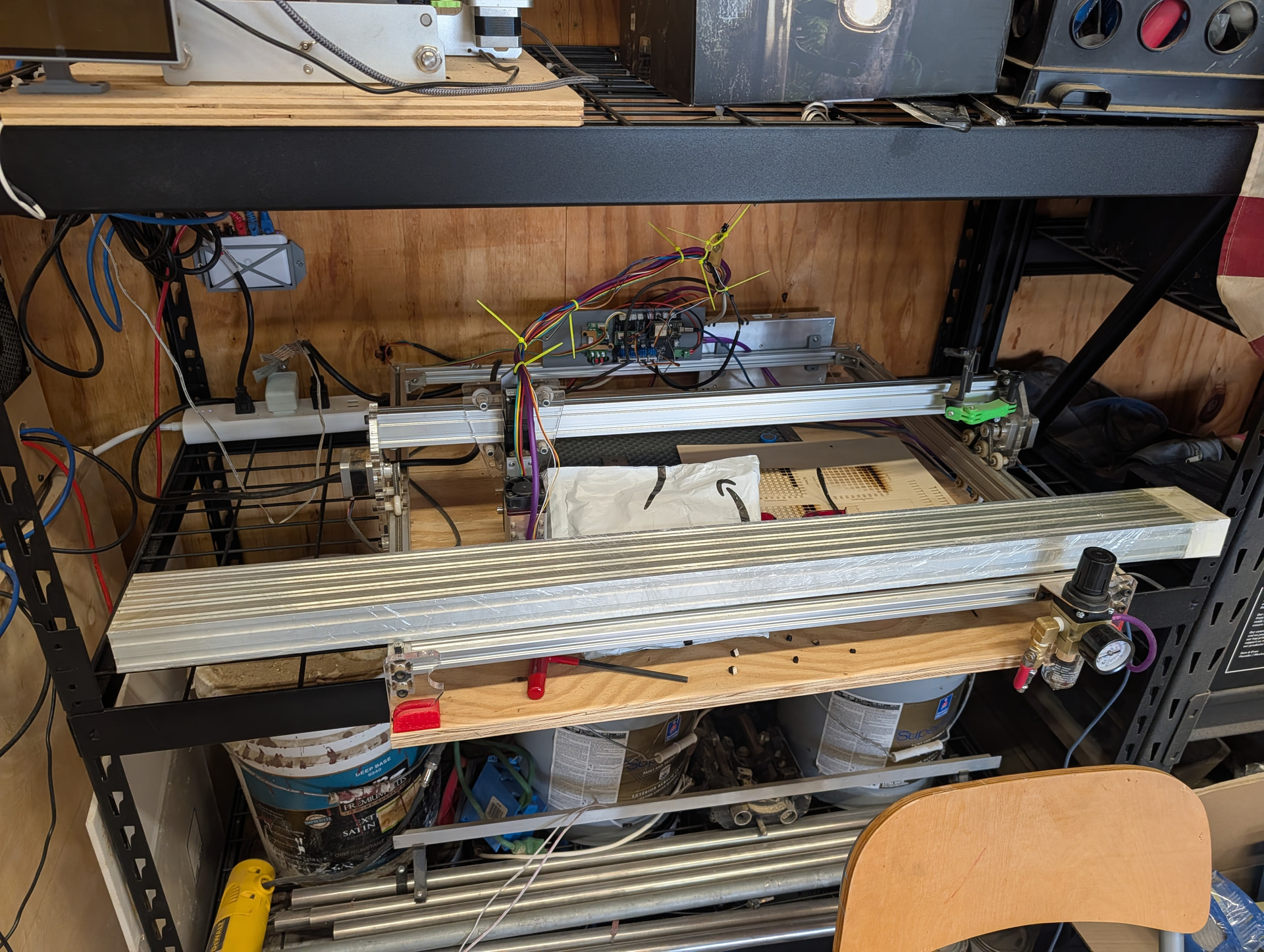

The reason for the longer rails arrived today…
Heh… Measure twice… still order rails too short. The laser needs 47mm of hangover on the gantry because of the design. If I cut the 1000mm rails down for the front/back rails so the 1000mmm gantry fits, then the honeycomb is too wide and hits the Y carriages.
I had to order the 1220mm rails that I almost ordered the first time. Now I need to decide if I stick with the 1000mm front/back rails, or go ahead and make the gantry larger. I’m probably going to stick with the 1000mm front/back rails as the honeycomb really does fit quite nice at this size.

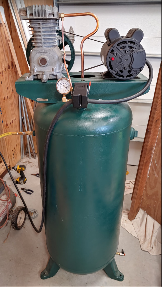

I have that laser. I really like it. You will want an air pump too. It makes a big improvement on the cuts and it helps keep the laser lense clean.
This is what I have:
https://a.co/d/02DHsrOb
I think I saw you mention about this is another thread. I had already ordered that one. Thanks.
My air pump is slightly larger
I’m guessing you’ll want a water and oil separator on the line you run to the laser.
This was an older picture. There’s one coming off the tank plus I have a separate filter/regulator on the front of the laser itself after the long hose run.
This is how I do it as well.

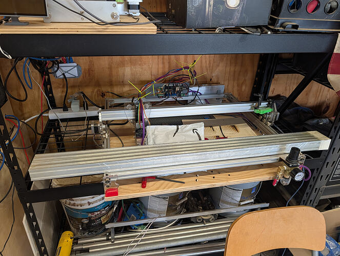

Alright. The laser is larger now.
