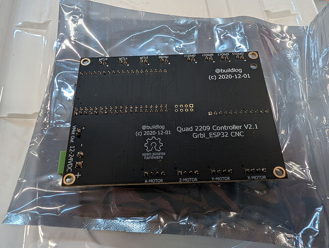

The documentation for the board says it only supports 12V (for now). It says there’s a future version that will support a wider range.
Ah. So it is the board with the limit. Can you try driving it at 12V? It might still work, but you may lose some top speed.

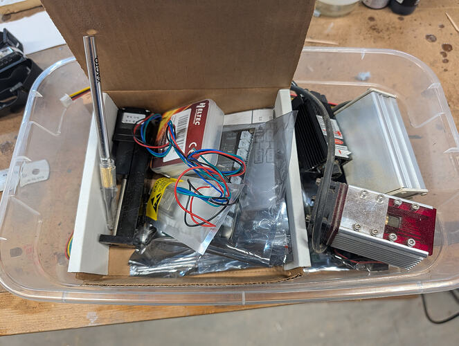

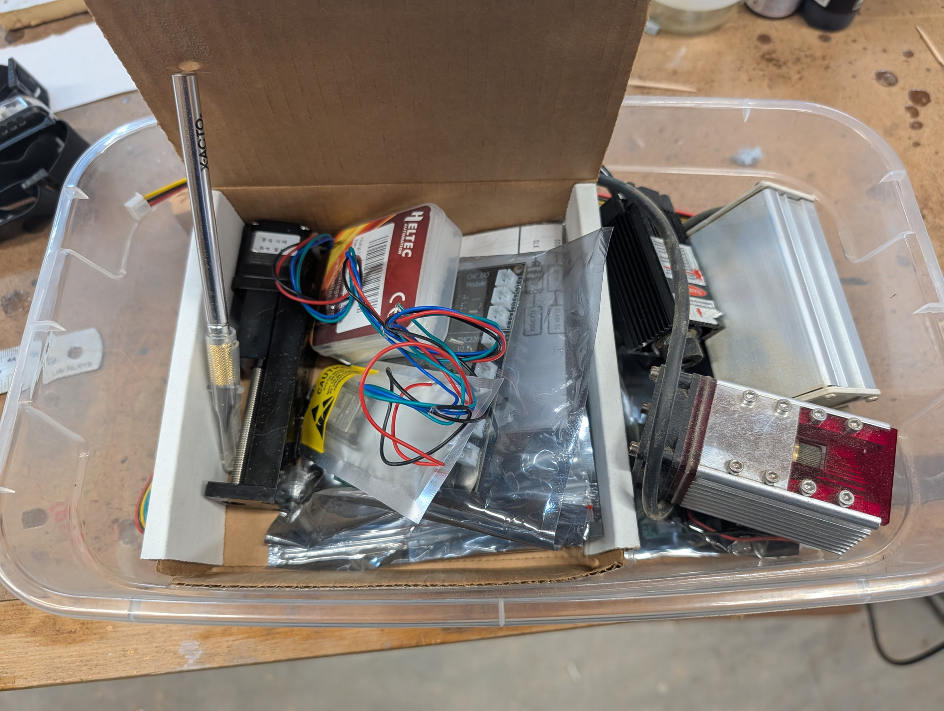

This afternoon I’m going to dig around the shop and try to find the parts I bought for this.
Heh. When did I start getting organized?
I has a .357 inch of dust and dogs hair on stored items.
The dog hair is all over the house. The dust is why I started storing all projects in these clear plastic tubs. At some point I was even smart enough to label some of them. This project box was not during that ‘smart’ time frame.

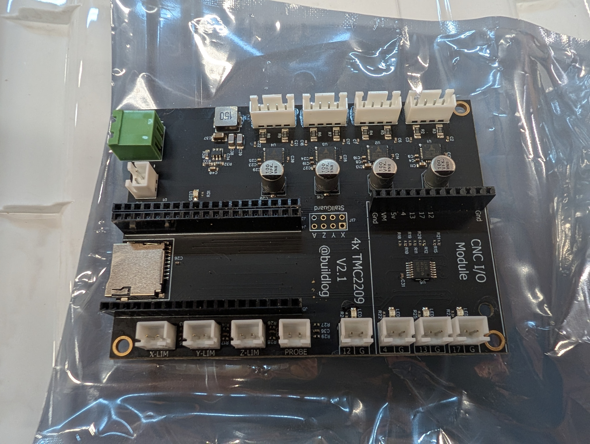

Step 1) Get the Bart Dring board flashed and ‘working’ with FluidNC

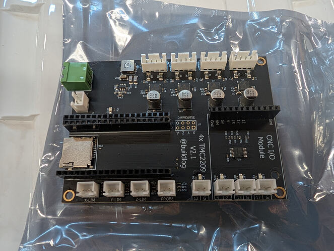

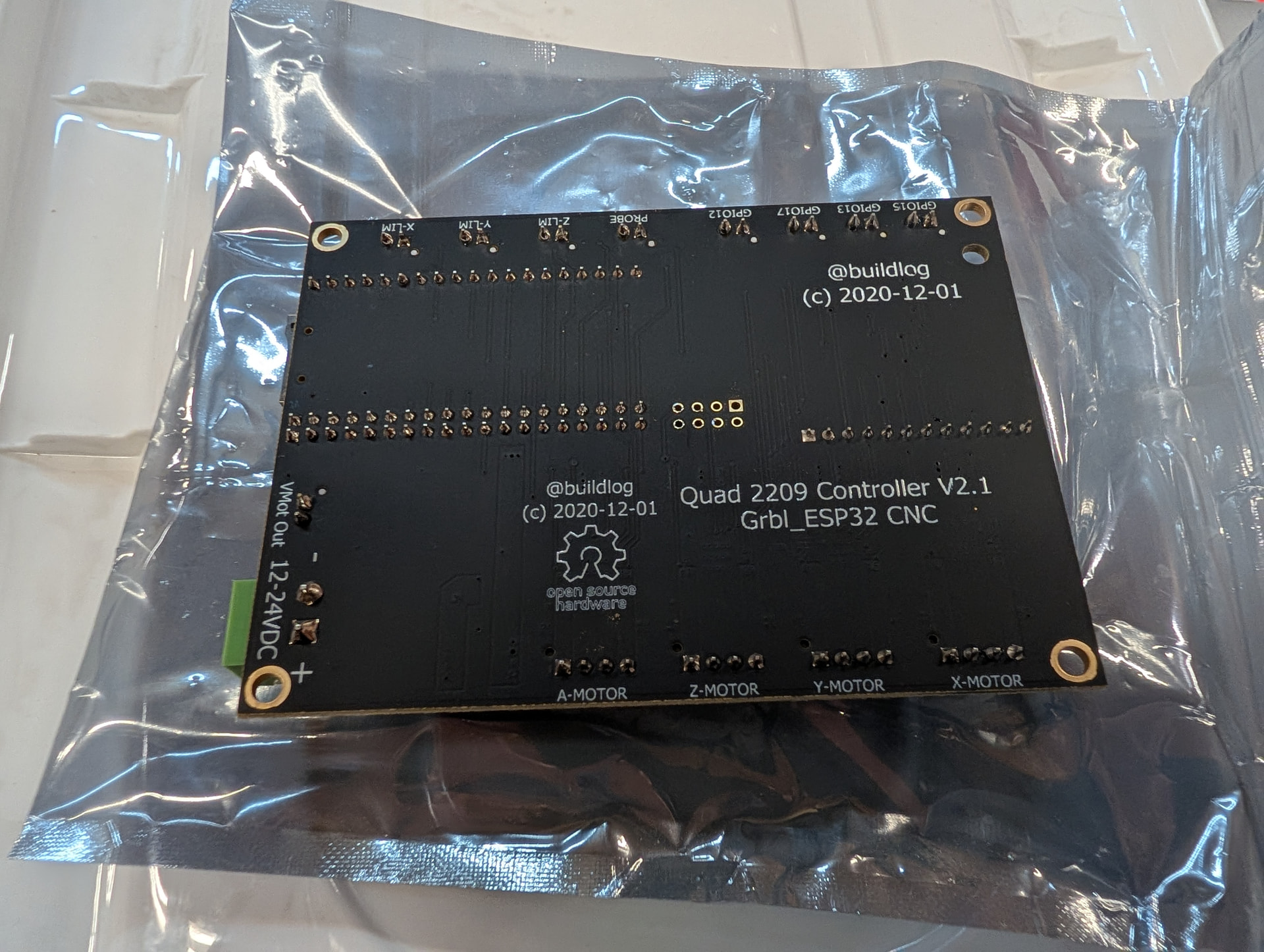

I got the board flashed and hooked a stepper motor up to it. The board I’m using is an older one that doesn’t show up in ANY of the FluidNC documentation.
My board is this one: GitHub - bdring/TMC2209_4x_DK: TMC2209 4 Acis Grbl_ESP32 Controller My pinouts seem to align with the V2 versions of this board.
Here’s the working config.yaml that I managed to at least get the X-stepper motor turning with. I need to set it up for dual Y-steppers and at some point I need to try hooking up a laser.
I tried to get Gemini to help write the NC code. It kept insisting on using newer versions of the board even when I pointed it to the github link and told it to use V2. It’s a good thing I can read schematics. It also kept trying to use the I2S that the newer boards are using.

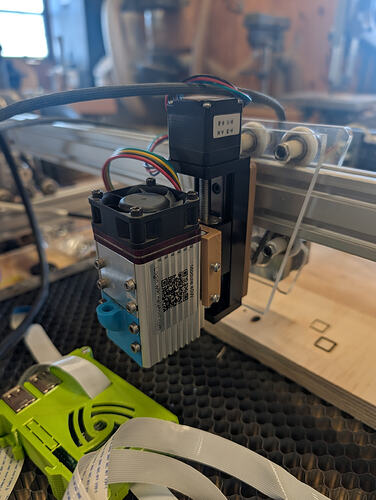

Got the Z moving and calibrated. Need to design a mount now.
I had today off. I got a lot of work done on this machine.
I have the Z mounts pretty much finished, just need to print the last version.

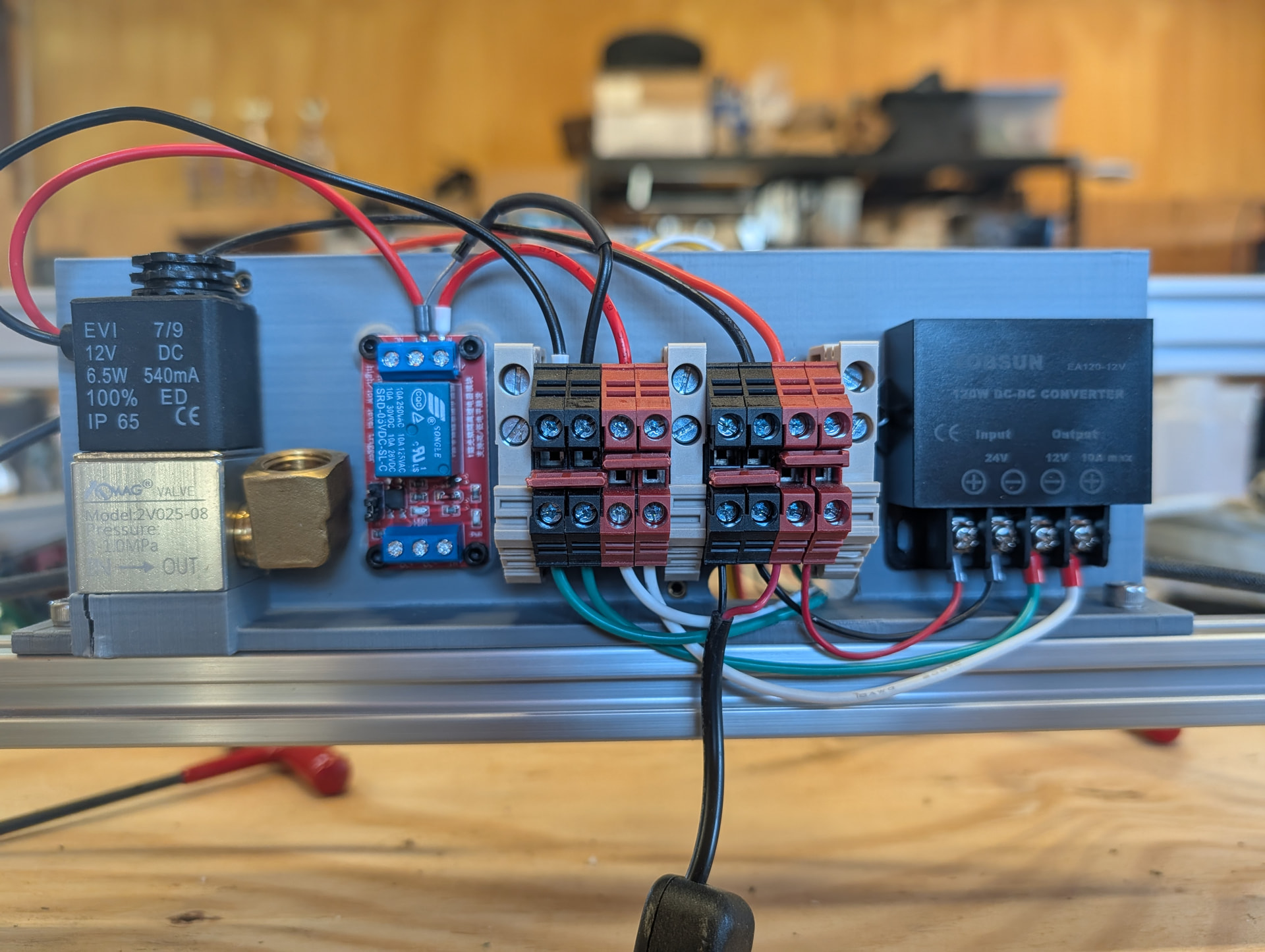

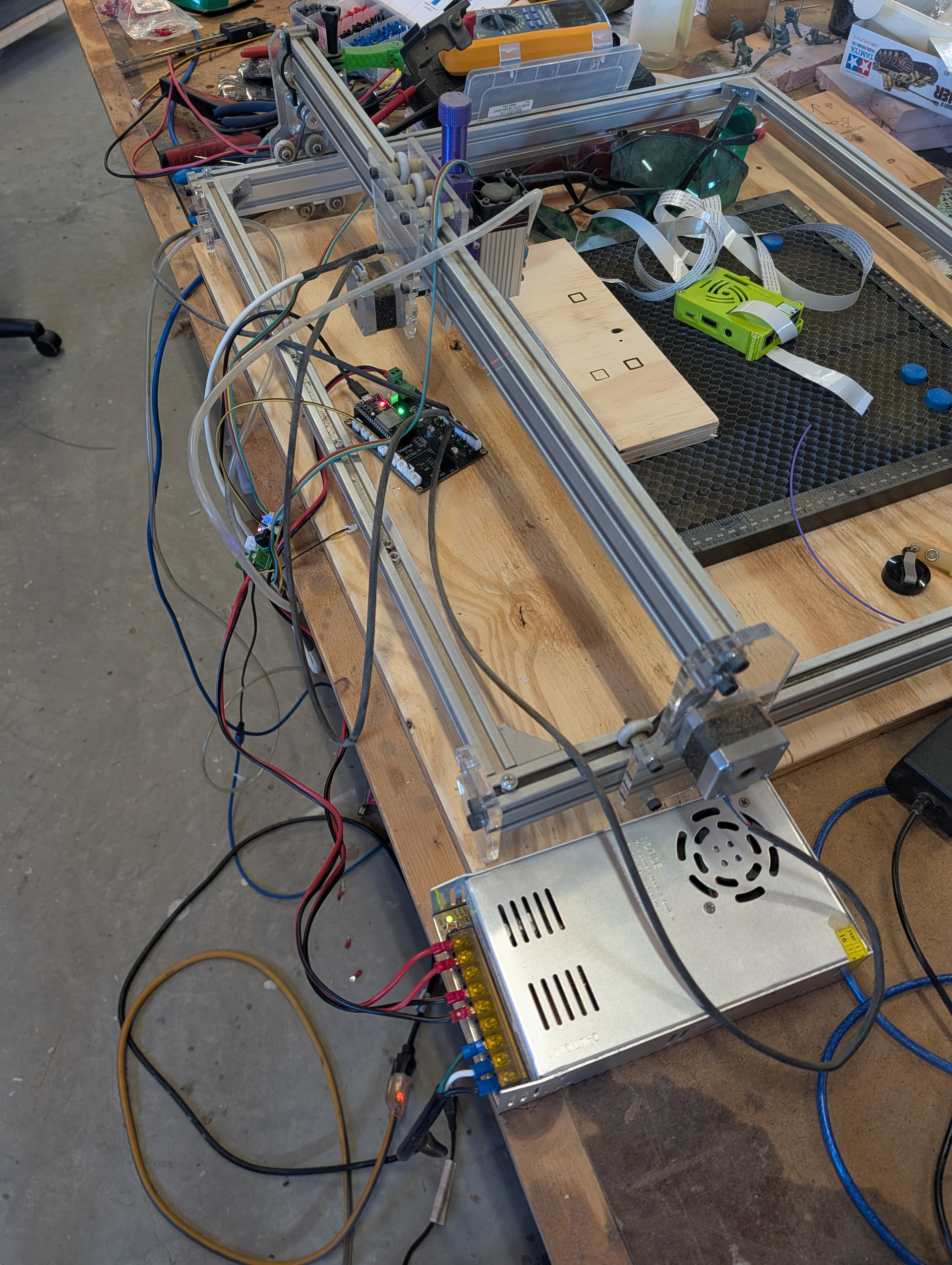

Ok. I have all the electronics sorted out. I’m switching the system over to a 24v PS for the steppers and BartDring board. I have a 24v->12v buck converter that will handle the 12v laser and solenoid. I’m using spare parts from the MP3DPv4 build for some of the electronics. I am having to use a 5v relay to trigger the 12v solenoid. The BartDring board does have a 12v output that says it’s for low-voltage lasers. I could probably figure out how to trigger that for the solenoid, but I’m afraid of the solenoid frying the controller. As it sits, I’m already planning on wiring in a flyback diode on it.

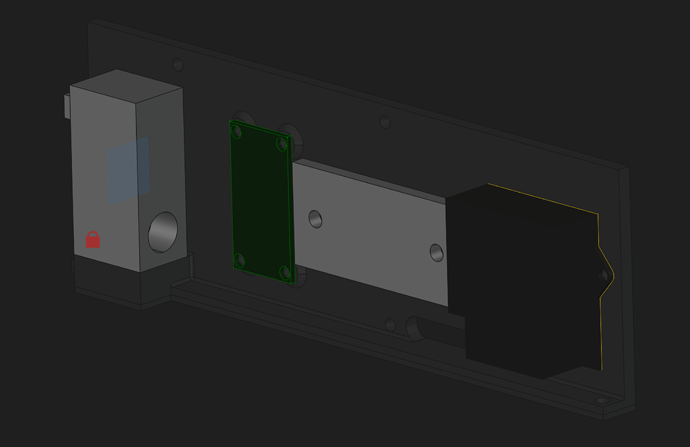

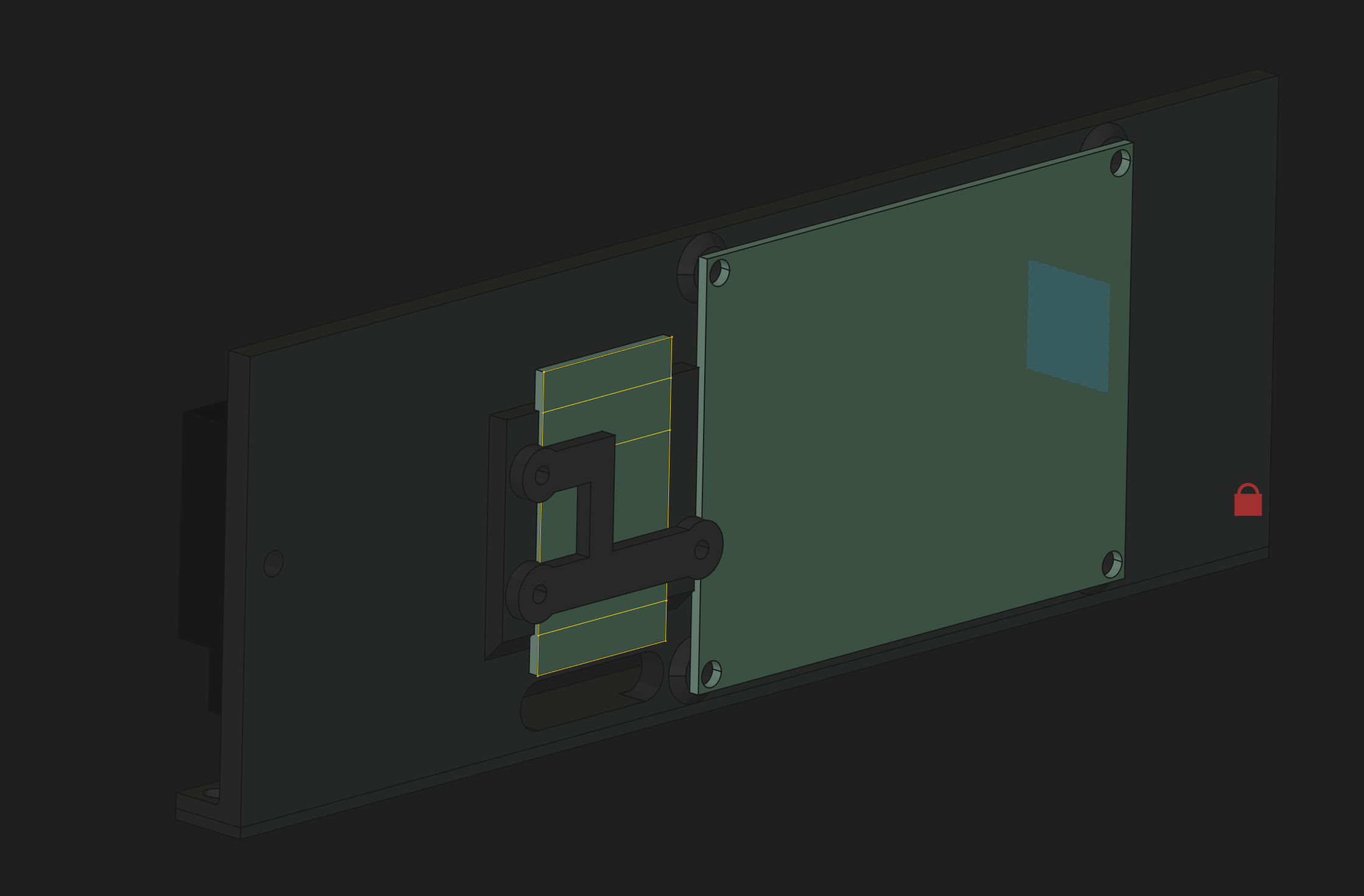

Here’s some renderings of the mount plate I’ll be printing. This will mount on the back rail of the laser. The controller will be on the gantry side and the solenoid and power stuff will be on the backside facing the wall.
The PS is a 24v brick, so no bare 120vAC stuff I have to worry about protecting. I’ll probably design a lid for the electronics box at some point.

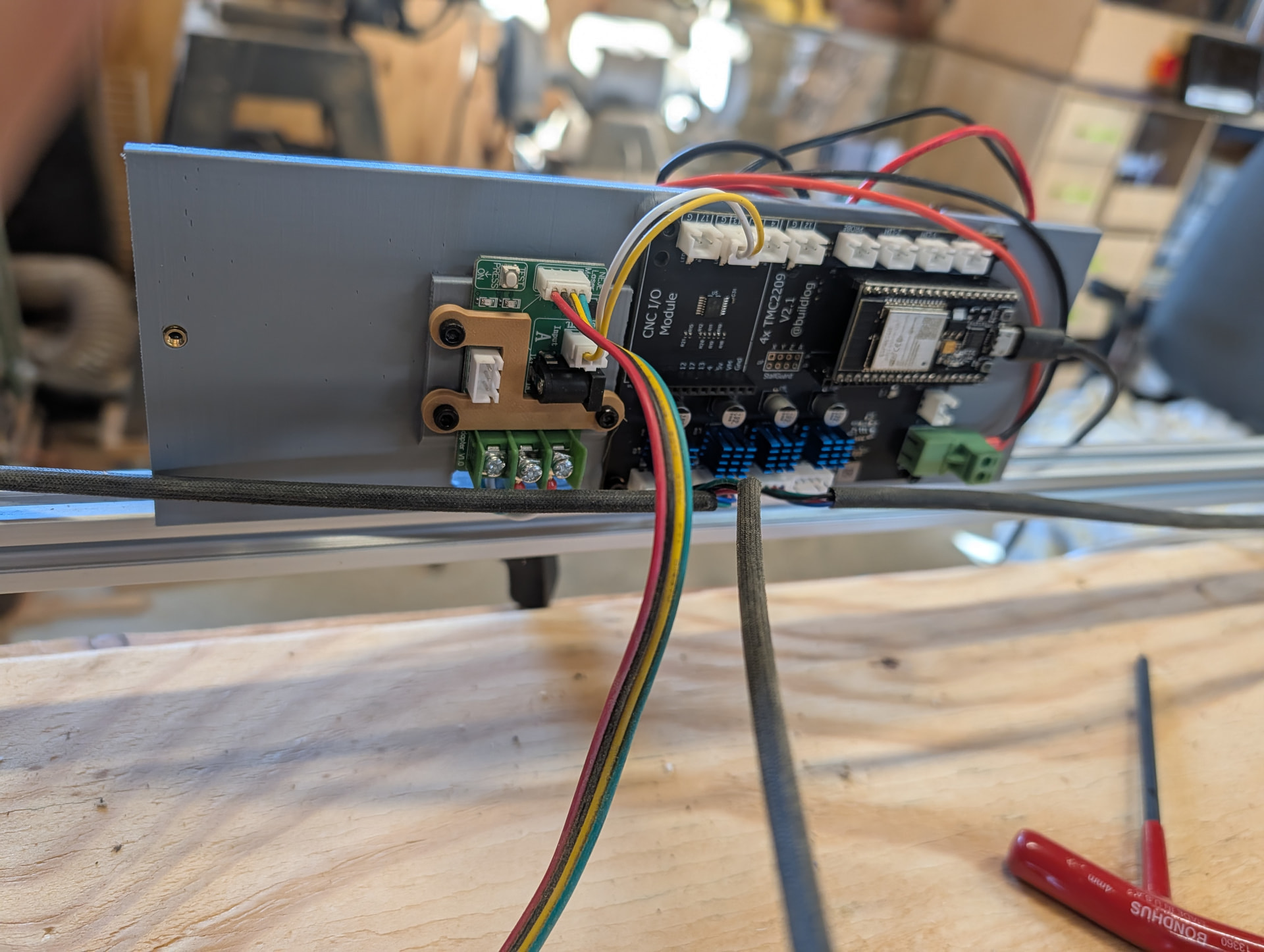

The laser controller doesn’t have mounting holes, so I printed this little plastic clamp that fits around the connectors to hold it down. I’ve tested it out and it works quite well.
Controller side (no, I didn’t completely build out the board’s components in FreeCAD)
And Power/Solenoid side. The green rectangle is the relay board, the silver rectangle is where the 24v/12v Terminal Blocks will be mounted. The black box is the 24v12v converter. And the grey rectangle is a bad representation of the solenoid.
This is a 5 hour print, so it will have to wait until Sunday at the earliest. I have stuff going on the next 2 days, so no rush.
Got the new mount printed. Ignore the cracked plastic. I thought I needed M3 bolts for the solenoid and it’s M4. I’m sure I’ll reprint it one day.
I still need to lengthen the Z stepper wire and wire up the solenoid. The I’ll try to add on the biqu microprobe for setting the Z height.

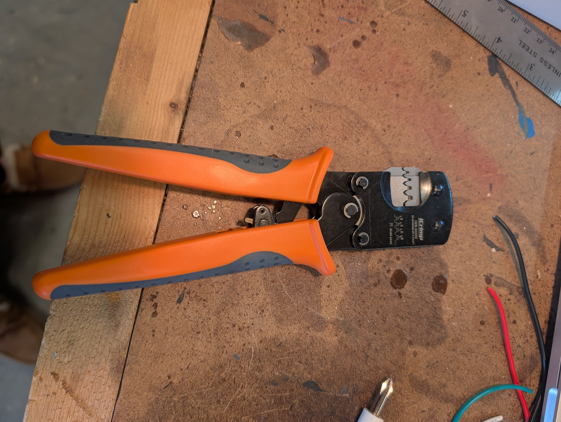

In other news, I finally found perfect crimpers for the JST XT connectors.
Almost forgot a picture of the Z axis.
That’s the ones I use. Not the cheapest by any means, but they are the only ones I can get good crimps consistently with.
Worth every penny. I threw out two other crimper I had bought in the past that never worked well.
I’m down to 3 crimpers.
Got the air solenoid wired up and tested this morning before work. It clicks on/off with the M8/M9 commands for ‘flood’ coolant.
I’m going to have to wire up a little board to make the wiring cleaner for the flood coolant and the touch probe. I’ll test the touch probe this evening before making the board.
