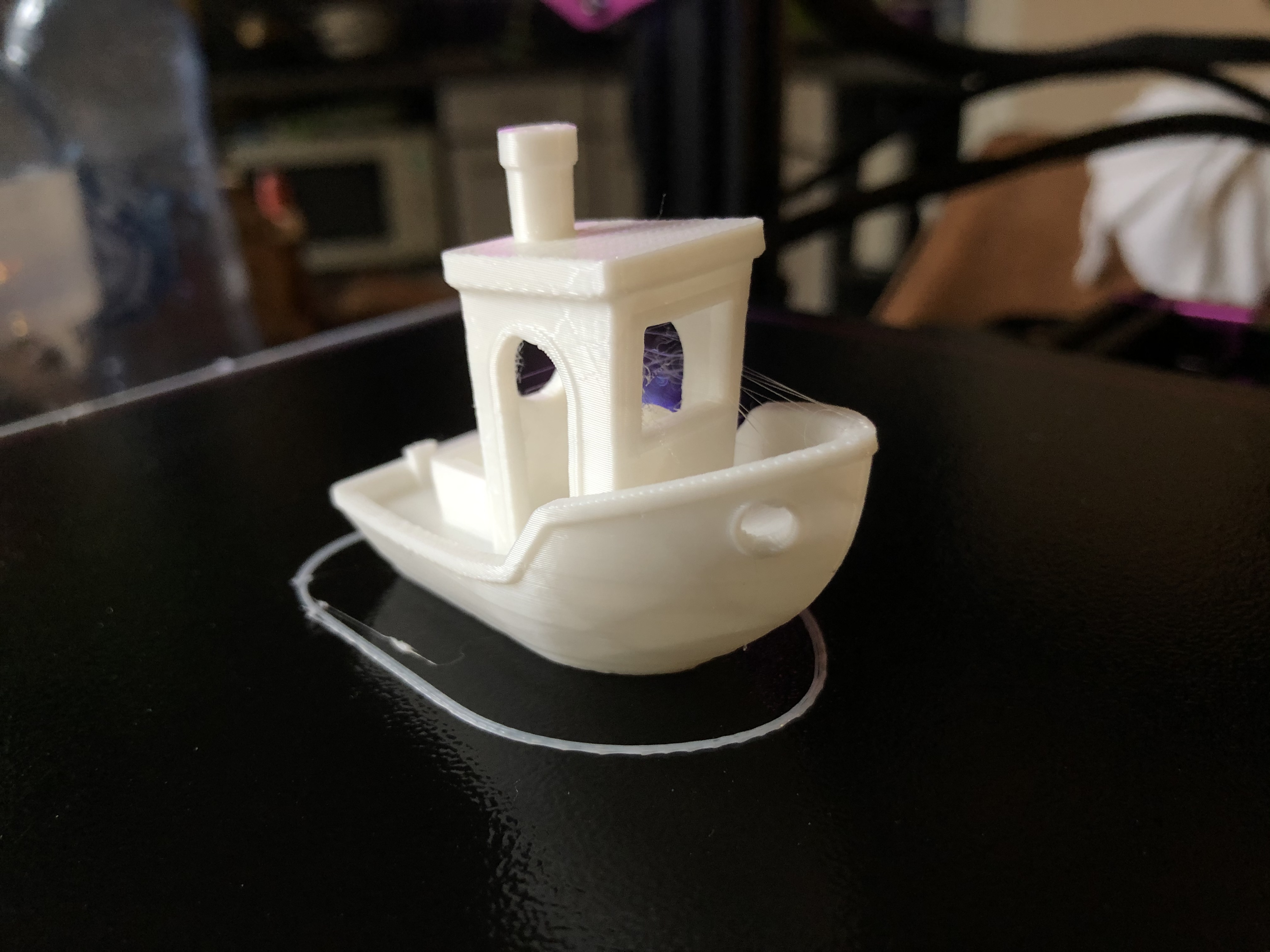

My second 3D print!
It’s ‘Benchy,’ printed from my Pi… works great!
Layer height: 0.2
Wall thickness: 0.4
Top/bottom thickness: 0.7
Top bottom layers: 4
Infill 10%
Temp: 180 degrees
Speed: 50mm/s
I do see some small webs, but happy with it.
small webs are probably either retraction settings or temp (your printing pretty low at 180)
but it looks pretty good, the most important thing is that your happy with it :slight_smile:
Thanks, I guess I’ll have to try a higher temp.
I’ll do the temp ladder to see what’s the best temp…
I find most pla prints best at 195-210 on my ender 3… but a temp tower is the best way to find out.

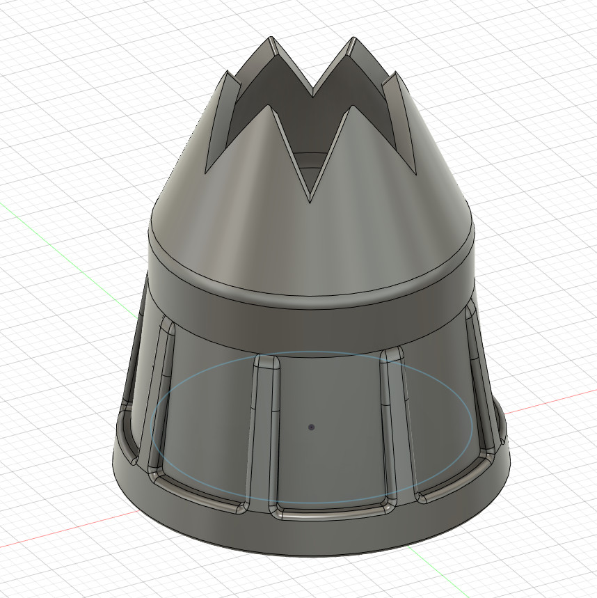

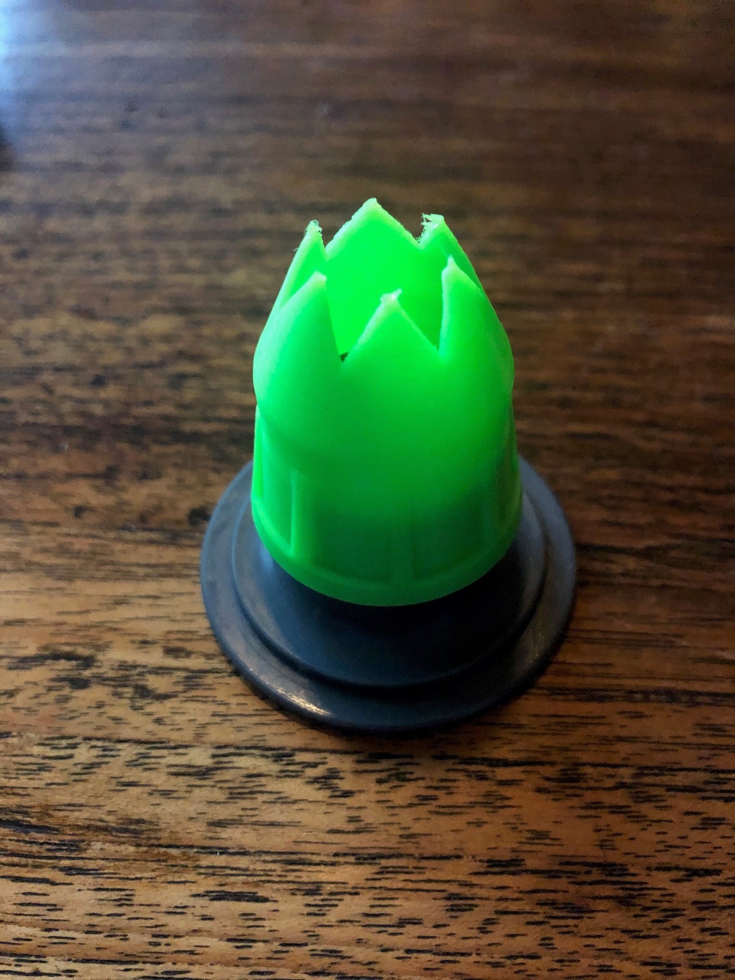

Besides some test prints I just printed my own design. Something for my wife, whipped cream spout.
The originals didn’t have a wide enough mouth…

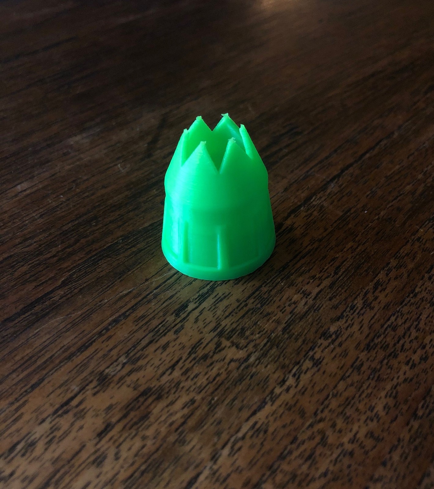

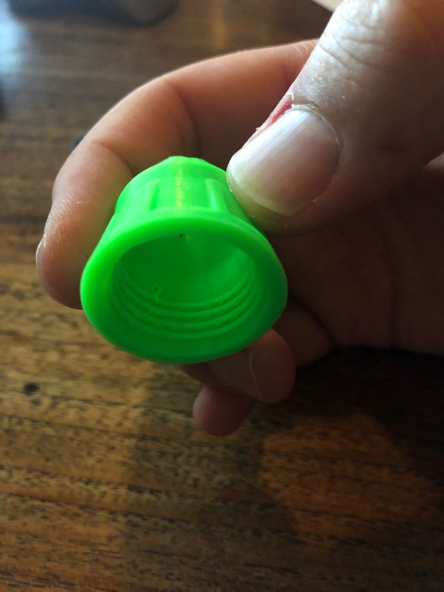

My first print with the Sunlu PLA.
It came out pretty good, only the thread is not the best but it works.
I don’t know if the PLA is suitable for food, but this use is for some body cream.

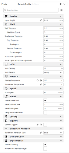

I can’t get rid of the webbing… it’s not the biggest problem, but would be nice to print without.
Pla is not food safe, some petg is food safe. Also the webbing is likely caused by retraction setting ot temp. I would be happy to help if you post your settings :slight_smile:

I’ve tried several settings, none worked for the webbing.

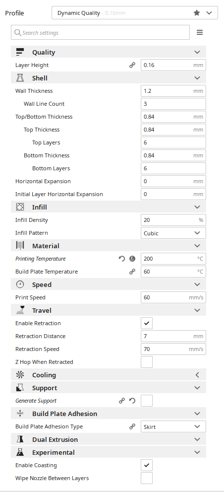

Here are my Cura settings I tried the last print:
You can easily clean that by hitting it quickly with the flame from a lighter. Those little webs disappear instantly.
I know Jeffe, I did it with a heat gun so it’s not the biggest problem :wink:
Try turning your retraction speed down a bit… like 45 or 50 and see if that helps. Other than that your setting look pretty spot on
Thansk Atom, I will try that!

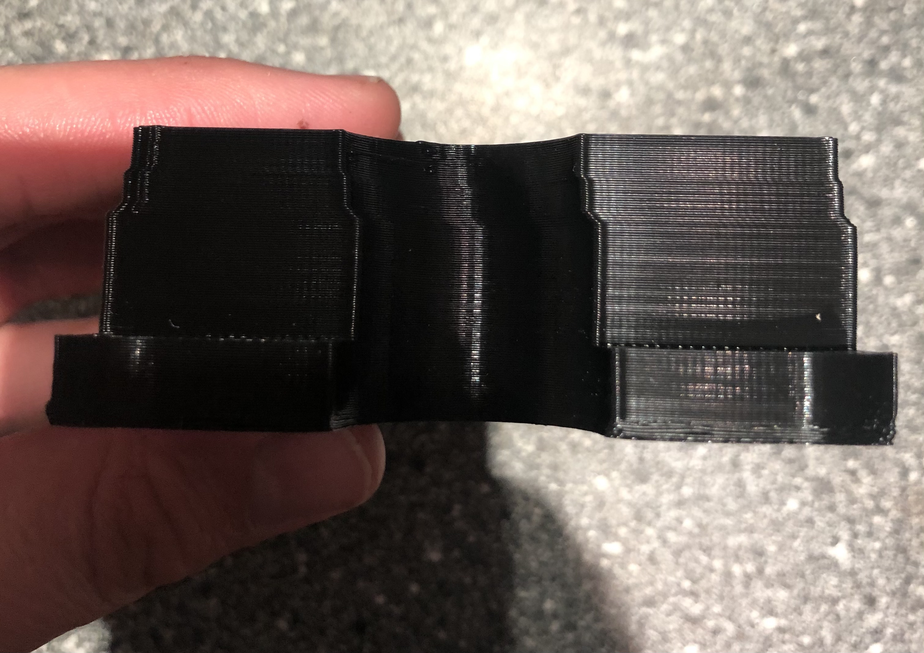

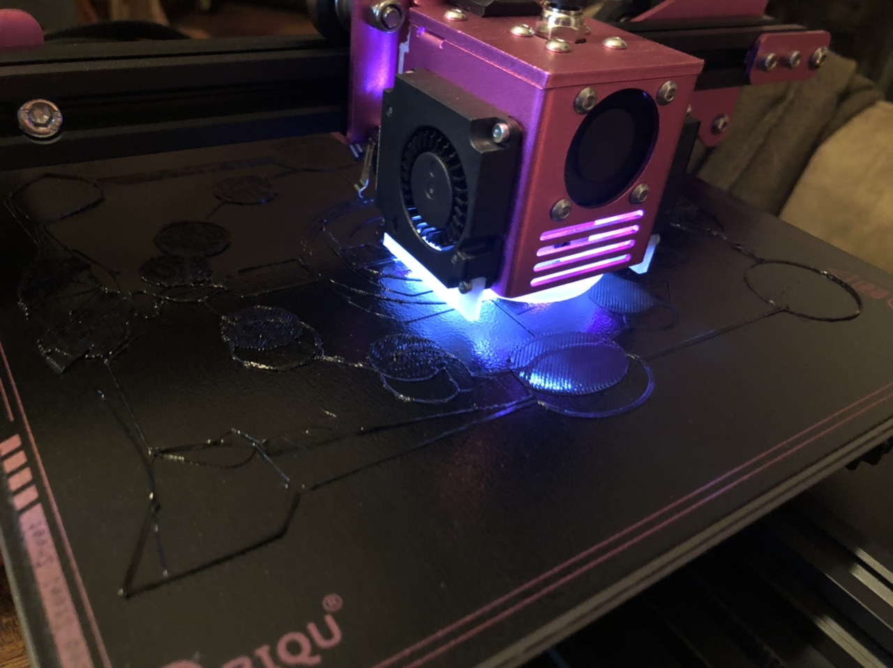

Since today I have a serious problem with my printer. I was printing my first ‘long’ print of about 7h.
After like 5 hours I noticed a big problem… in the Y-axis the print suddenly offset by 2mm and after a few layers again 1mm. I stopped the print… started again and again… same problem. Sometimes it even offsets in the first layers by 8mm or so…It’s only in the Y-axis.
When I turn on the printer, connect with my Pi… I put some tension on the Y-axis by pushing, it seems like the stepper motor releases or something and I can push it like 1cm (not pushing very hard).
This is a photo from the side.
This is a test I’m printing now… even worse:
I also have problems with the first layer not sticking correctly, but that is probably easy to fix…
