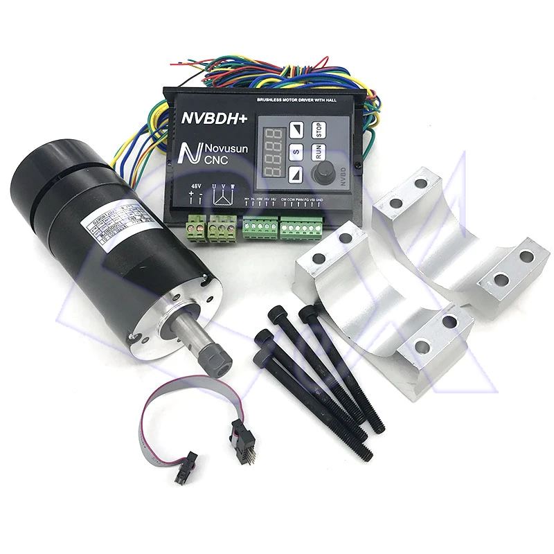

I may try doing a build with this relatively light weight, 48VDC motor, because it will operate at lower RPM’s and does appear to come with a hall effect RPM sensor and DSP PID of some kind:
If anyone has interest, I can post the results.
That is a very interesting motor/driver. The pwm input says it’s 0-5V. It can switch direction. Some too changes require small reverse moves to unscrew the old bits. That would be interesting.
If be interested to see how it goes for you, and what speeds you can get effectively.

The controller in that spindle is not a PID but does have some acceleration control. Hall effect sensors are needed for the brushless spindles to start up going the correct direction, and then can be used for speed detection.
Brushless motors have built in speed control, in that they have to move the current through the motors at a certain speed, not the current based approach DC motors use. So it’s still possible that spindle will have speed control, not just “torque control” for lack of a better word. It depends a little on the software in the box.
I used a large high torque brushless without sensors in another project and it was kinda of a bummer that you needed to give it a bump to get it going and a big enough bump to make sure it went the right way. That is the most promising out of the box solution I have seen yet and looks to be leaps and bounds better than the quiet cut. Add $50 or so for the power supply and it might be a solid solution for under $200 if the quality is there. I need to triple check the specs but I would like to try one.

I wonder why all the high speed spindles are AC rather than DC. I guess a spindle needs higher voltage than 60VDC to get to the >24,000RPM speeds?
I’ve heard that for milling PCB’s, those high RPM’s tend to work better. I found some aliexpress spindles that go up to 60,000RPM, but they’re all AC.
Anyhow, doing a PID for a DC spindle does seem like it would be a little easier than for an AC spindle, so I guess I’ll start with a DC PID. Maybe by then Ryan will be done with the AC PID. :slight_smile:

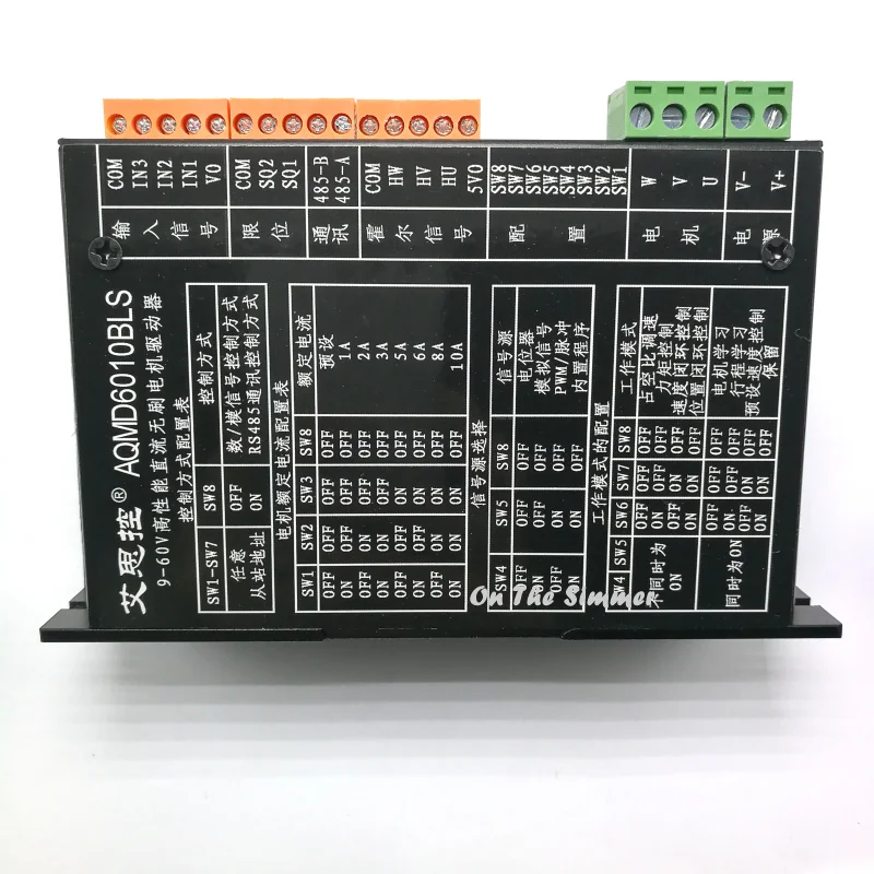

If the motor controller that comes with the DC brushless spindle doesn’t satisfy, then it looks like there are other off-the-shelf solutions that might :
