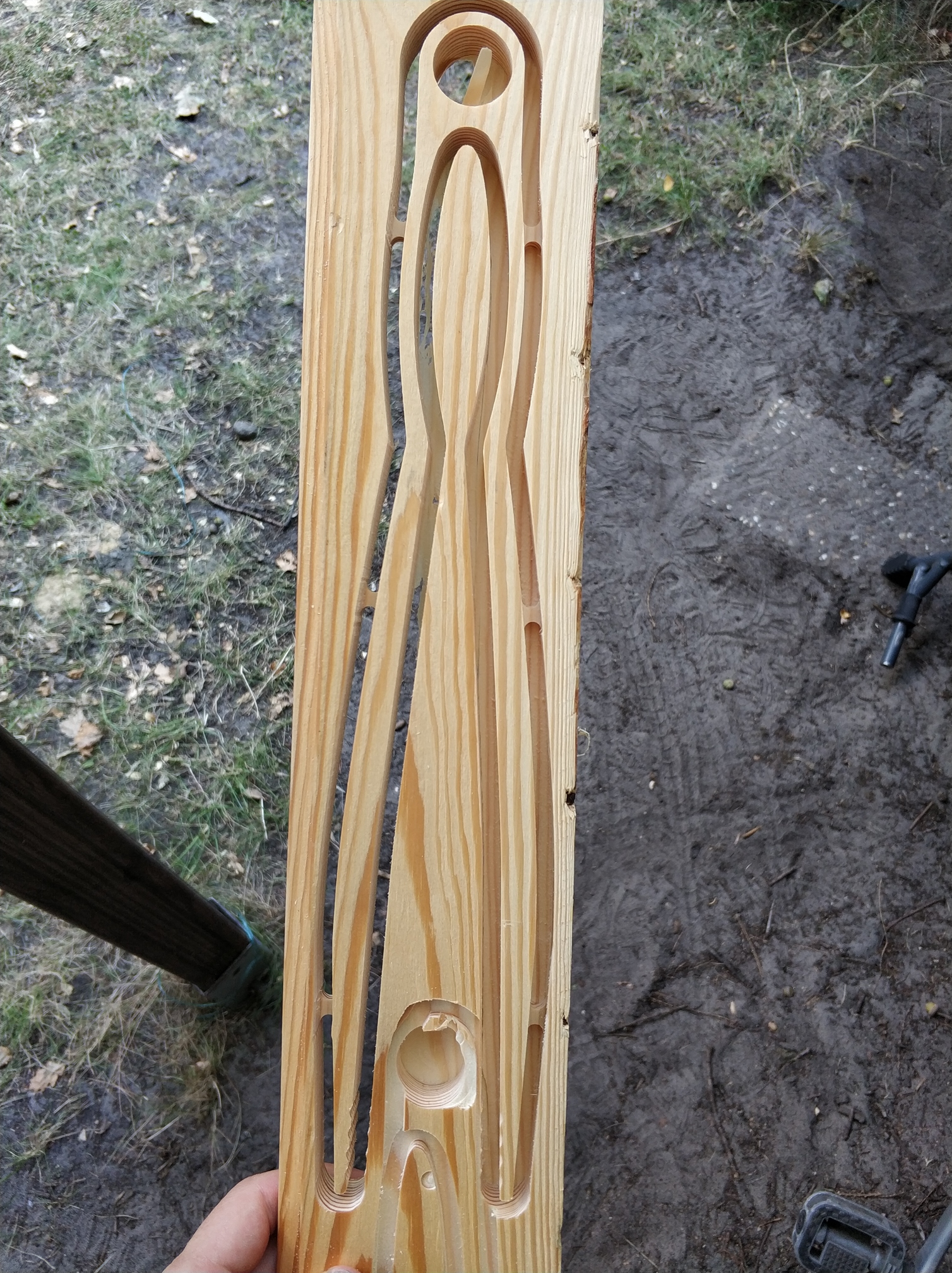

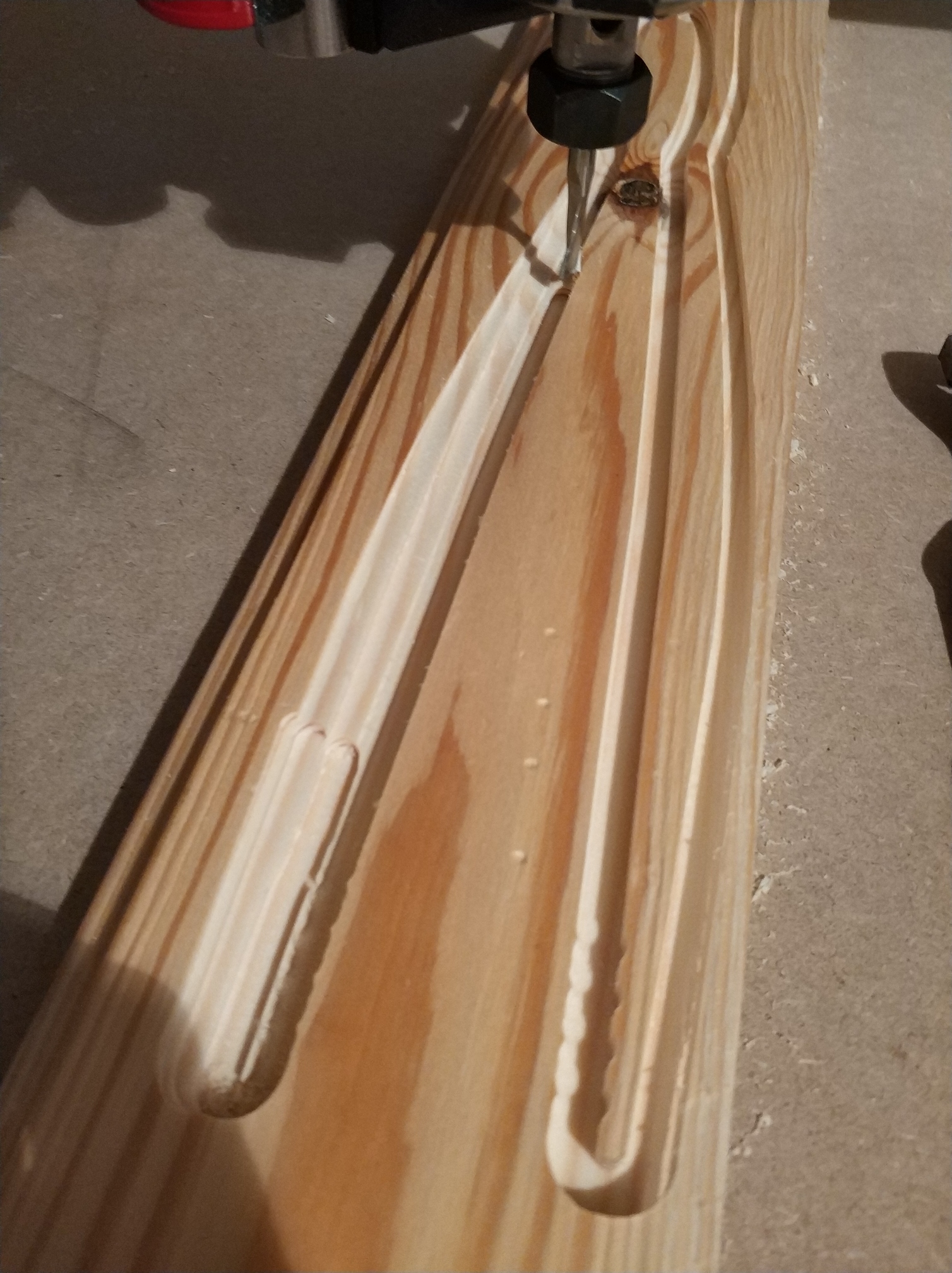

As you can see, the one side of the tongues is completely fine after three passes, whereas the other side is a complete mess with three different paths. Why could that be? Y can’t really be off or skipping steps, then the other side would look as messed up, wouldn’t it? Besides, the crown looked great. I uploaded the dxf and the nc code from Estlcam in a Zip. Grillzange.zip (18.4 KB)

Try cutting you speeds to 1000mm a min from 2000 and see what that does
Thanks, good idea. I found the mistake when trying to quickly move Y though. It was the classic, the only thing in the troubleshooting: One side didn’t move, pulley was loose. Other one came loose shortly after. And I did use loctite… I think my stepper shafts are a little too short, even thought so when installing them.
All better now. :yum:
The classic grub screw :smiley::crazy_face: my favorite and I didn’t use it. Nice tongues
