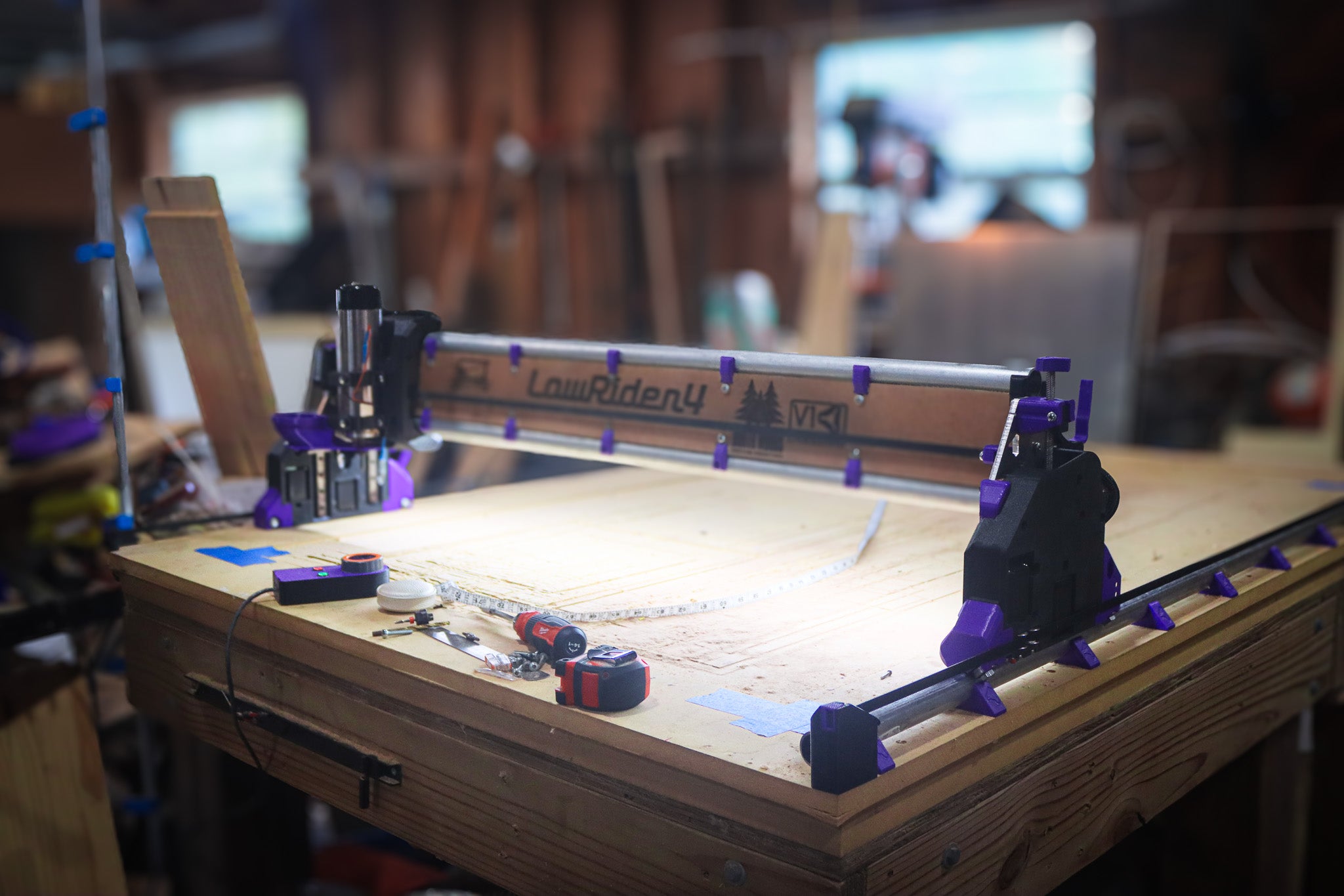

We have a fully built Lowrider V4 Vendor now!

My goal is a fully assembled machine. If I just can’t make it work with the YZ plates attached to the beam then I will remove them. I don’t want to have to charge the customer 2-3 times as much for shipping to keep from taking them off. But I truly hope I can ship with them attached.

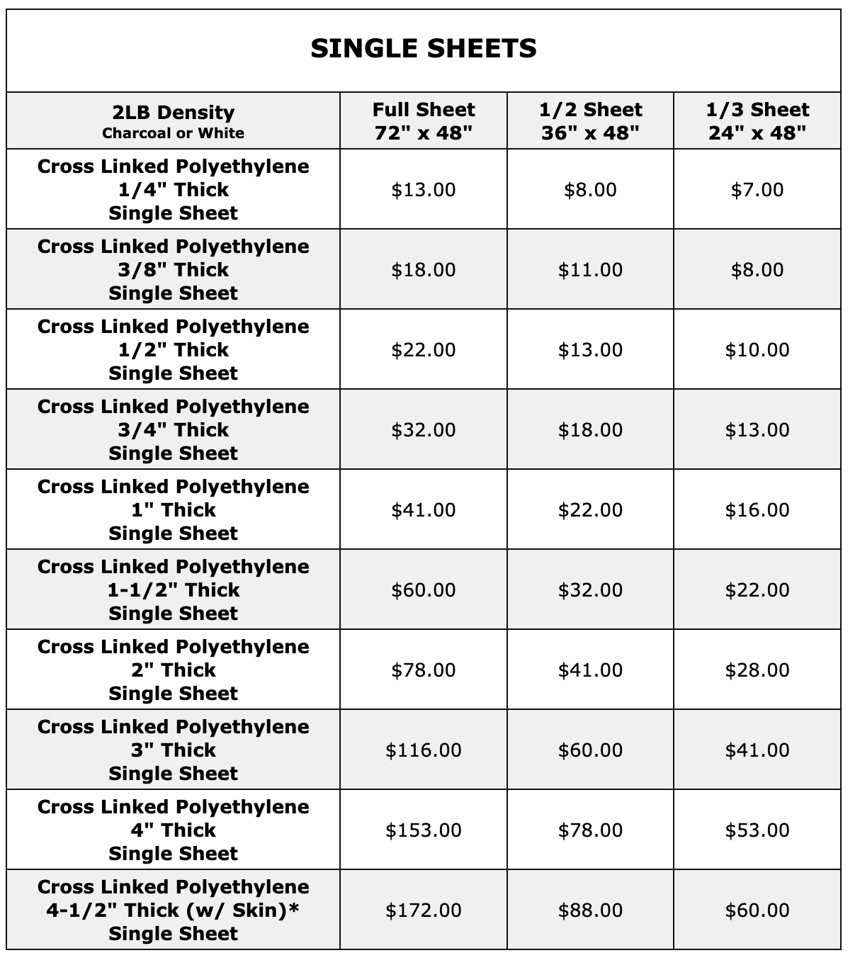

1" 4 foot x 8 foot sheet is $14
https://www.homedepot.com/p/R-Tech-1-in-x-48-in-x-8-ft-R-3-85-Insulating-Sheathing-320821/202532854

I weighed my smaller beta machine and it came in at 19lbs. So I am hoping a 48" after packaging will be 30 or less.

An example below. This is the wrong supplier and these are quoted local pickup- but we should be able in the community to find sutable options for you.
http://www.usafoam.com/closedcellfoam/cross-linked-polyethylene-foam.html
One sheet of this sounds pricy, but if you assume an end cap, a cutout for the YZ plates, and a couple of cutouts for mid-span you would get on the order of 4-8 packing sets out of one sheet. Looking at it that way, it doesn’t sound too terrible to me. The 1" thick sheet is $48, so on the order of $10 per gantry in foam.
As noted above, you could also manually knife cut this.
Or, crazy idea even needle cut it like the threads @dkj4linux has on the forum.
Polyethelene and crosslinked polyethelene should be laser cuttable without too much hasle and without any bad toxicity (would still want to read an MSDS of anything you might use.)
