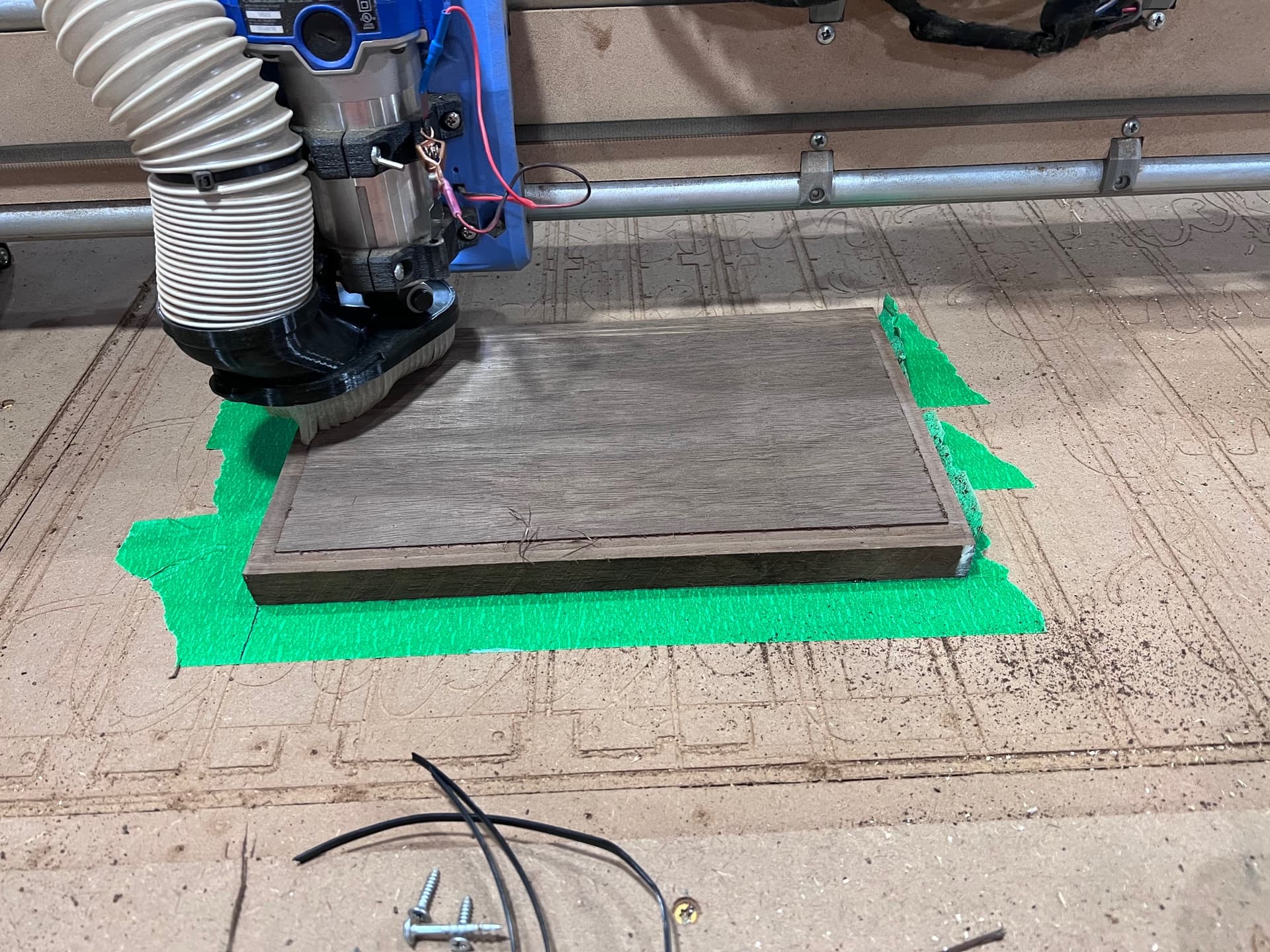

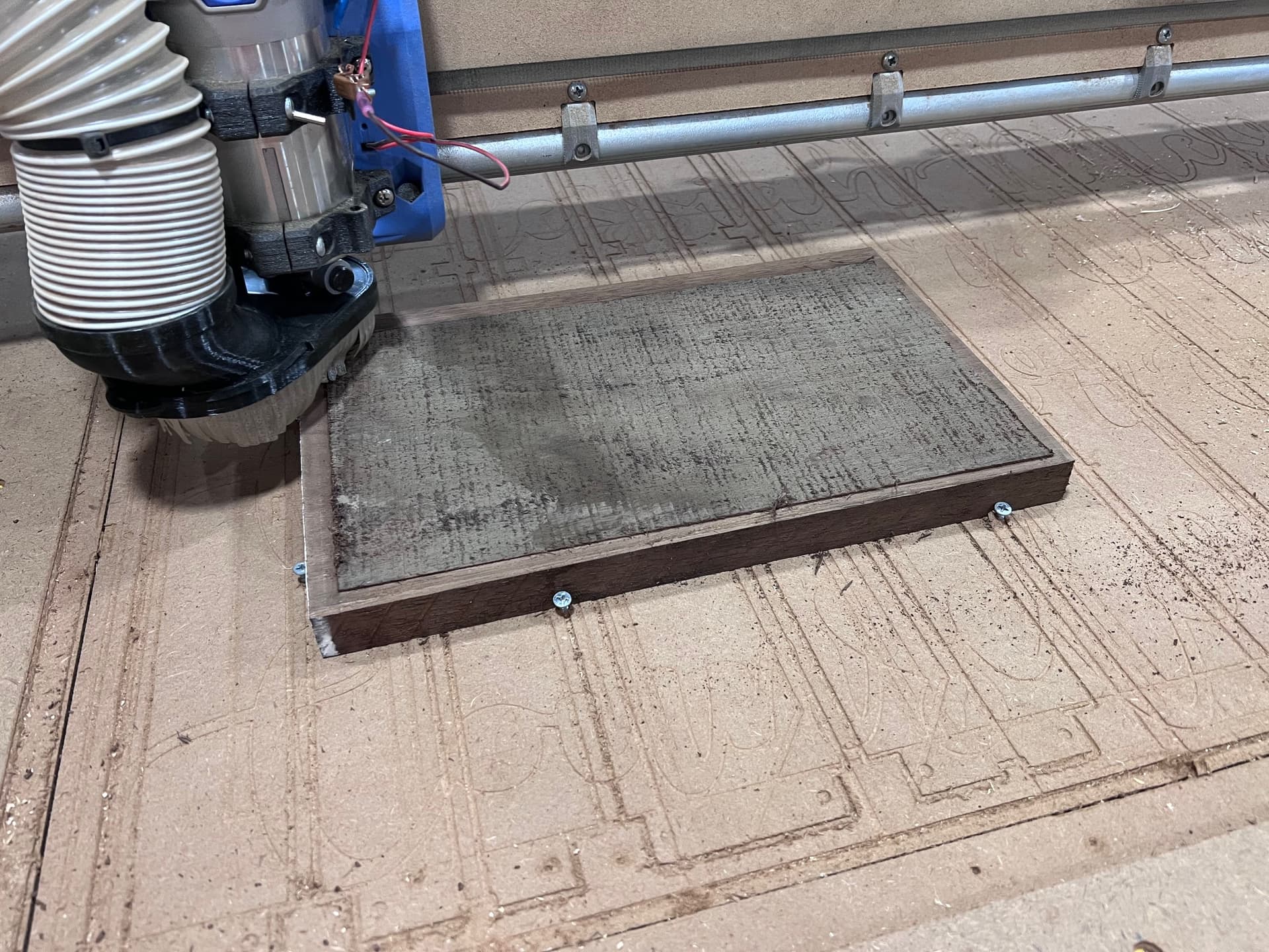

Started with surfacing down the front flat…

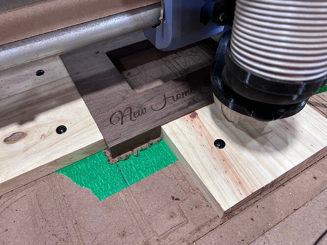

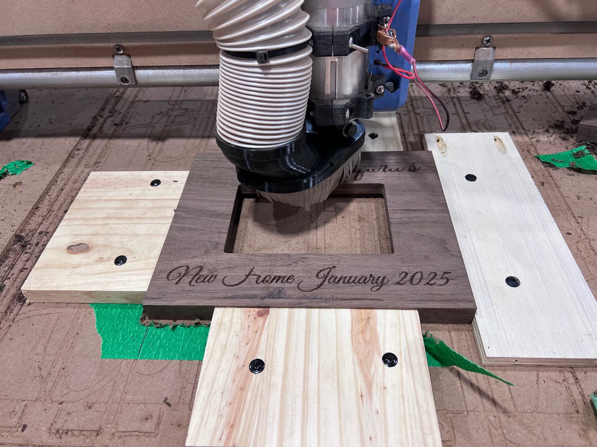

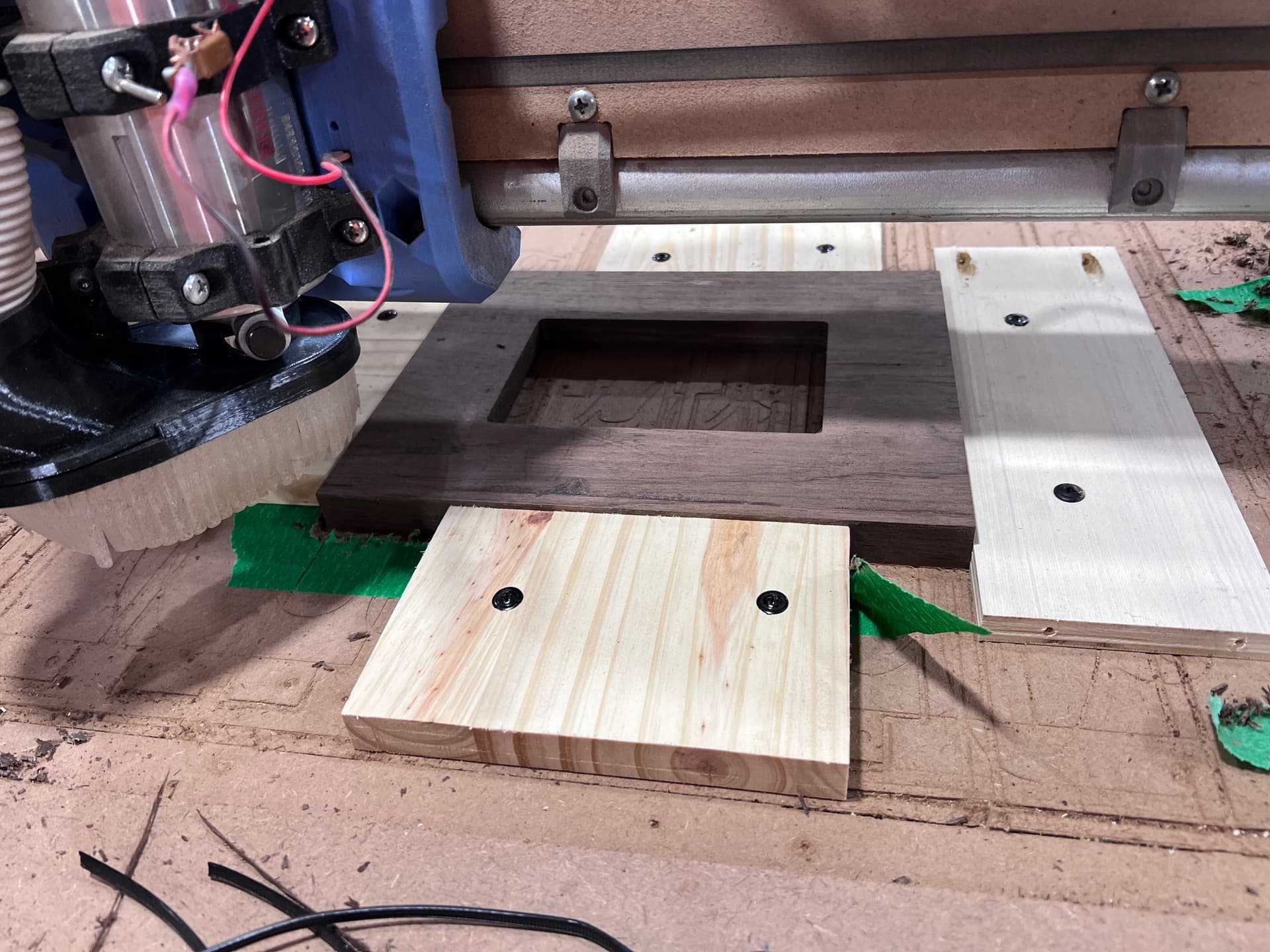

Then flipped it over and used the tape and CA glue method to hold it down, surfaced the back side and did the outside cut and the cut out for the picture/glass.

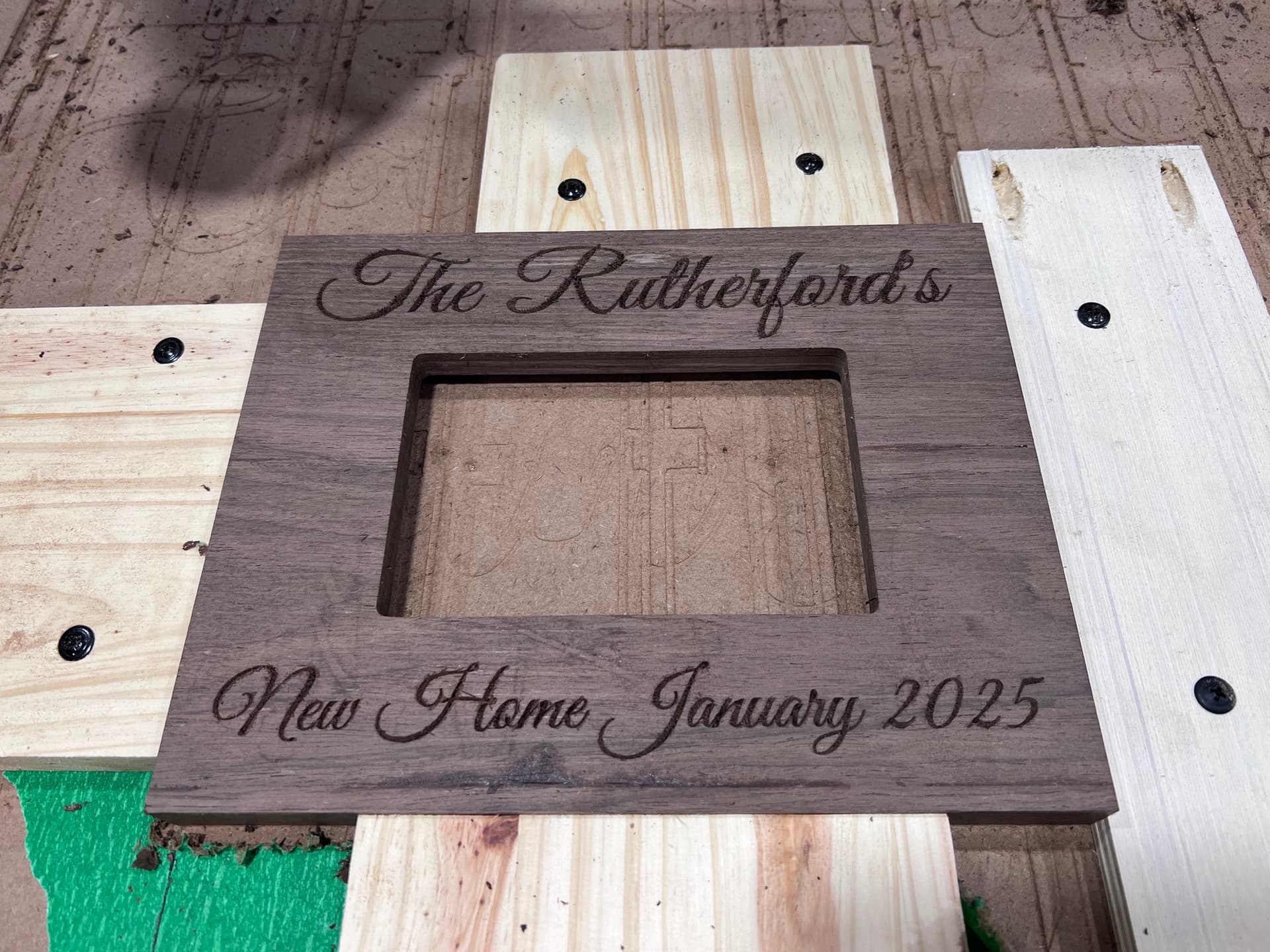

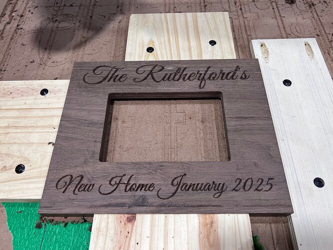

Forgot to get a pic before I flipped it over. But before I moved it, I took some scrap wood and screwed it down so I could get it right back in line where I needed it. Then used 2 more to sandwich it in place and that held it real well for the V carve.

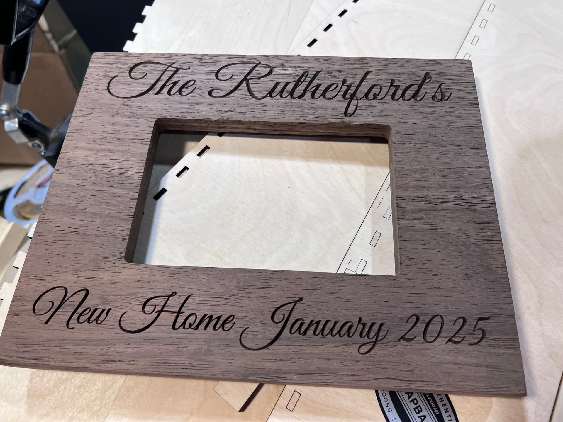

After taking if off the table and doing a little sanding and brush work on the carve…
And after a coat of satin polyurethane.

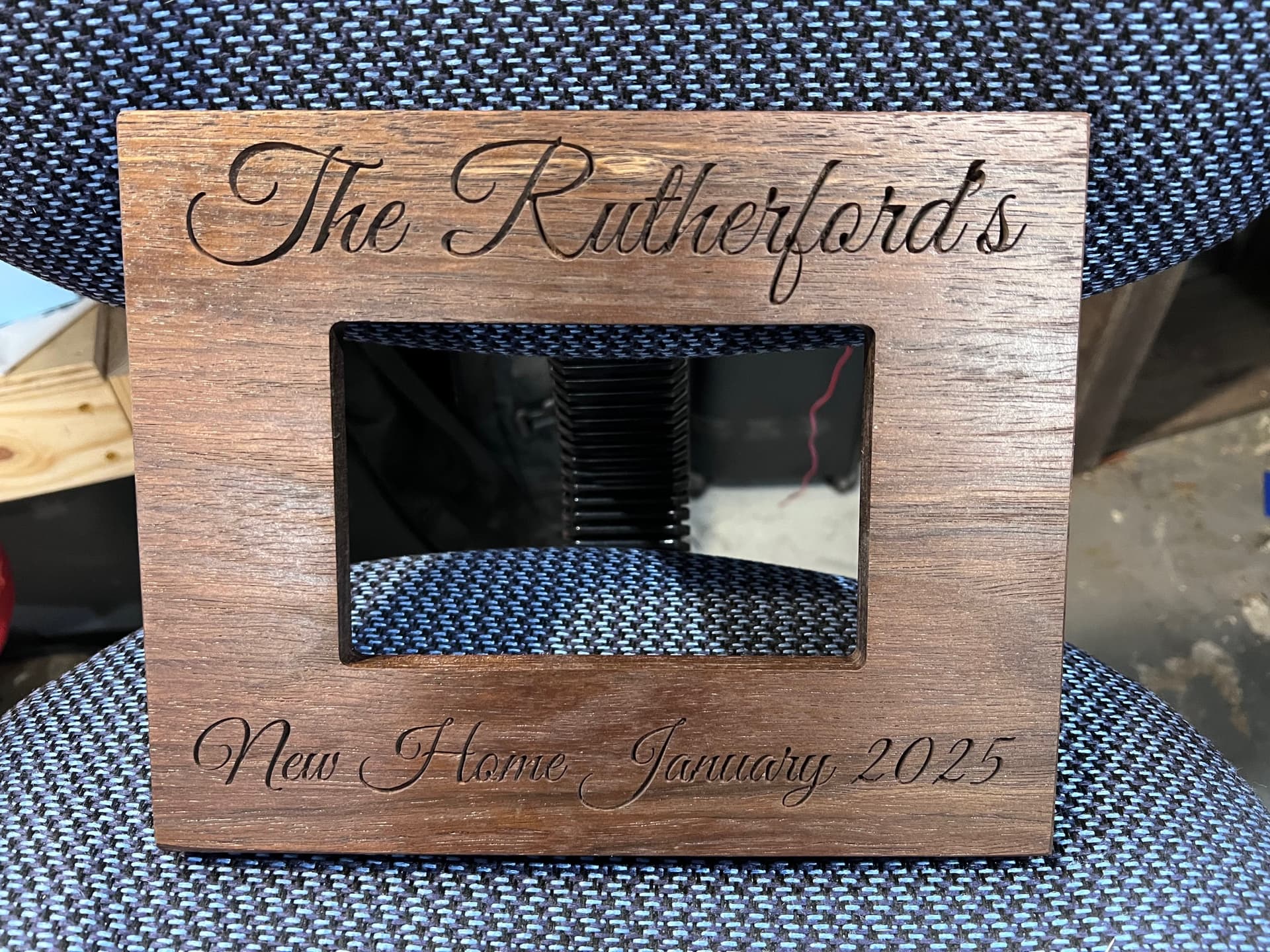

I forgot to take pics of it with the glass and all in it. Really need to do better about taking finished pics lol. But I ended up ordering some glass from Amazon for it, and cut out a backer from 1/4 birch plywood. Then 3d printed 2 tabs to turn and lock the backer in place. Also bought some desk picture mounts (or whatever you would call that) from amazon to screw on the back. They loved it and the people they gave it to loved it as well.

Forgot to add…
This is the bit I used for the Vcarve. First time I have ever seen one like this and it did really well in the walnut!
https://a.co/d/8uEJ4fL
Ah, 30 degrees that makes sense.
Ohh i almost bought that for my last sign i did. Accidentally bought a 45 and it did great too!
I liked it so much I have it in 45° and 60° now too lol. It did better than the more expensive Whiteside bits I thought. Hopefully they last a while. I don’t do a ton of Vcarve work so should get a few years out of them at least lol.

I often feel that 30° only makes sense for fonts like the one you have there, in all other cases I prefer the 60°.
I agree for anything with wider text I would have gone with the 45° or 60°
