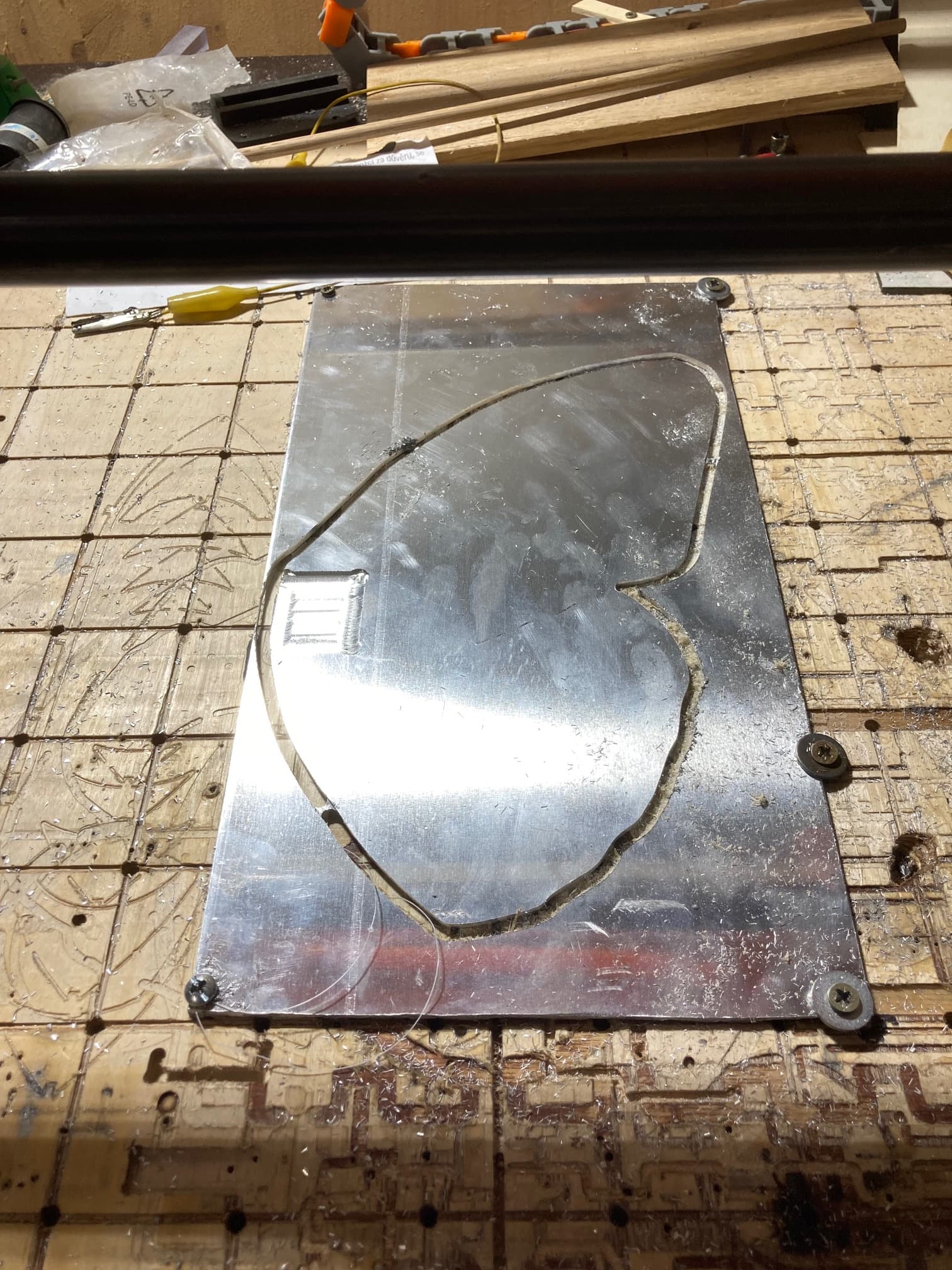

We decided to make little bit better ( and now MPCNC came to game) from 2 parts of glued 3mm alumunium on hinge (pocket inside ) .
At begginng, I bought alluminium ( 1050A ) and during processing, I found that it was bad choose for CNC processing, but after some time I found sufficient setup, which was :
2Flute 3.175 bit ( single flute was more generating more vibrations during plunge in )
First test of mount
Then, each part ( from 12) took little bit more about 1hour on machine, hinge was glued in by epoxy, then both parts together, added headless 3mm screws to make it secure. I created also 2mm slots for hinges into panel itself and mounted it on.
Pictures was printed on sticker foil and applied on final product.
This friday we installed back to panel outdoor, lets see how long it will last. It’s installed on freqquent place, so stress load is already started.
