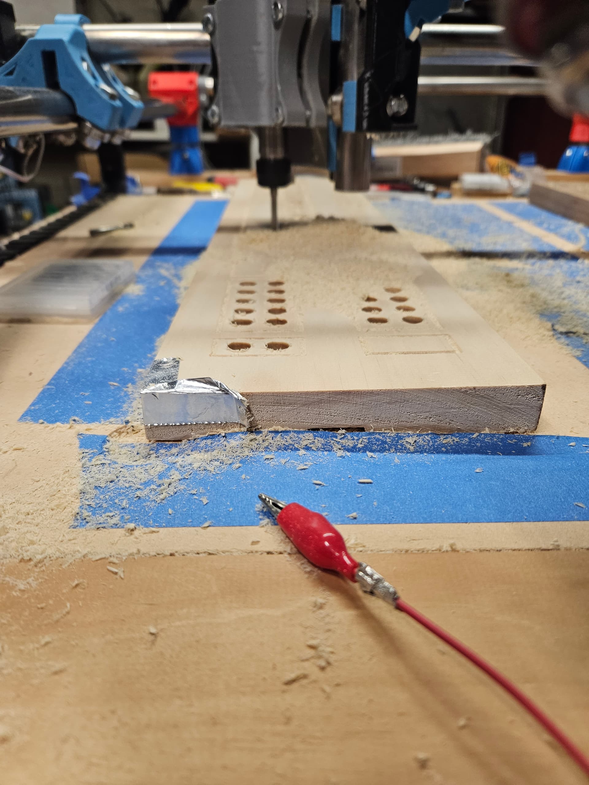

I went the oter way and use aluminum tape and a lalagator clip on it that i disconnect! And leave the tape in place it wont move and can be a reference point kater on for mill changes
Can you share a picture of that setup?
Aluminum tape? That looks like a gum wrapper…
Ha, that was the first thing I thought I saw as well, had to remind myself what he said in his post to have the brain recalibrate to see tape.
Glad I wasn’t the only one craving a piece of gum (without knowing it) when looking at the photo.
Got me craving double mint or juicy fruit. :blush:

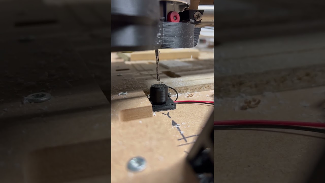

I’m testing this idea, I’m thinking about to use this touch plate with a macro, and work always using Spoilboard as reference. This will keep tool changes easier. The touchplate will use G53 coordinates.
The internal mechanism is made with two magnets repelling each other… more tests will follow.
I also added a relay for the router that works with M3/M5 codes, and a physical button that will run the ā€œprobe macroā€.
