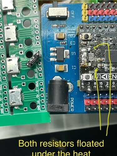

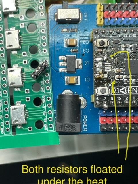

Came very close to replacing the micro USB However, in the process of using a heat gun i managed to loose one of the tiny surface mount resistors ( i.e.: a contribution of my poor soldering skill set and miniaturization.) When I return to the house I’ll collect some pixs. for the purpose of providing addl. info for anyone else attempting something similar.
Onward to attempting to draw my 1st ‘crown’ on my MPCNC primo (sans a pendant for now.)
Removed a new connector to replace the origional. The resistors floated and flew away …somewhere.??? I will have to retire this device :wink: Now waiting for my replacement to arrive.

To a determined repairer that would still be savable, but would need a new connector, and new replacement SMT parts to replace the missing ones.
Some questions and observations about your attempt.
First, what was your plan/approach for attempting repair?
What I think I see- it looks like you used a hot air reflow and tried to remove the USB connector with it.
It doesn’t look like you made a foil shield or any other attempt at air/temp management outside of the footprint of the USB connector.
The floated small SMT parts, scorching, and damaged pushbutton are all predictable with that approach.
It also looks like you planned to pull a connector from the breakout boards and try to install that onto the ESP32. That’s not a good approach.
What you might have done:
The USB connector has a large solder area on the sides which don’t just serve to ground the shell, they mechanically secure the connector to try and prevent damage from insertion/removal of USB cables.
A possibly better approach would have been to use a fine point side cutter or a cutting tool (scalpel, hobby knife) to cut the leads of the connector towards the outside of the connector. That would have left the leads still soldered to the board, but after the rest of the connector was removed those would be easy to remove.
The solder on the sides is probably better removed with a medium sized chisel flat tip, heating the solder to get it to flow and then lifting one side and/or wicking the solder out.
Repeat on the other side, and walk the connector off.
Alternately, a larger pair of solder tweezers could handle that in a very straightforward way.
At that point, you could use the chisel tip and some flux to heat up, remove, and eventually tin the flat pads on the footprint of the connector that would remain.
Next, a new (not a removed) connector could be soldered in place, and cleaned up afterwards with a find brush and some isopropol alcohol.
That ESP32 is probably still viable for repair, but as you note it’s more a curiosity or hobby thing at this point.
Thank you for your observations -which were very much to the point! The components that floated away were SMT diodes used to protect against static and could likely be disregarded. I intend to continue the type of repair as my skills and knowledge increase. Thanks again for you suggestions.
