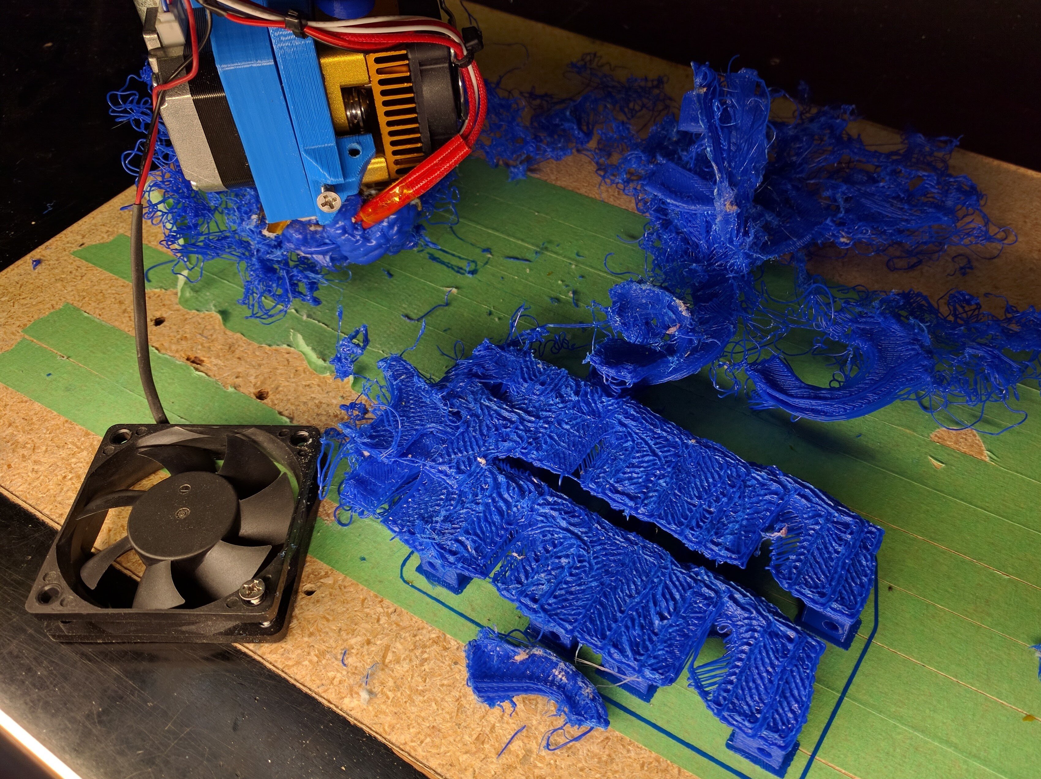

I can’t wait to try these. Bottom parts are printed. I’ve had two failures printing the top parts. The first attempt, a wire broke on my Y-axis. The second attempt, a wire broke on my Z-axis! It’s crazy, since I’ve had hours and hours of machine time with zero failures until trying to print these top corner parts, which are apparently cursed on my machine.
The second attempt was a more spectacular failure. Pictures attached for fun.
I just got everything cleaned up and am going for attempt #3.

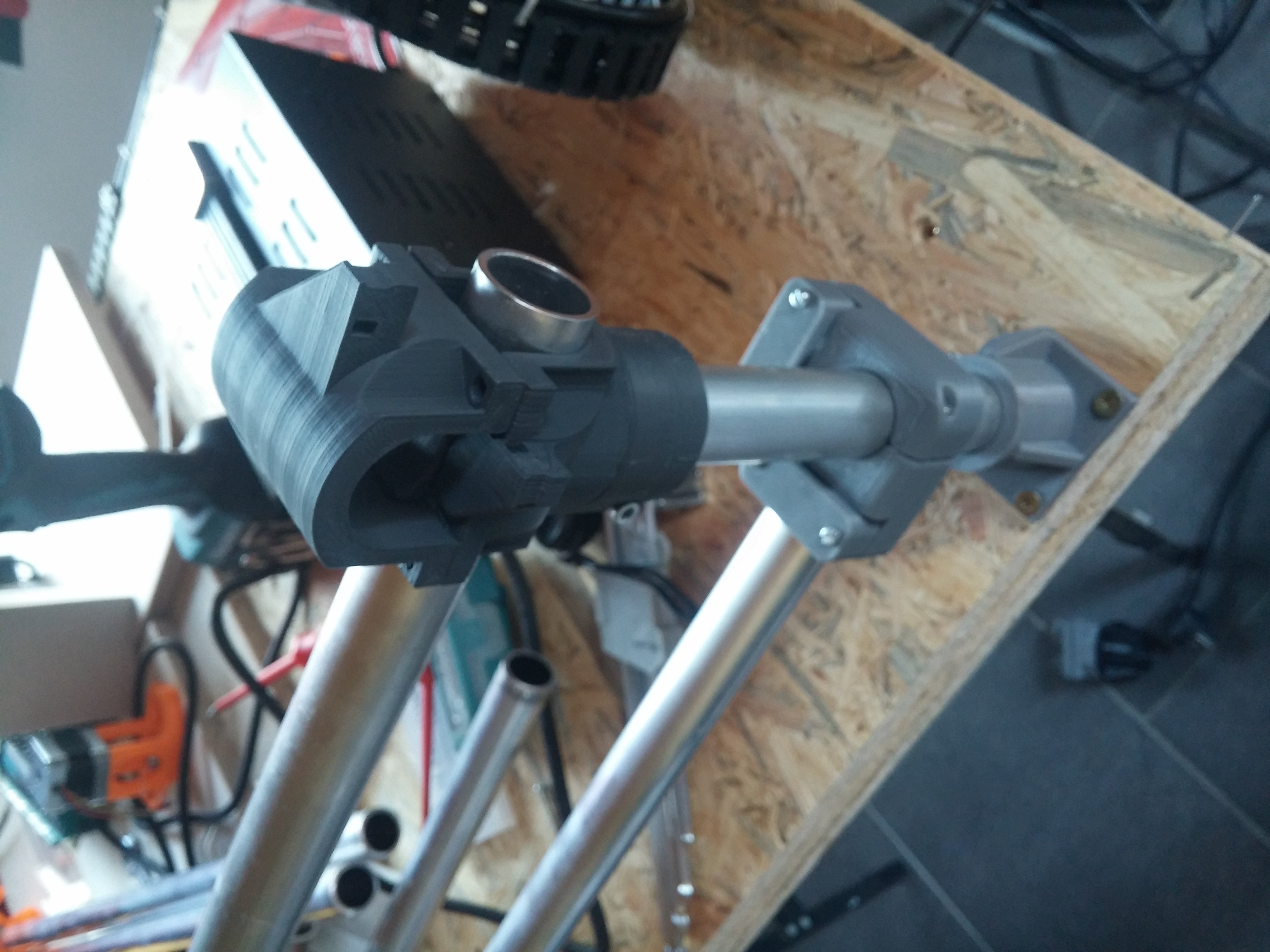

Because my legs are a bit high the whole machine was very unstable, so I decided to build in a few more pipes. What do you think of this design? Should give some strenght in my opinion.
Edit: The new corner blocks seem to be a bit shorter, don’t they? The end of the pipe is now a bit over the edge of the corner… Did I something wrong?
The parts are smaller in one direction and slightly larger in the other. you didn’t do anything wrong, you can leave it or move your leg out 3mm tha take advantage of the larger axis.
