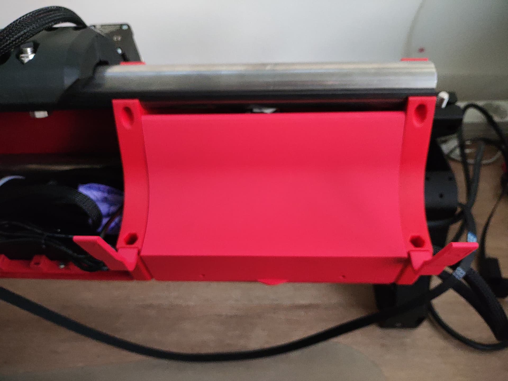

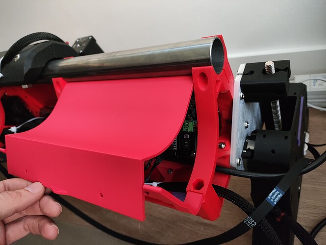

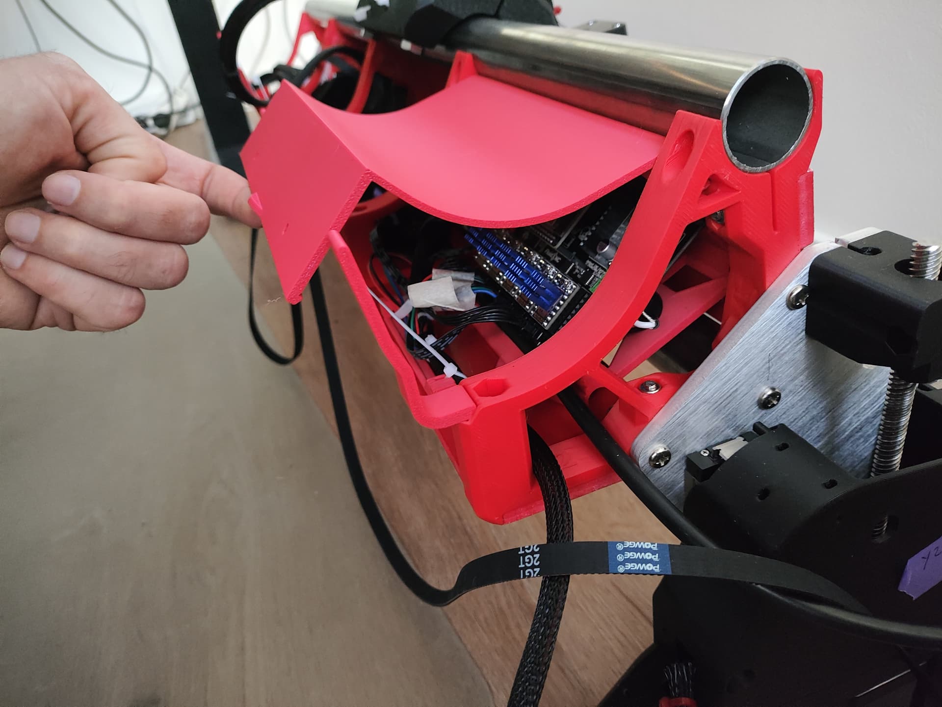

Hi @DougJoseph,
I’m in the process of making the back covers but I’m running against a little problem. The back cover that I have printed won’t fully open.
I don’t know if it matters but i’m using 32 mm rails.
Here are some pics:
They way I am holding it, is the max that it will open. If I press harder, the cover will jump out of the nuts.
Any idea what I am doing wrong?
I’m so sorry, but they were designed for 29.5mm OD (EMT). They probably would need remixed for 32mm rails. If you are not up for a remix I can try to add this to my radar.
Oh please! I dont have yet the skills to do that myself.
Thanks for the rapid response
Somewhere I have a set for 32mm rails that fully opens. The trick is rounding that top corner more. I decided though that I don’t like them very much.
