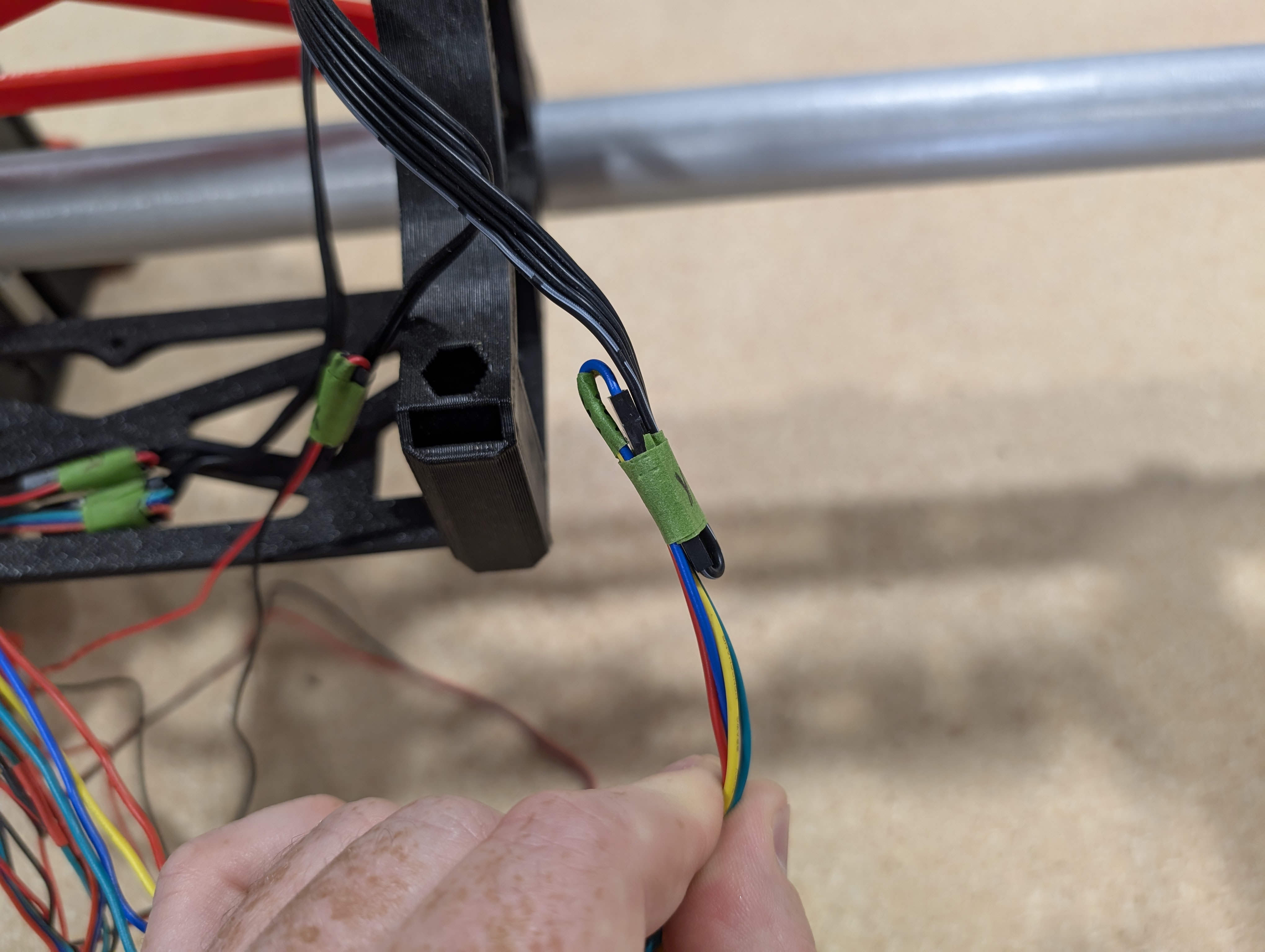

Did you tape your’s together like it shows in the Docs? Once I started doing this, I never had a problem with them again.

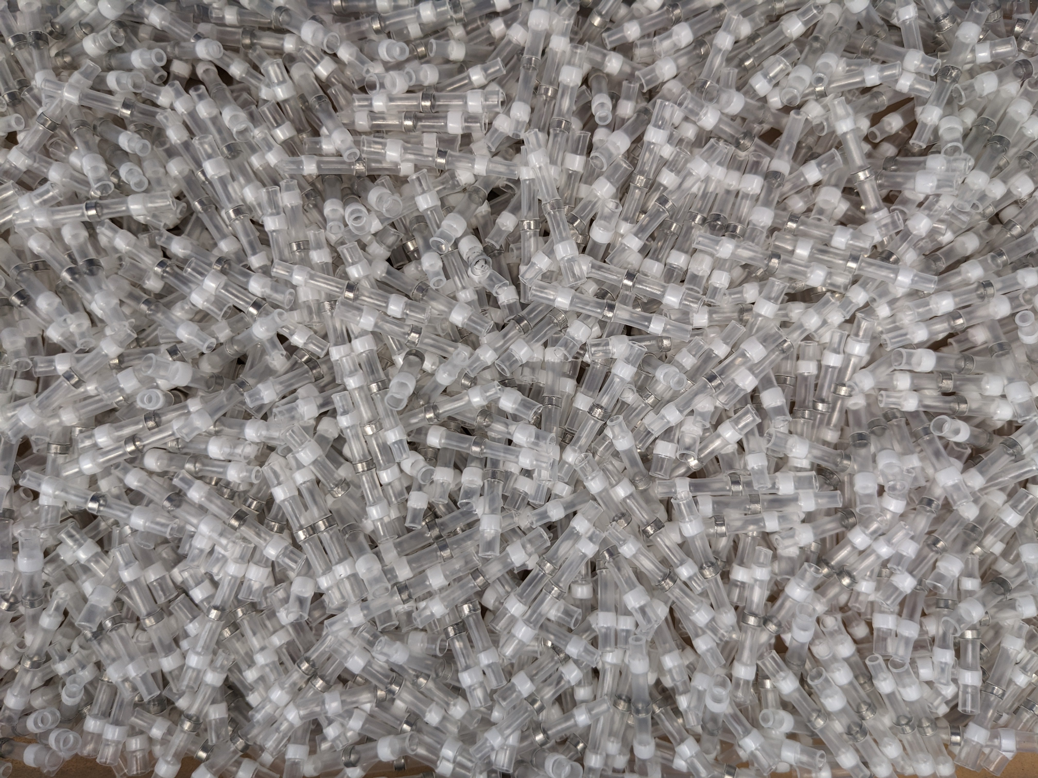

Do it in one shot with heat shrink solder seal butt connectors.

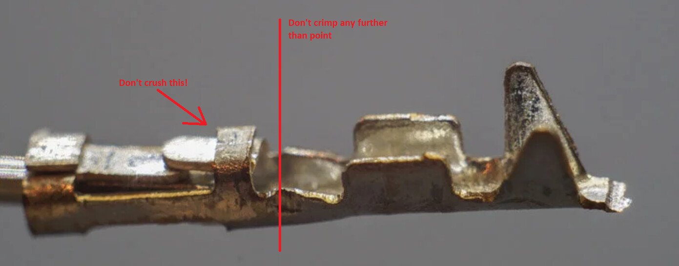

You want the ‘original’ Dupont crimp pins: Amphenol Mini-PV series. These use a two piece design with a beryllium copper spring and are far superior to the crappy single piece design used in all hobby grade/Amazon supplied connector kits. They cost a little more and take some digging through the product data sheets to select the correct part numbers that you will require but it’s worth the effort. Available through Digikey, Mouser and other electronic suppliers.
