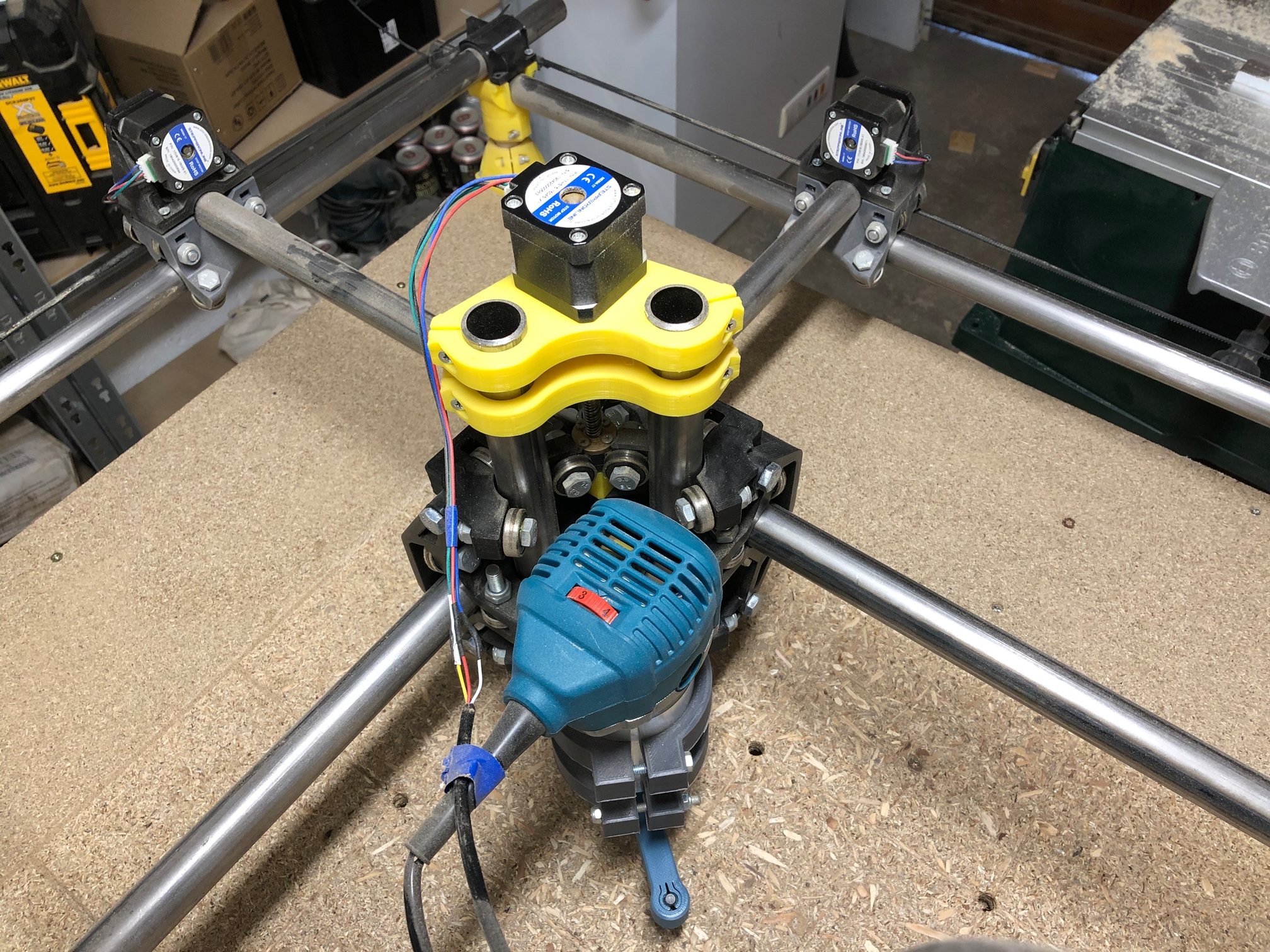

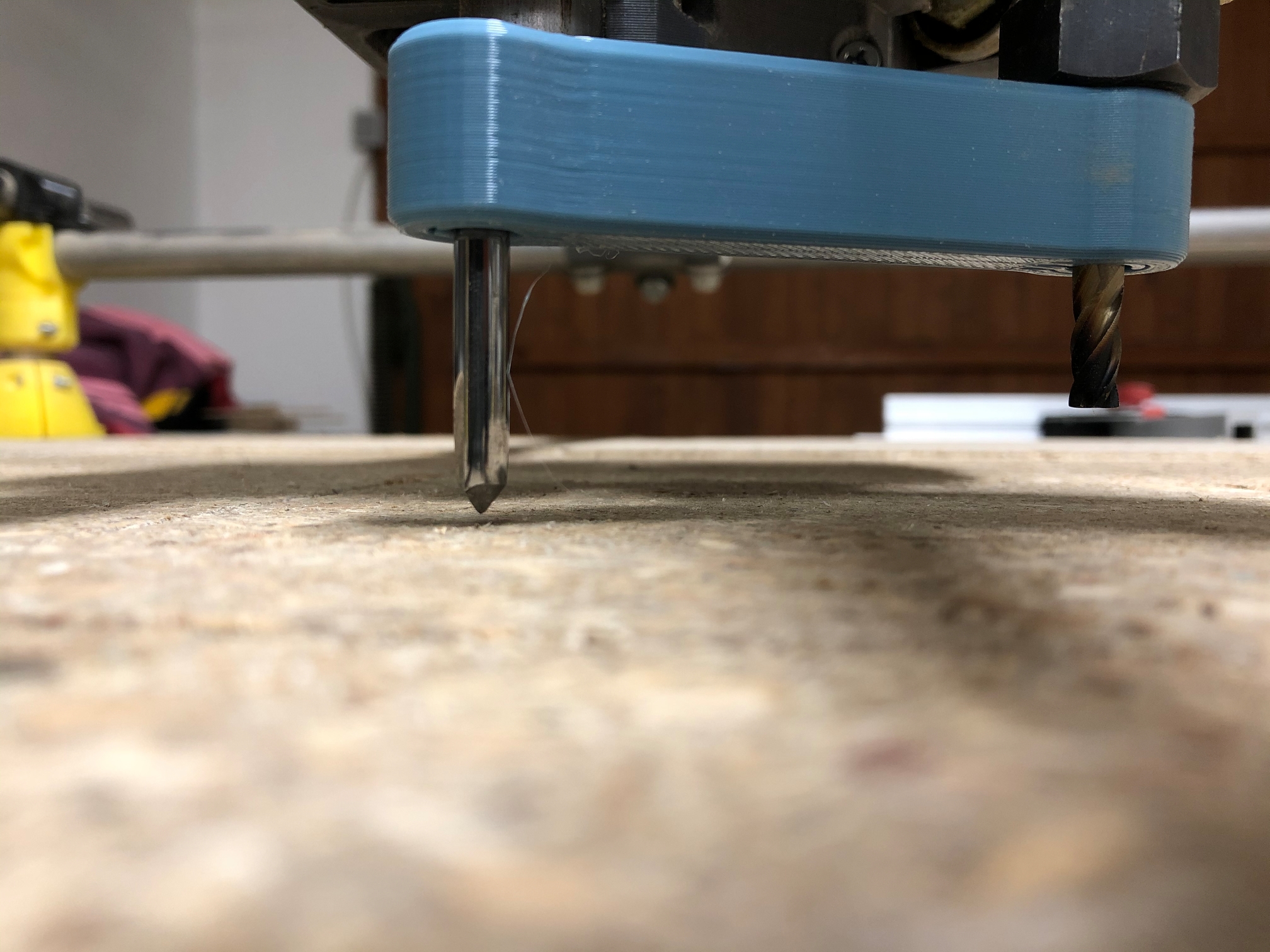

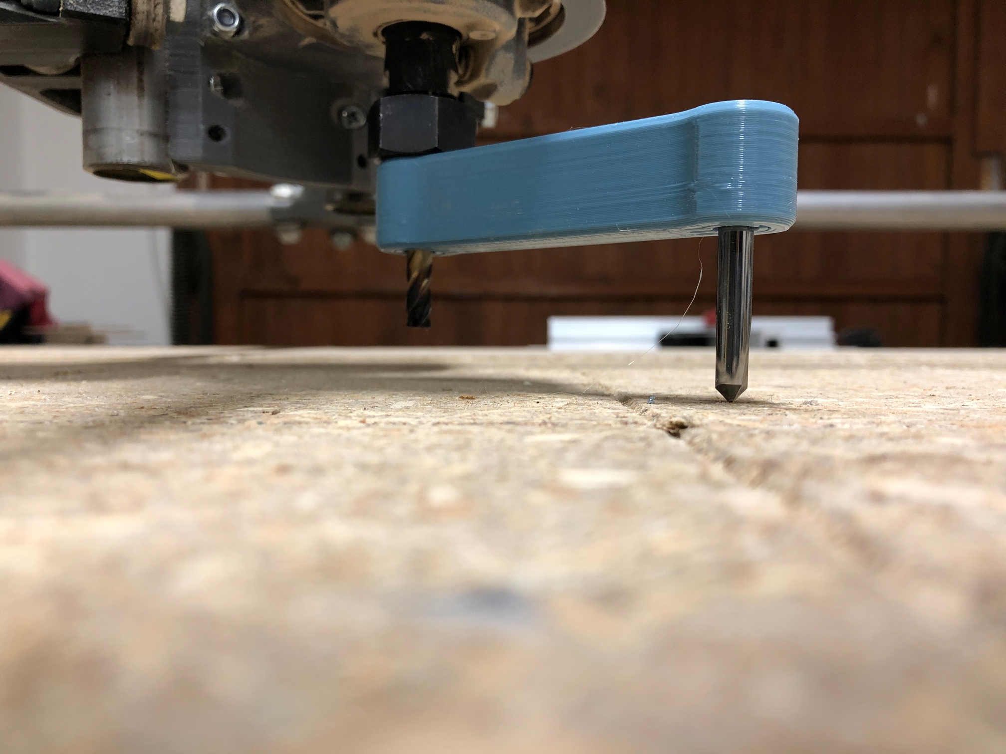

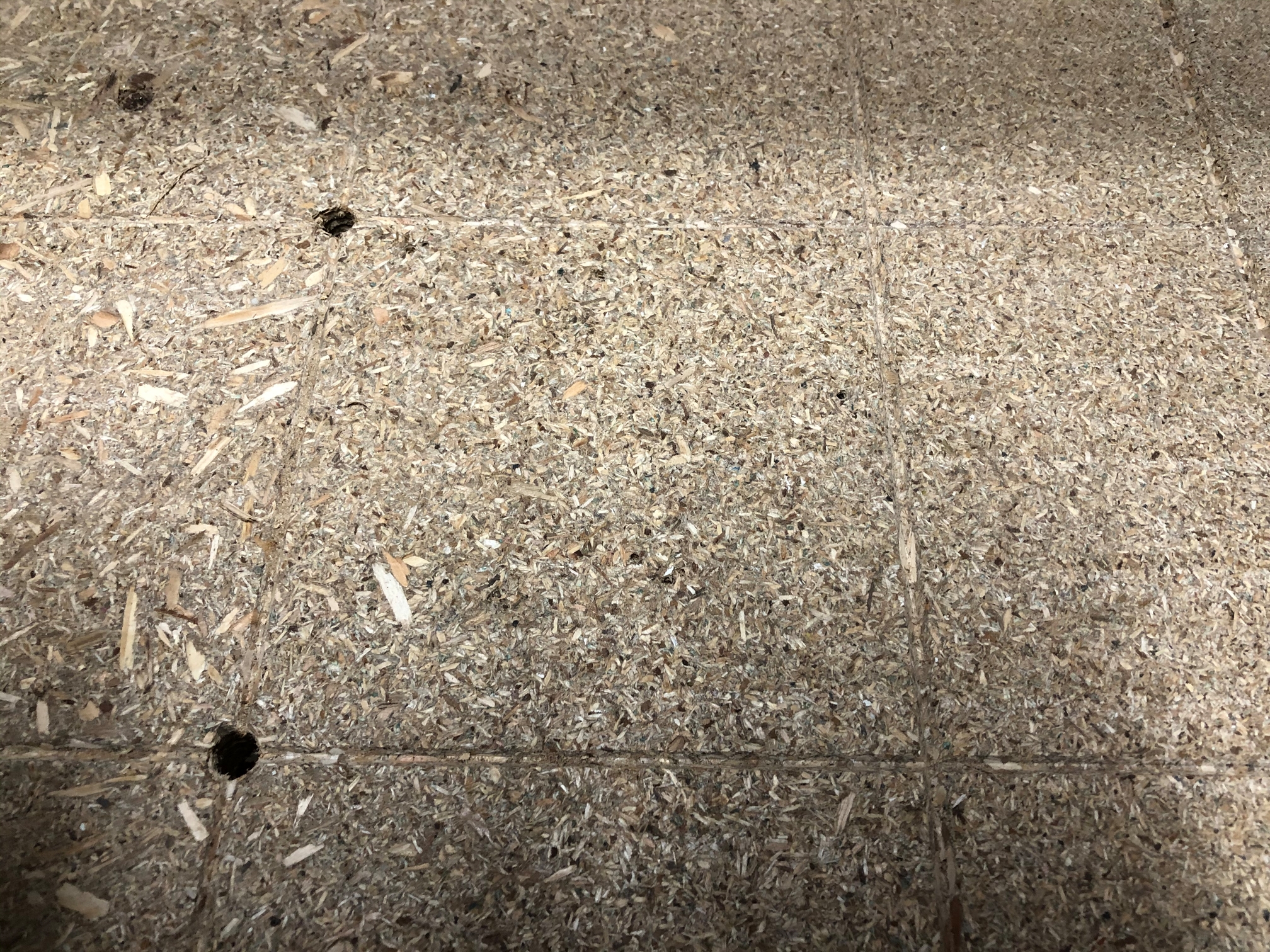

I’ve been trying to surface my spoilboard, and have discovered that I also need to tram the machinge, since my spindle is not perpendicular to the board. It’s hard to see in the image, but there’re high spots across the spoilboard after running my surface bit in two shallow (0,5 mm) passes.
I can’t seem to figure out, which bolts I should adjust to tram the machine.
Can you guys help me out?
Shim the router, don’t mess with the bolts, they square the tubes. Cut up a soda can for shim stock.
So, just place some shims between the tool mount and the router?
Yes, you place these shims between the router casing and the mount surfaces.
