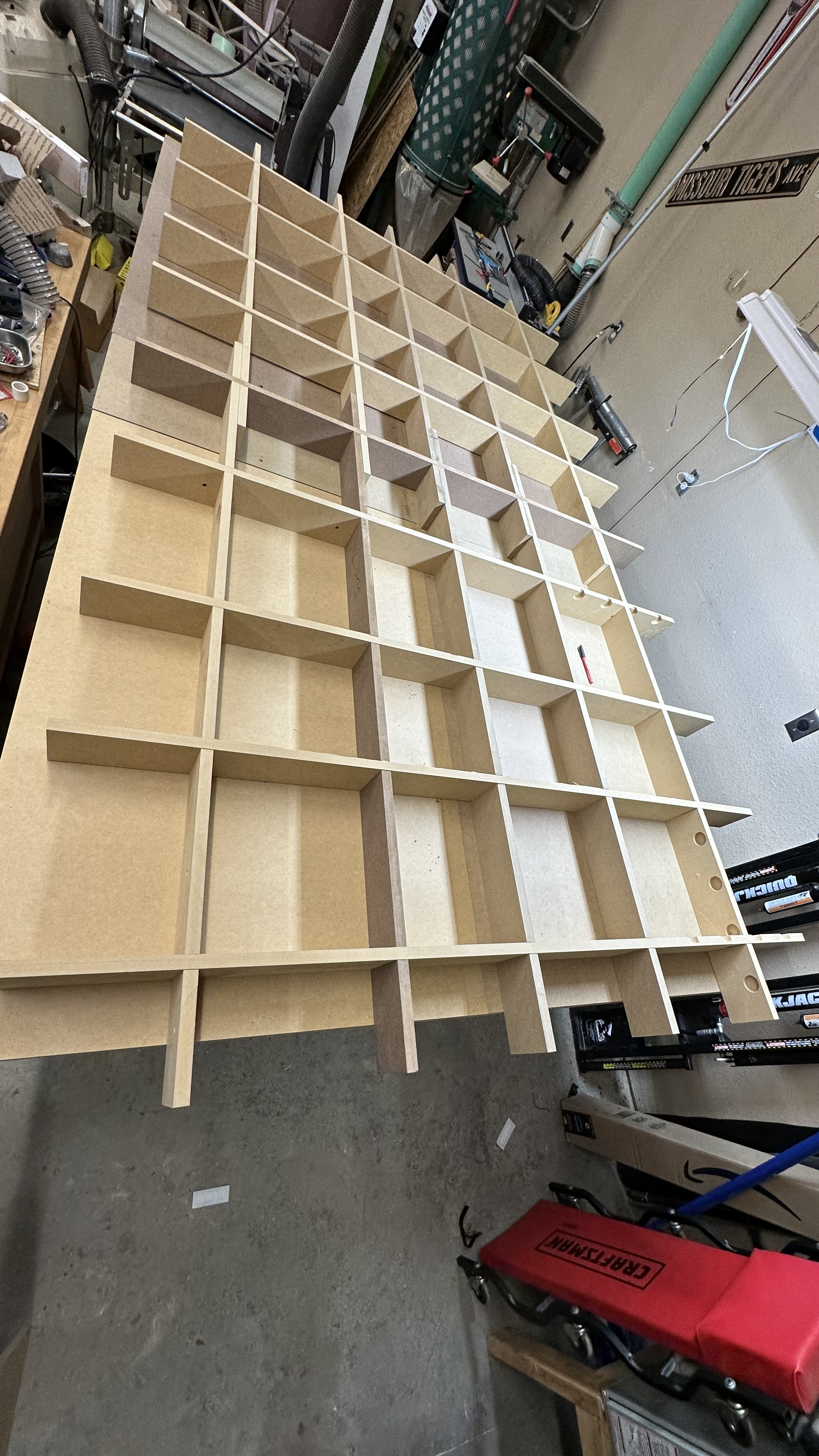

I found enough scrap MDF to re-cut the ribs I needed, and actually took my time on this iteration to get all the dado cuts correct.

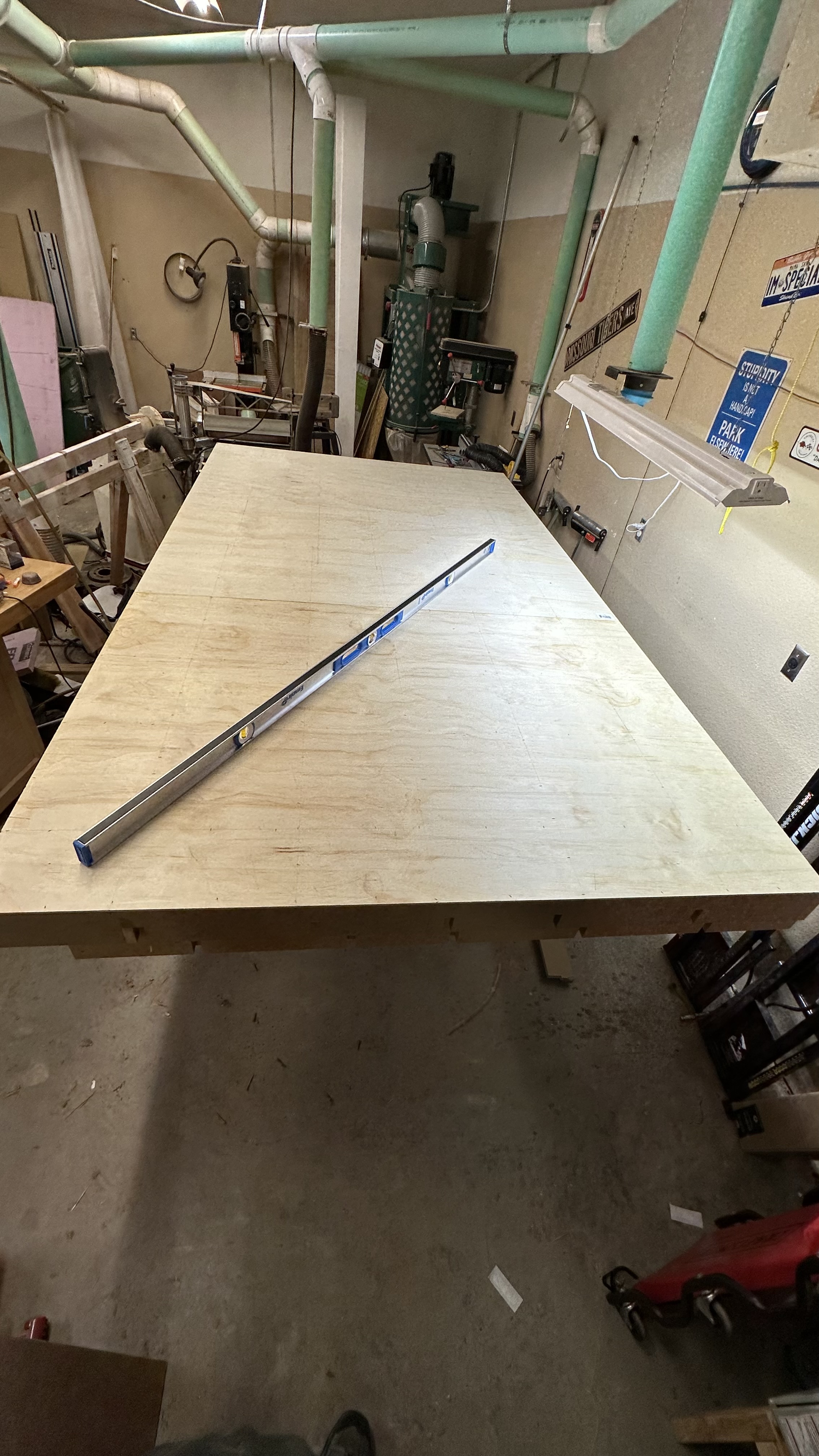

First side is skinned with 1/4” underlayment. It’s mostly flat, not perfect but close enough. Once it’s dry (and after the Chiefs win in a couple hours), I’ll flip it over, shim it as flat as I can and put the second skin on.
Well, actually, I’m going to add a few gussets on the inside of this skin so I can bolt it down to my old workbench, then the second skin goes on.
I had very tight fitting but perfectly tight fitting joints, and I did use glue which act as lubrication believe it or not and then a clamp that press the two together, this was after I used the hammer and broke some ribs lol I use glue on the joints on the ribs and I also use glue on the quarter inch sheeting top and bottom and used weight And clamps around the edges weight in the field and no nails or staples anywhere
Also to keep it lightweight so I can move it by myself full sheet I used half inch plywood for my ribs and struts
