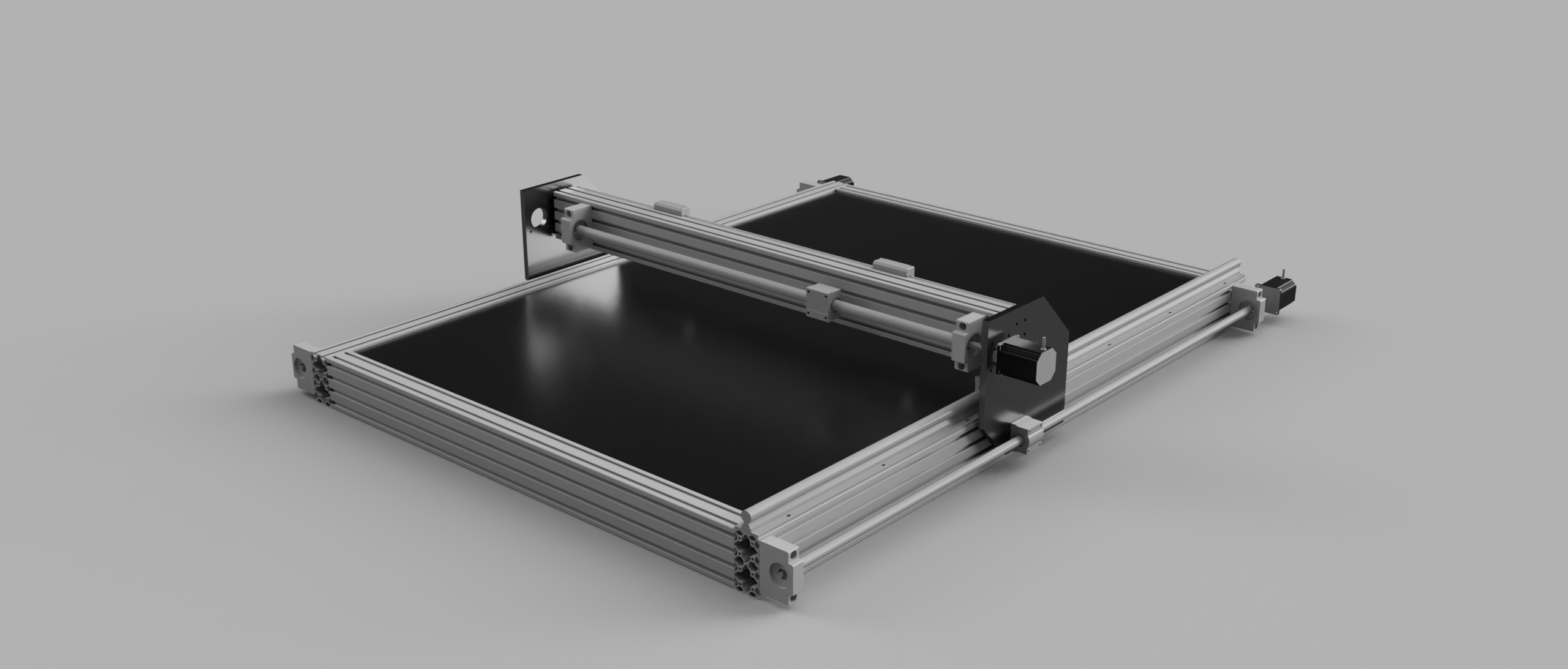

Screwed around in Fusion 360 today to get an idea of what this might look like. Decided to take a look at 8020 extrusion. It’s not “too” terribly expensive.
Fusion makes it pretty easy to grab CAD drawings and throw together a design. It’s pretty much your typical cartesian style machine. Main Spoilboard is 3/4" MDF. I’d have a second spoilboard bolted to the top of this one. Total cut size would be 1400mm x 1000mm (55" x 39"). Right now I have the z height at about 1.75" (sorry for the mixed measurements), but would probably adjust it to get about a 2.5".

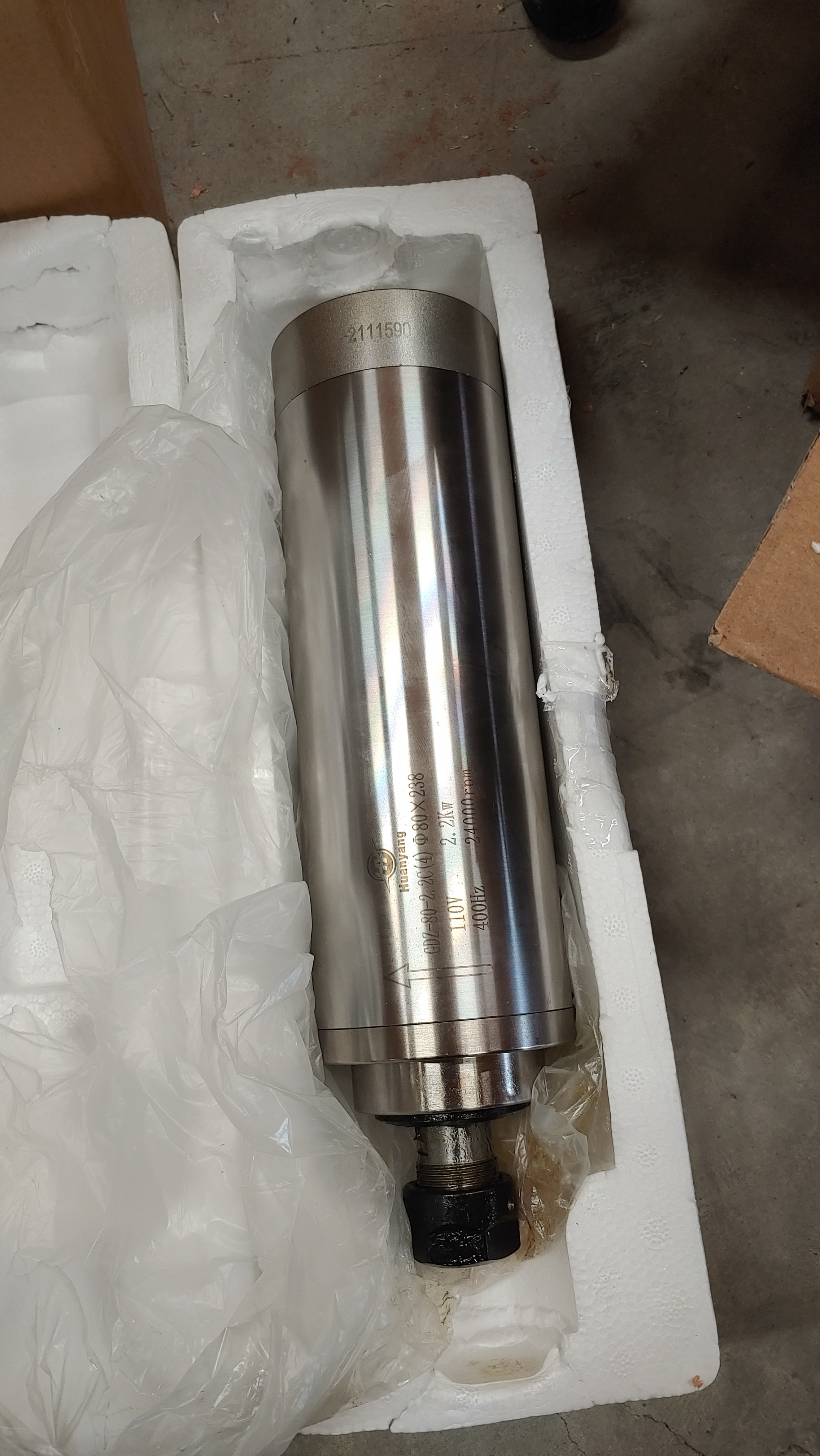

Total pricing including the 2.2kw water cooled spindle, NEMA23 steppers and drivers (but not all the M5 and 1/4-20 bolts or shipping) is ~$2400. You’d still need some way of getting the signal to the drivers.
I still need to design some adapters to bolt the 20UU rails and ball-screw mounts to the 8020 extrusion. That should just be some 1/4" steel plates, though and I don’t want to design those until I have some of the parts in my hand to verify/validate the amazon parts match the ones pulled in by Fusion.
I also need to figure out how I’d attach the pre-made Z axis to the ball screw on the back of the gantry. (more design as I go stuff)

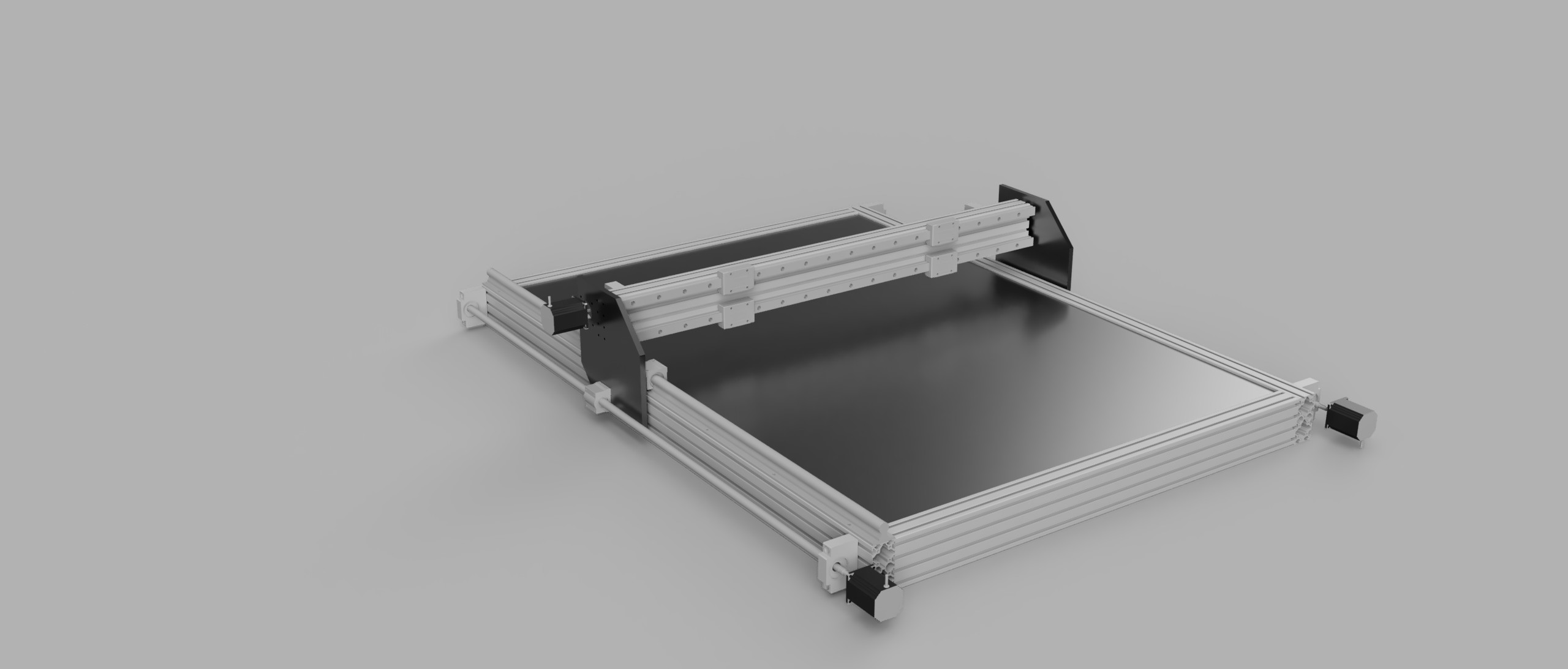

back
front

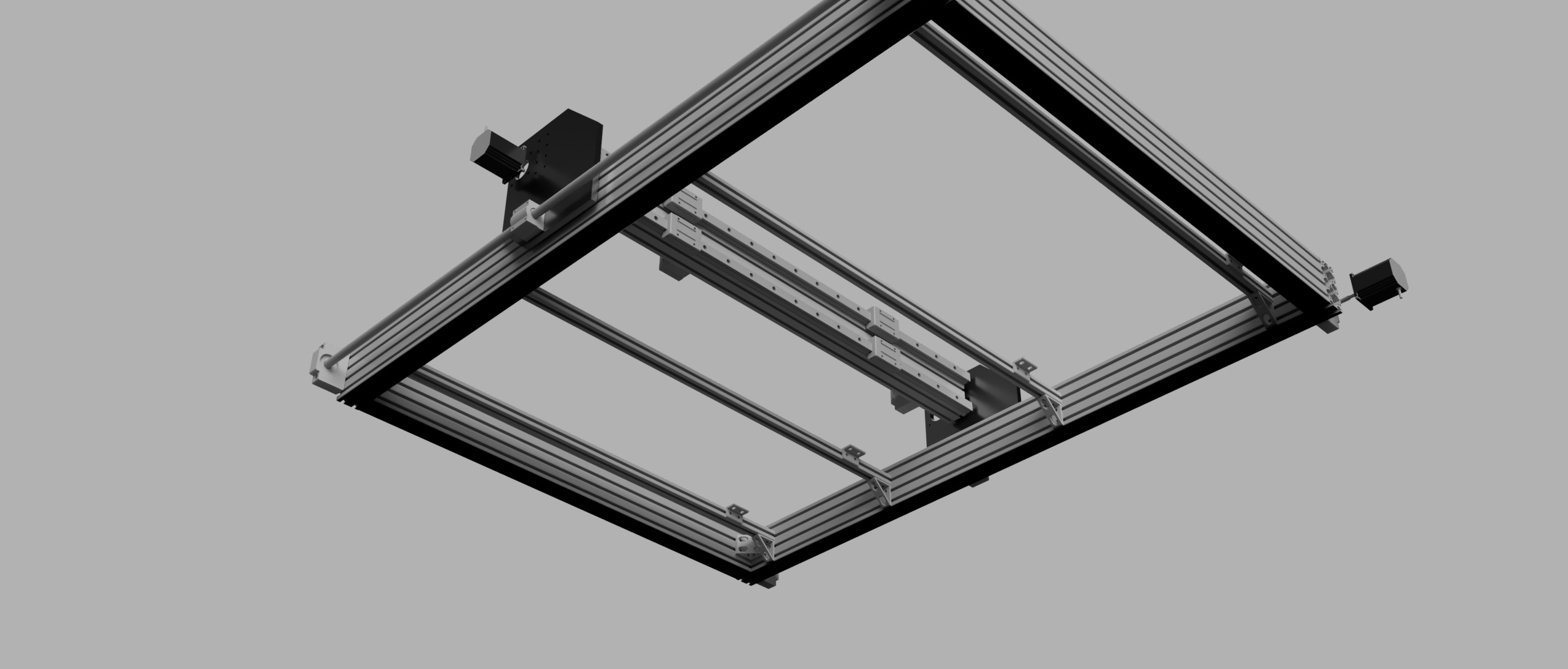

bottom with spoilboard removed to show rails.

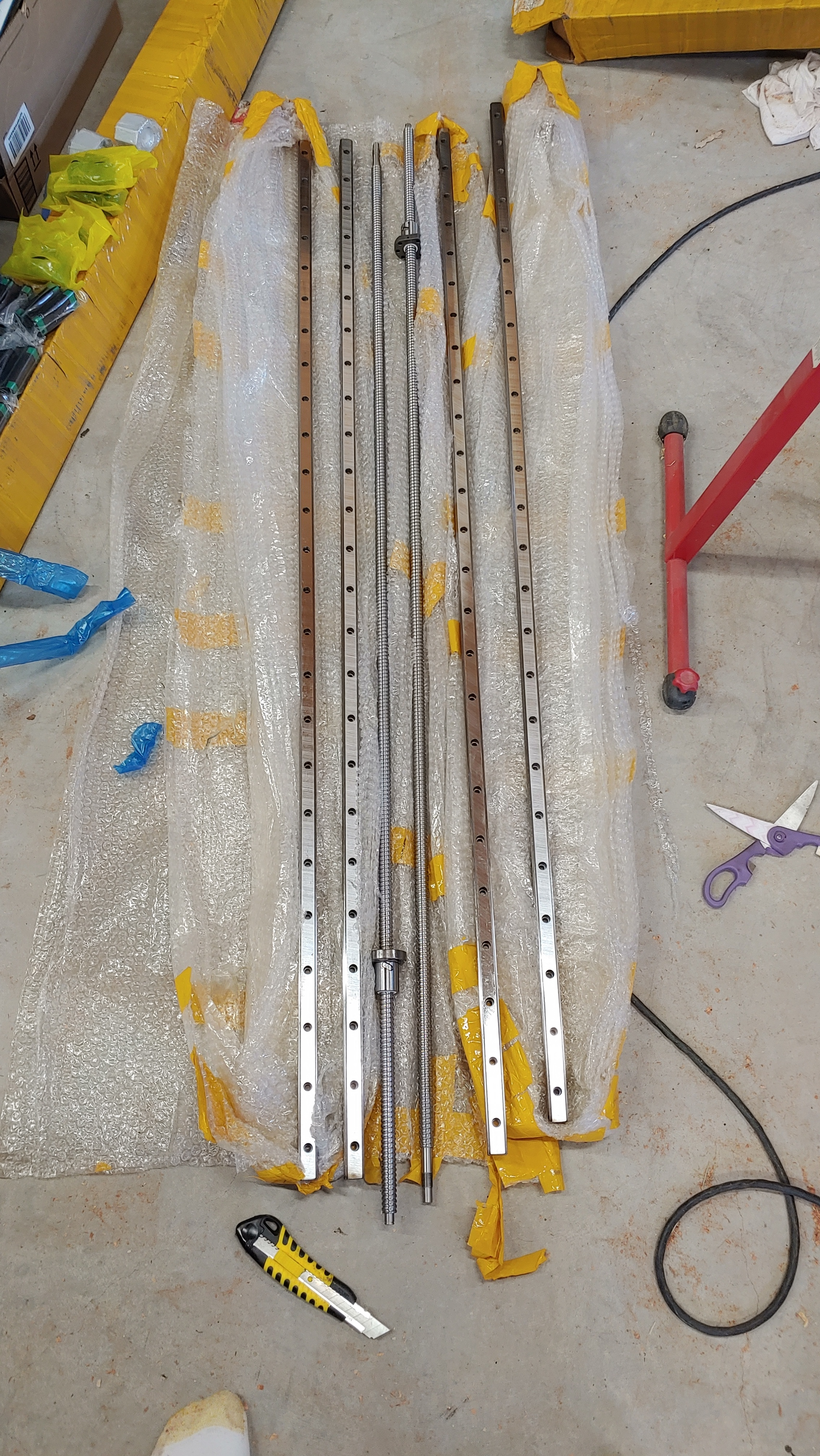

Rails arrived. Good news is, nothing looks bent.
Still can’t decide if I want to do a welded steel frame or 8020.
Last of the expensive parts showed up today. Now I can take measurements and start really designing something.
