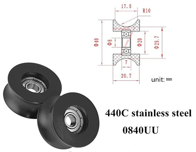

We have the guide rail, like yours Heffe. An actual rail like this thread(singular, wheels on the other side). Wheels on top and on the side (needs two good reference surfaces). Or one of many linear rails. Or metal angle or square tube with wheels or bearings. Or fix what we have.

Maybe the key is 60mm wheels (or, can we afford a larger, more common size, like 68?). If you want/need a rail, 3D print some V wheels that combine with 3/4" angle to be 68mm too.
