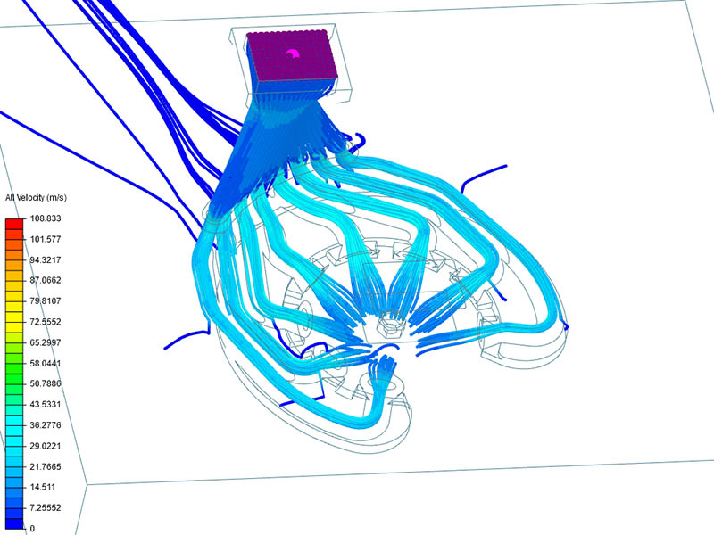

After having printed for more than 5 years without a print cooling fan, I decided to finally try one to see if it helps my prints. I couldn’t find a mount that fits my machine & tried starting with a couple different ones I found on thingiverse, but turned out to be easier to just start from scratch. I did use https://www.thingiverse.com/thing:2162427 as a mounting orientation guide for the fan. I originally made the bottom outlet ring 180 degrees with 5 outlets, but 120 with 3 outlets seemed to be enough. I would have liked to cut some more of the opening back, but was too much trouble for now. First test print with 180 degree bottom seems like it puts a nice amount of air out. I added a little wall in front of center outlet to help divert more air to the other 2 outer outlets. I added one break away support for the tube, but no other supports in the print. I am printing my 1st version to try in PETG. Here is what the design looks like.
Since Teaching Tech did a video recently on simulation of air flow for these part, I had to try it. Doesn’t look too bad, but could use some adjustment to the design.
If you’ve printed it already, you can put a bowl filled with water under the nozzle and see where the surface moves from the fan. That uses a higher fidelity physics model
Thanks, I will have to try that water bowl. For my 1st fan cooler it will probably serve my needs.

I have my design working pretty good with 12 outlets & had a interesting idea of how to change it even better when I woke up yesterday morning. I spent yesterday drawing it up to see if looked good & today I redrew it to get rid of all the junk in the file & also make it so it would run in the simulator. I made an 8 port manifold design so each nozzle gets its own pipe. I am going to print it tonight & see how it looks tomorrow. Here are 3 screenshots.
Are you going to do that in layers and glue them together, or fiddle with it a bunch to remove the supports?
It prints with no supports without any problem & seems to push more air than previous design. It was a little heavier & I could not get it as level at the bottom as previous design, but have cut out 12% of the volume & will reprint today. Simulation actually takes less time than previous design. Latest Simulation looks even better & now I am adding some internal chamfers & running sim again. The simulator has barfed before when I added the chamfers, but likes it ok this time. Here is what the previous run looks like. Seems like I am getting more velocity than before. Velocity starts at 8.83m/s
Looks like the chamfers smoothed out the speed at the splits. Bill, you did get me thinking about what it looks like inside those tubes after the print, so I will make a cross section test print this morning. It will probably be slightly rough at the top, but it does get plenty of air thru those tubes.

I would use the newer design for the Zyltech as it is more efficient & takes up less space, although the previous design does look cooler.

It seems your design is quite bulky compared to other, simpler design, has it affected ringing?
I don’t think the 2nd design is bulky. I used manual input shaping with klipper & ringing is hardly there now.
