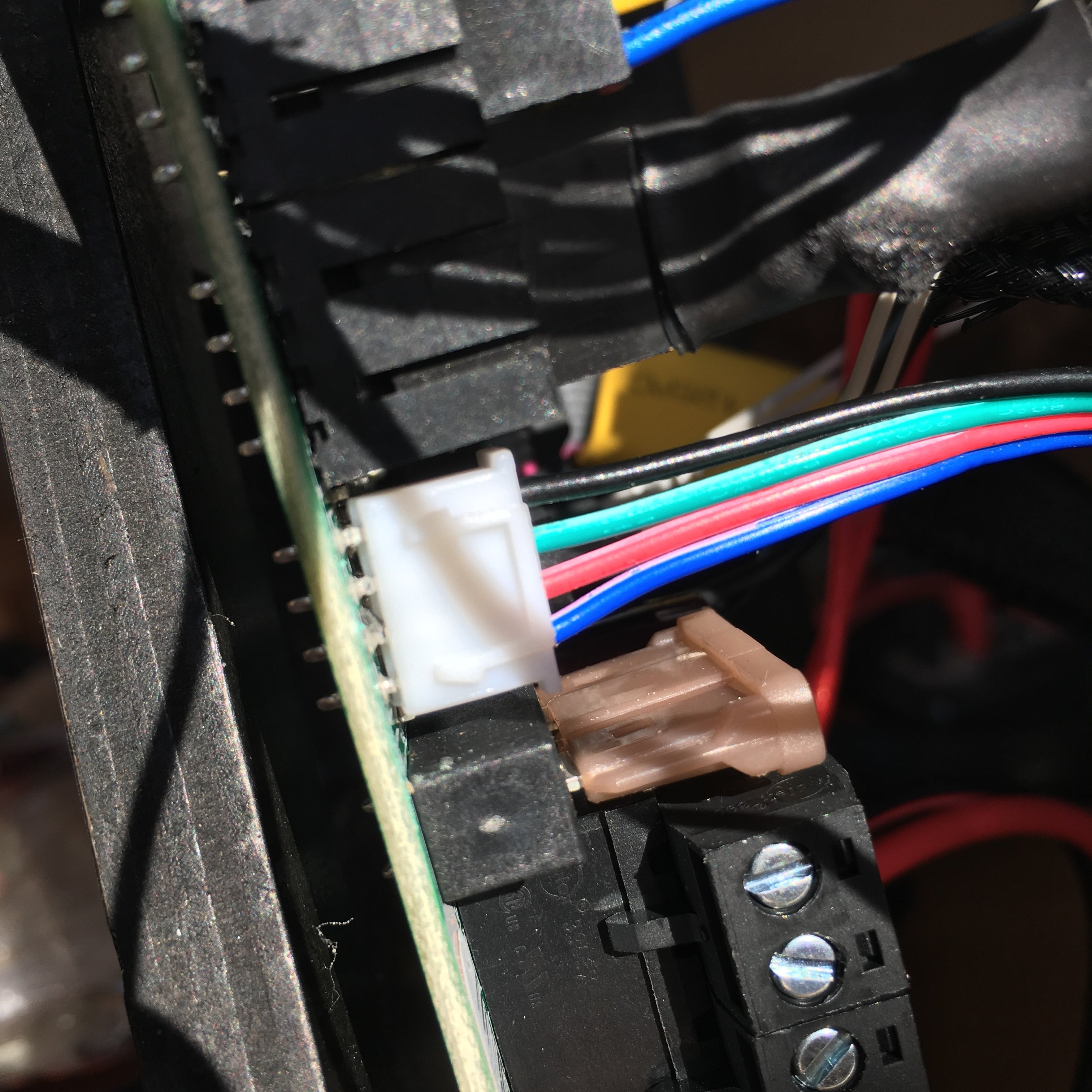

That white plug coming off the extruder motor does NOT plug into the miniRambo does it? I am assuming the answer is “no” and assuming I have to convert that to a 4 pin Molex as well (which I did not order…sigh…more wait time). Can someone confirm for me? Is it maybe as simple as carving off the nubs on the white plug so it’ll fit into the Molex receptacle?

Its this one - the rainbow ribbon coming off the extruder motor. I (accidentally) snapped the middle clip out of the Molex receptacle on the board but this is the slot the wire appears to need to plug into but the white plug won’t fit into the black socket without some modification of some sort. I tried very carefully to pry the black receptacle off the pins but I’m nervous to pry too hard - don’t want to pull the pins right out of the board! The photo ( IMG_20170503_130652-400x255.jpg ) shows no black around the white connector though. Do they literally just pull off the board?

The white connector is a JST-XH connector, and the rambo is molex captive connectors. You can either cut the white end off and crimo on molex, pull the shroud off of the rambo board, or make an extension cable to connect them with close to the right connectors on both ends.
Personally, as long as the cable is long enough, I’d try to remove the shroud on the mini rambo.
Success! For any that find themselves in the same pickle, I just slipped the tip of a small screw driver under one corner of the black bit, then the other corner, then the back and forth and back and forth. Once I got it halfway up the pins it started to slide more free. It worked for me - don’t chase me down if you accidentally pull pins from your board. Nerve wracking for sure…
