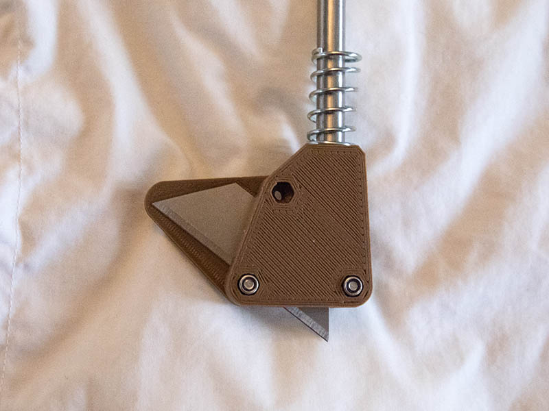

Tangential cutter in development

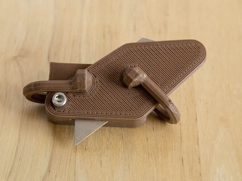

After changing the design of the cutter holder to match the Husky utility blade profile, I was starting to think about a better way to hold the blade in place & be able to change it without taking 1 or 2 screws out. In the middle of the night I realized a binder clip might work for this. If I make some recesses in the plastic on the bottom & the top cover this might work well. Here is a photo of what I had in mind. I will have to adjust the cover & holder to match the clip better. This clip is 1.5" wide. Looks like I will have to clip it to the side or along the top sharp edge of the blade instead of the top as I don’t have enough clearance on top. I might be able to design a plastic clip, but would not be as strong as the metal binder clips.

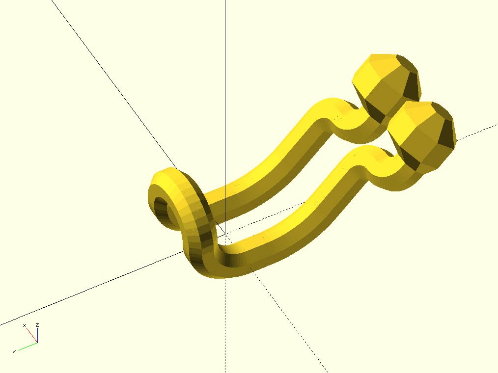

I came up with a clip clamp along this idea which looks like it will work. I need to make the diameter a little bigger to get more strength, but 1st test seemed pretty good. I made it 8 sided so it would print well. Here are 2 pictures & a dimensioned part. I made the design with 5 customizable dimensions. I have not put it on thingiverse yet. I am going to use this idea for something else also, which is why I made the 2 sides individual variable lengths.
I got a little sidetracked & went a little overboard with customizing variables for this little clip clamp. Hope I did not get too far off topic here. I am not sure it will be strong enough to replace the screws in this design, but should have some other uses. Here is an example image showing most of the possible variations in the design. The part can be found thingiverse & also opened in the customizer: https://www.thingiverse.com/thing:2726864

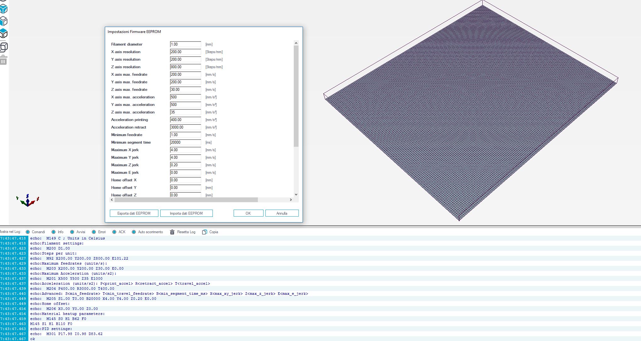

I have just double checked also my eeprom setting, and I have 102.4 steps/mm for E, and G1 E360 does one full turn…honest. I can’t explain it.
I agree with the formula of 200 * steps / 360 in theory. I checked the spec of my E stepper: also 200 steps per revolution. I don’t think I changed anything in the firmware other than the two lines you have to comment, but it really shouldn’t matter if I had. Should be able to control this from eeprom and the driver jumpers only. I have also checked the driver jumpers on mine. DRV8825 with all jumpers, so 1/32 stepping.
Maybe in Maong’s case the firmware is not responding to the changes of E steps/mm in configuration.h, because it’s reading the value from eeprom. I always make changes in eeprom. Either gcode or Alt+E in Repetier host. Did you try Jeff’s suggestion? I’m guessing if you start with an M500 it will show that the steps/mm for E is not what you are setting.
What!?! That’s off by about a factor of 6 (5.76). This is very strange. Where could we be making a 6x mistake? 2pi? Sqrt(36)? This is going to bother me all day…

when I try to do ALT + E, an extruder does not appear on repetier host…
What do you mean, they do not match? How much did it move the first move and the second move? Each move should take two seconds.
I did your test…
in both cases they stop at the same point…every move requires a lot more than two seconds…
surely there is some setting in the firmware to be fixed
The DEFAULT_MAX_FEEDRATE is set to 1 deg/sec, that’s not very high. Maybe set that to 90. The acceleration is enormous, maybe set that to 180.
The F30 should be 30degrees/min, and it’s trying to move only one degree, so that should be 2 seconds. Something is wrong.
It’s very hard to debug from here. The configuration.h is very long… You haven’t told me how long it takes, how far it goes, or wether changing the setting in the middle makes any difference.
