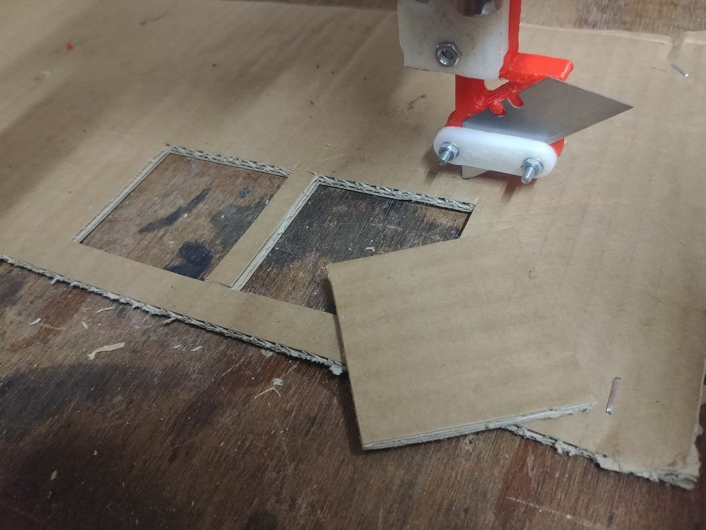

Tangential cutter in development
Software updated, now takes two extra parameters:
knife lift threshold angle (degrees)
4th axis command (defaults to A, I’m overriding to E)
Gcode is generated which can be fed straight to the machine now.
First cuts successful:
[attachment file=47146]
So far so good, and looks like this is going to work great.
Once things are tidied up and it’s fully tested I’ll share the design and software update.
What?!? You just cut a square with a giant blade that has a large offset. This is working so awesome.

No, the design follows the principle of a typical tangential cutter. There is no offset. The point of the blade is directly under the centre of the A axis.
It should be possible to do some really intricate designs hopefully.

I think this is also the first true 4th axis work, although not 4-axis CNC, the other rotational stuff was using y for rotation.
Would you typically want it to over cut like that, or leave some material in the corner, on the bottom?
You could do sort of a lead in, and lead out, lifting while approaching the end… On hard turns like that, I don’t know how you would avoid only turning while at the clearance height. It would be nice if it could be smoother, and general for complicated shapes.
If you want to cut all the way through, you really need to think of each thing as a line segment, compute the angle at the start and move to the end.
Sorry for the thought dumps…
Are you talking about the fact that the squares were not done in one pass? If that’s the case, I am pretty sure it’s difficult on a crappy ply spoilboard and a semi blunt blade. I have got myself an A0 cutting mat, so was planning to install that and try for one pass cuts
The over cut is due to the material thickness. With thicker material, I think it’s inevitable. The blade tip was following the precise shape.
