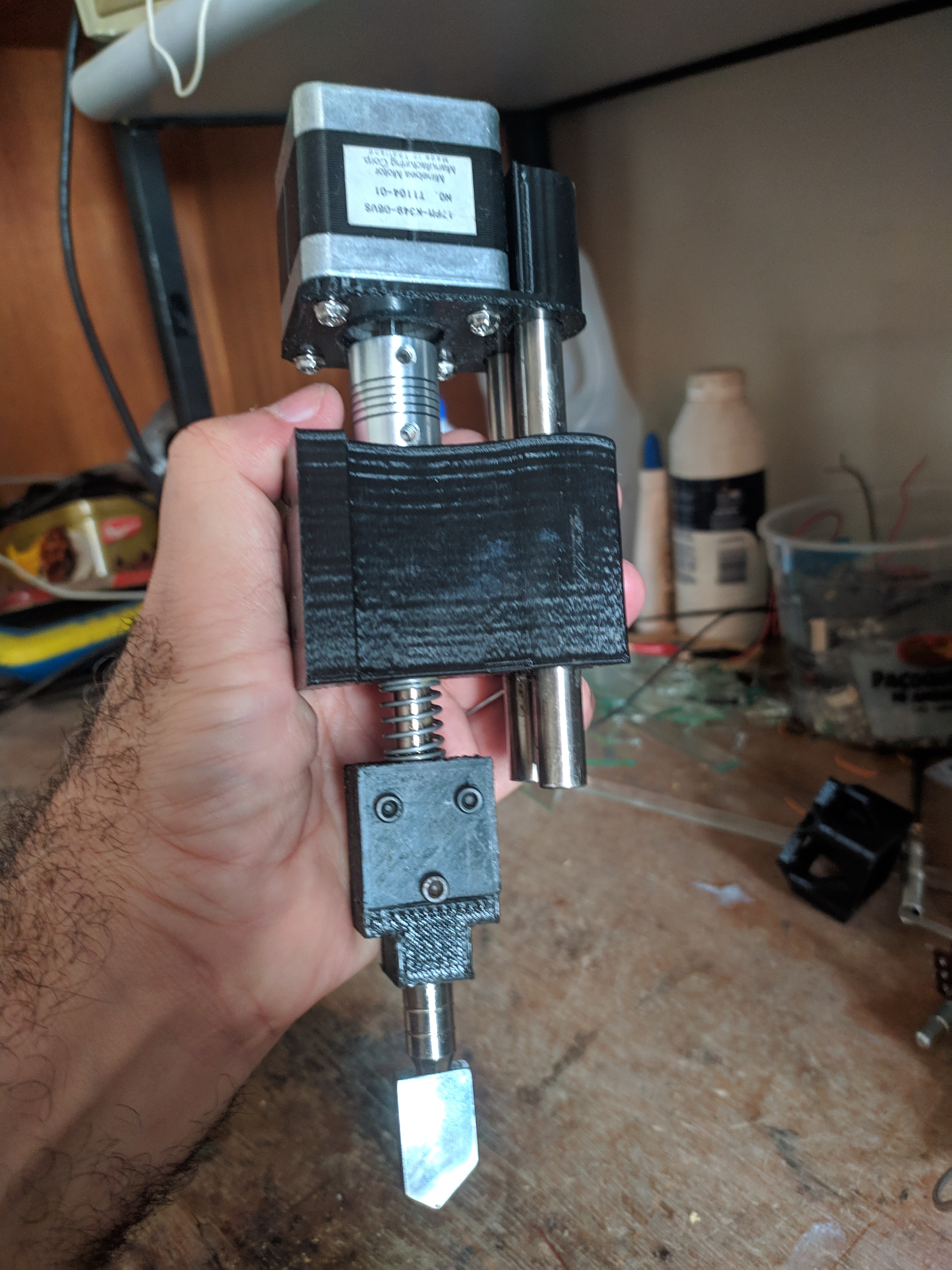

Here’s a simple active tangential blade I built this evening. I’ll nail it to my machine later and try it with Grblgru. Since I had all the bits I just needed to print a blade holder. I used the version GeoDave designed for an 8mm shaft.
A small Nema17 stepper with a 5 to 8mm coupler and the usual 608 bearing to support the 8mm shaft, some bits of wood, a razor blade and voila.
This looks really interesting. What do you think the maximum depth would be?

Hi Rob. The maximum blade stickout is 10mm but practically expecting to use a couple of mm less than that should work. The second notch in this type of blade can ‘sort of fit’ over the printed projection to give maybe 15mm max but I don’t think it was made to do that really. I will have to add a small stiff spring around the 8mm shaft to cushion the ‘touchdown’ of the blade tip on the work surface. I will likely allow the assembly to slide through the bearing just a little letting the weight of the motor bear against the spring. It would be a little too rigid/stiff as is although it would work. GeoDave has a discussion of his prototypes elsewhere in this forum.

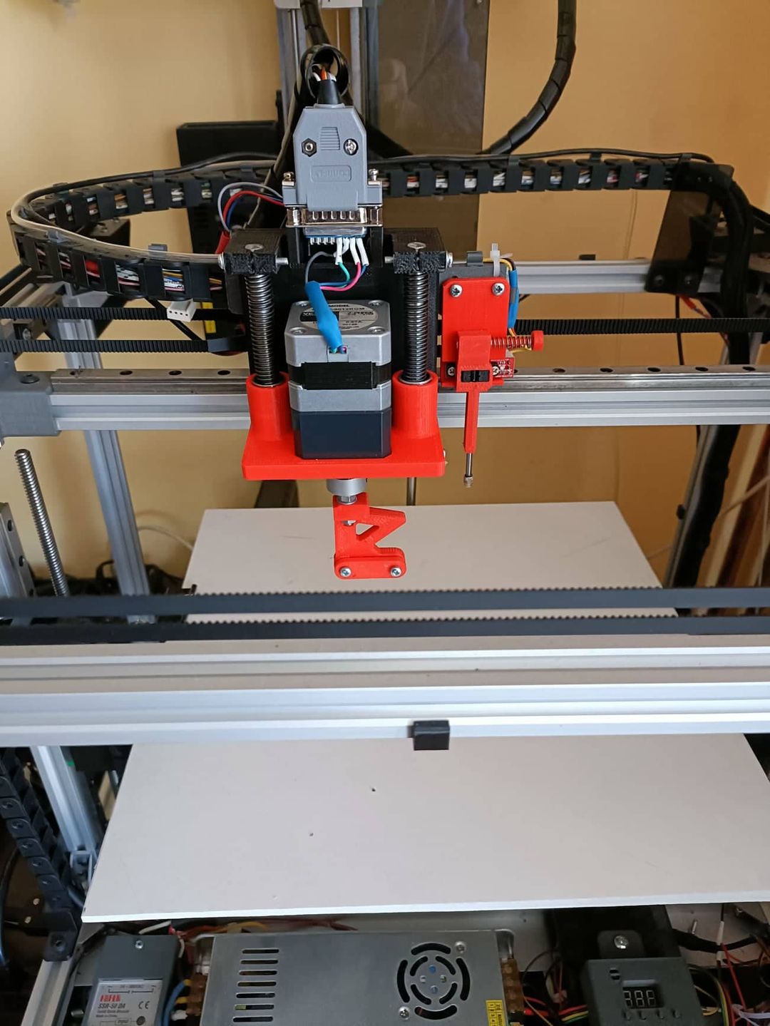

I made a Tangential Knife for my XY CORE printer. I adjusted steps and speeds. Everything in “Comment line” works fine. I have a problem with the generated g-code tools in inkskape. Even though I replace all the occurrences of “A” with “E” the knife does not rotate when the file is started. Cold extrusion lock is released M302 P1 …

I’m using Pronterface to upload G-gode
How to generate a working g-code?
Please help !
