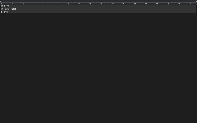

This is what appears in repetier host when i load the .gcode into it.
{\rtf1\ansi\ansicpg1252\cocoartf2513
\cocoatextscaling0\cocoaplatform0{\fonttbl\f0\fnil\fcharset0 Menlo-Regular;}
{\colortbl;\red255\green255\blue255;\red26\green26\blue26;\red255\green255\blue255;}
{*\expandedcolortbl;;\cssrgb\c13333\c13333\c13333;\cssrgb\c100000\c100000\c100000;}
\margl1440\margr1440\vieww10800\viewh8400\viewkind0
\deftab720
\pard\pardeftab720\partightenfactor0
\f0\fs30 \cf2 \cb3 \expnd0\expndtw0\kerning0
\outl0\strokewidth0 \strokec2 G92 Z0
G1 Z25 F700
; end
and here is what i put into textedit and then called testfile. Then I went and right clicked “get info” (I am on Mac) then I changed the name to testfile.gcode to change the extension.
I have no idea what all that extra stuff is that appears in repetier host

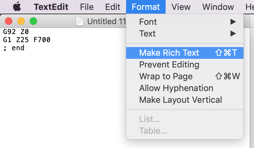

@JamochaTrilby

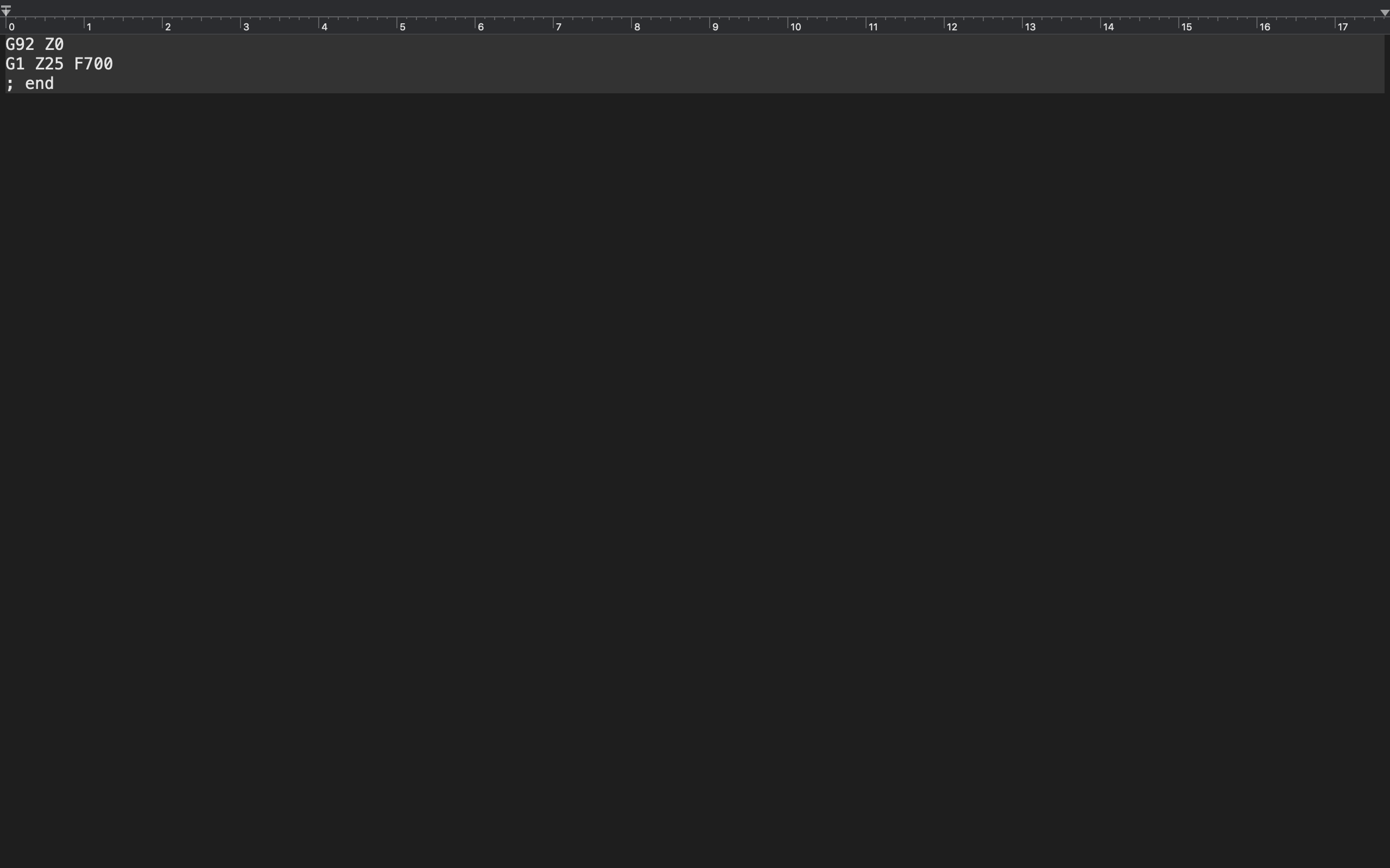

The file must be “plain text” — and absolutely cannot be “rich text”
Base on the screen shots and info you showed, you’ve saved a “rich text” file.
kerning, color, strokewidth, etc are all text formatting details of a rich text document.
I’m on Mac too. You can use TextEdit, but be sure to do plain text, not rich text.

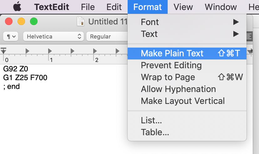

@JamochaTrilby
The TextEdit window should look like this:
…not this:

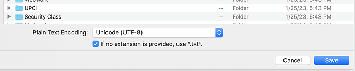

…and when saving, choose “Unicode (UTF-8)” as the plain text encoding:
I’m not trying to beat a dead horse, just mentioning: another bit of smoking gun showing it was a rich text file, are the first 3 letters, “rtf,” which stands for Rich Text Format.
