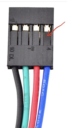

Did you buy your steppers from the V1 store? If not, what brand and model are they. A like to them would be helpful too. The wiring order for some steppers don’t match the order for the drivers on the Jackpot. I ran into this a couple of times with motors I bought off of Amazon. Once I figured out the correct order everything worked.
These are Stepperonline motors. The order for these is blue, black, red, and green. Yours might match or be totally different, but we’ll figure it out eventually.
Here’s the link to the steppers I bought from Amazon.

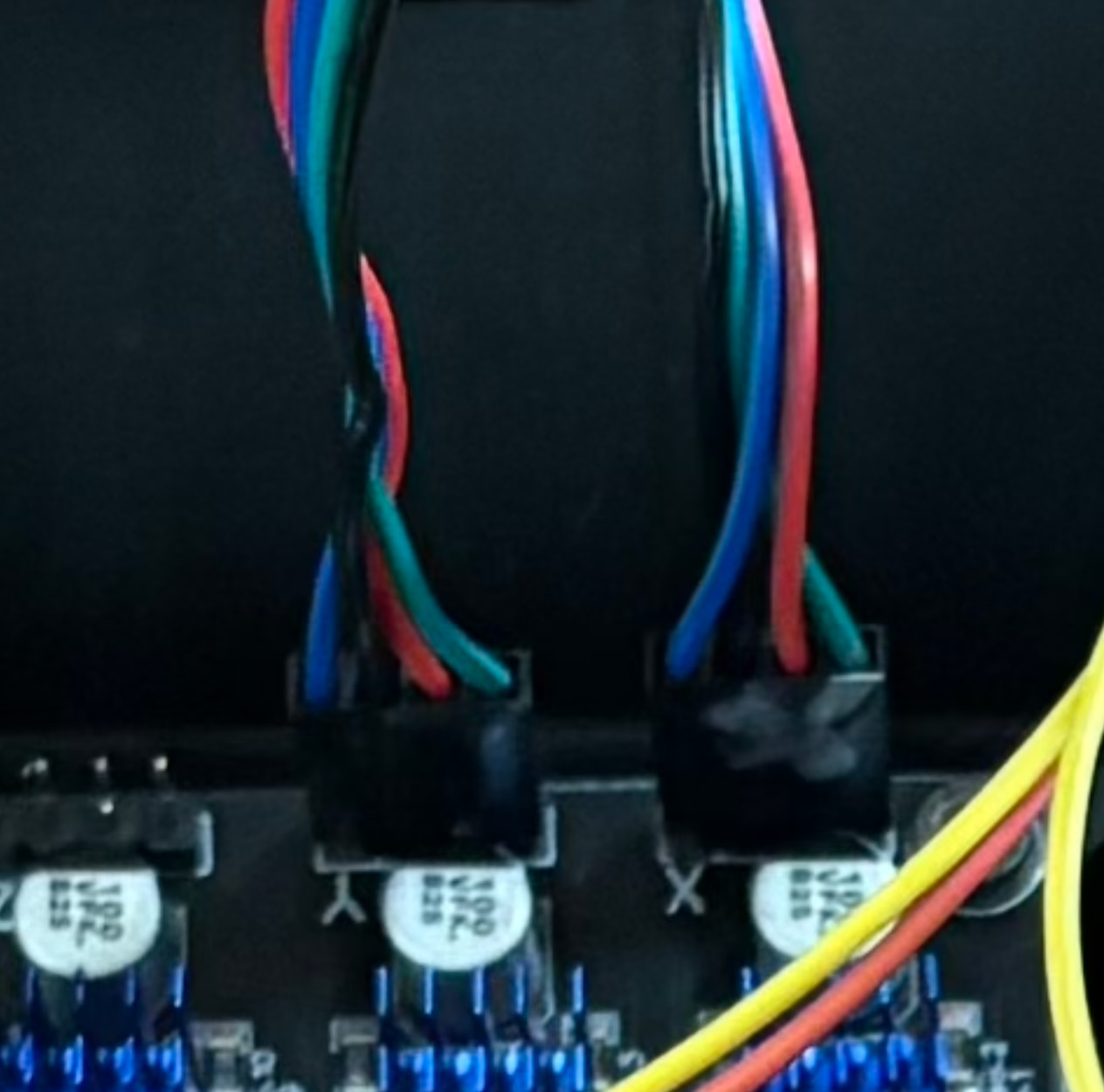

Color the same. I checked each one and flipped the wiring, still nothing. My question is even if the locations were different, one of them would have responded or at least tried to spin.
Also- when reinstalling the firmware I get an error that says “driver not found” on each axis. But the jackpot 3 is supposed to have them already installed?
Do you think I have to change the wire order within the oem harness?

The picture linked to the steppers shows this order. This is what mine had too. You can pry up the black tab and pull the wires out of the connector and change the order.
No, they won’t spin if the pairs are not in the correct order for the driver. It took me around an hour of reading and rearranging them to finally get the order correct.
Well color me embarrassed. I had been using my benchtop power supply. I came home today to find my actual power supply arrived in the mail. Plugged it in and everything worked!

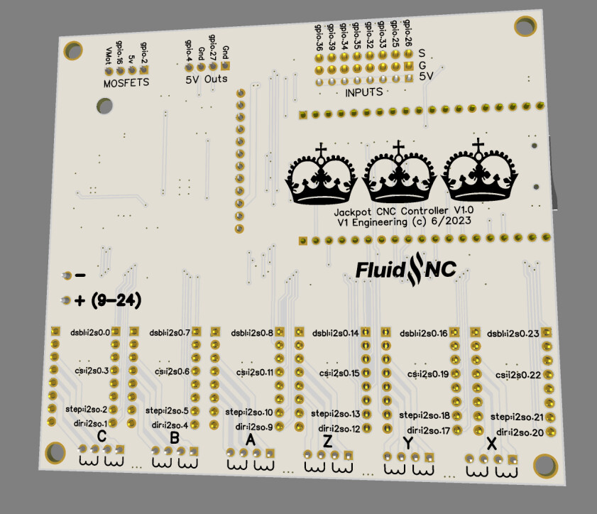

How are the Stepper Pins wired on the Jackpot3 (+A,-A, +B, -B)?
Sorry, I’m not sure about the order.
@vicious1
Based on the old Jackpot v1, there was a printed label on the bottom:
Since I’m assuming Bart and Ryan like consistency, that gives us AABB as the most likely. For a Stepper that had Polarity markings the pattern of A+A-B+B- wiring worked.
I added a pull request with the A+A-B+B- pattern added to the doc.
