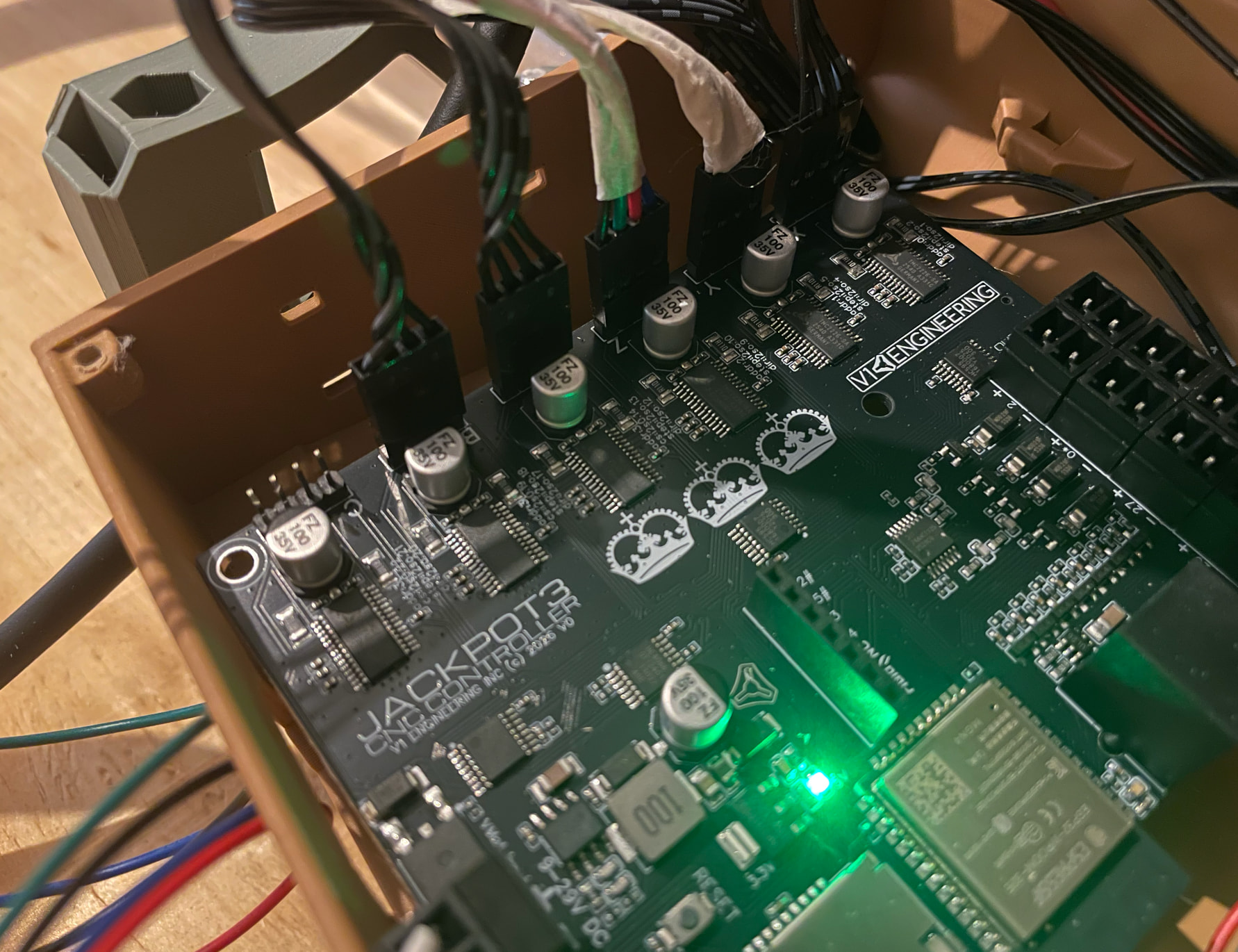

Which machine are you running? Which controller? Can you post some pics of your wiring?

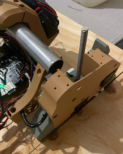

Thank you so much. O no I’ll figure out the forum at some point haha. I’m actually building the Lowrider v4. I’m running the jackpot 3 controller. So all the wires and steppers are working perfectly except the one (the Z min motor). The cable is the 3rd one. The other picture has the ball screw shown. I can freely turn the ball screw with my hand.

You can turn the lead screw with power applied to the board and the stepper plugged in? Just wanting to make sure I am following you 100%
Make sure you put the heat sinks on the drivers!
Yes that is correct. The lowrider has 2 Z axis steppers. The one lead screw is firm and the other lead screw is loose while the power is on.
Thanks. I saw them in the pictures now. I’ll add them now.

Well that sounds like a problem in your wiring or something else. Try powering down the board and swapping that stepper wire with the other Z stepper and see if the problem moves or stays with that same motor.
Great idea. The problem just moved. That tells me both the steppers and wires work. Maybe something on the port on the board.
