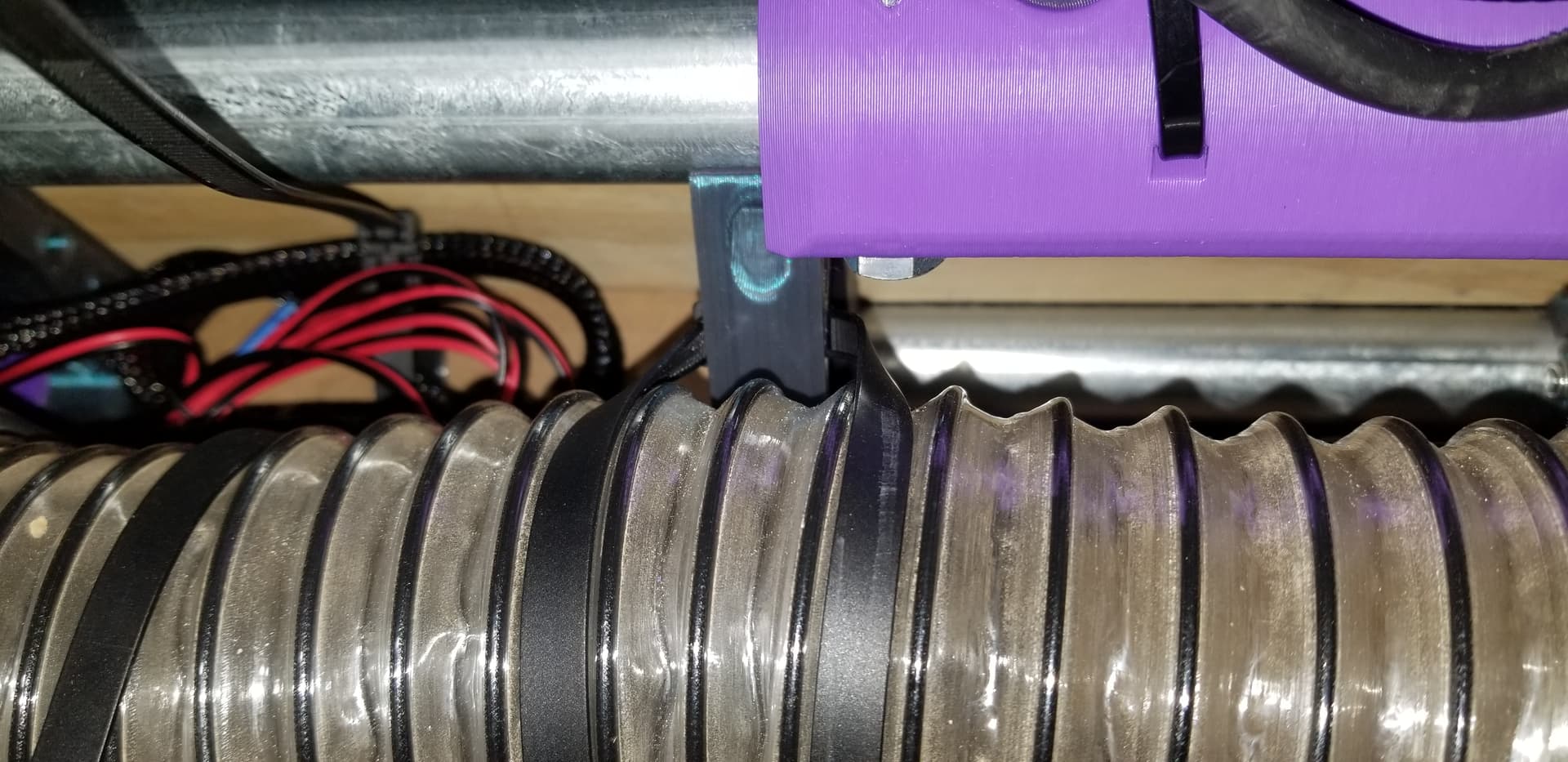

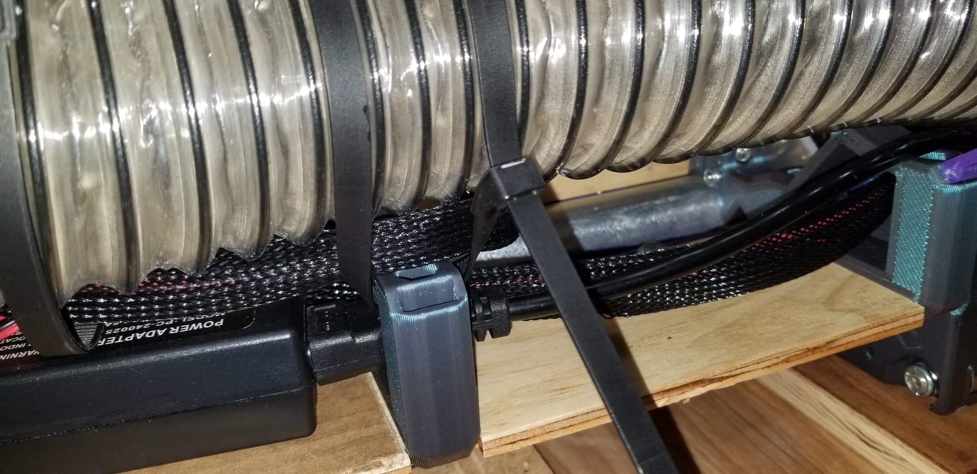

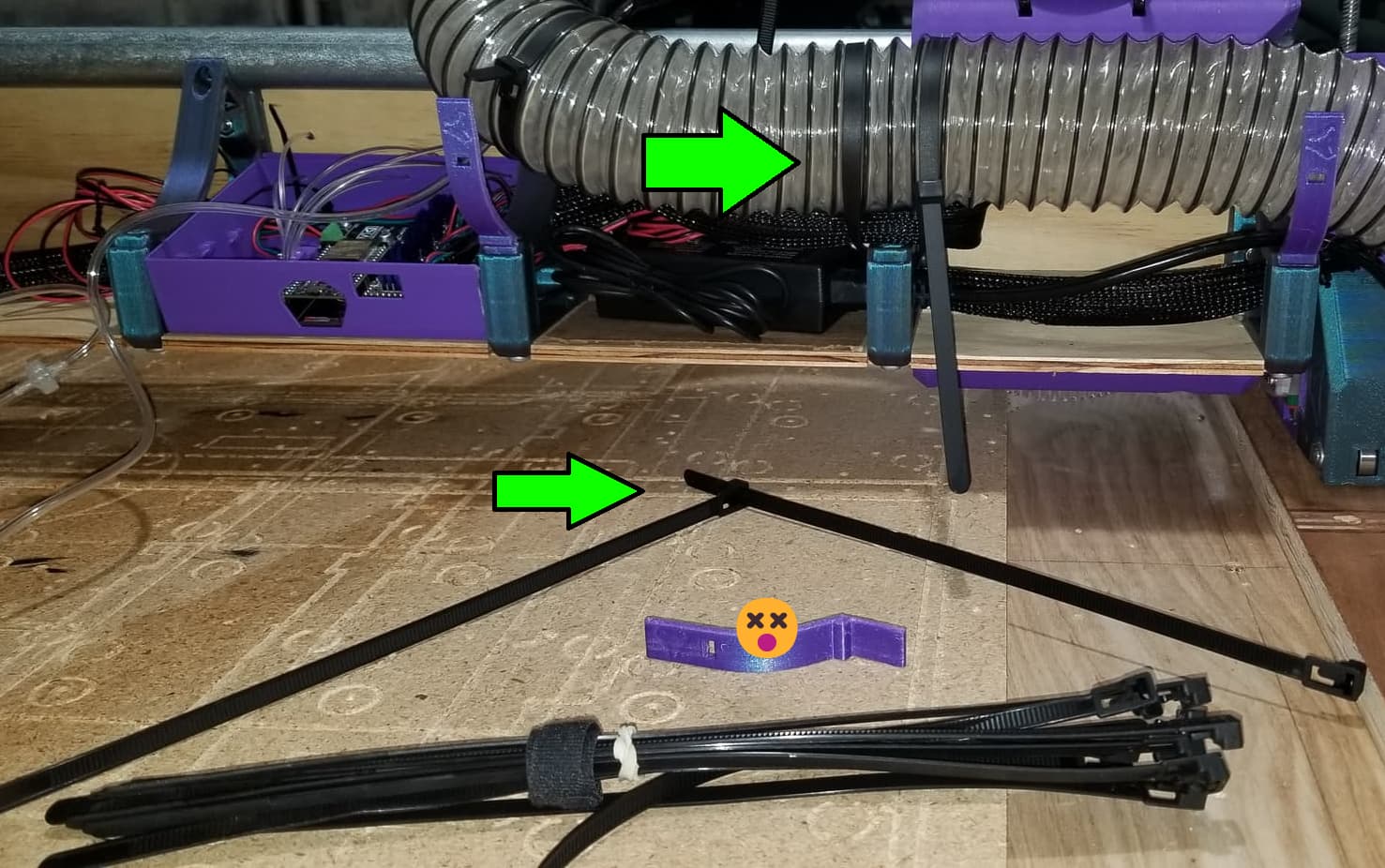

Think Ryan’s suggesting no hose hook needed, for stationary vac sections, if we have long zipties (or 2 connected ones) double looped over the Vac hose, threaded through brace holes…
I still need the hose bump part on the end, but will probably switch layout so Vac hose routes towards X Max instead. One of my goals is to keep X min side of bench clear and tools/storage accessible.
Ah that makes sense - that looks much better. Might be something to consider adding to the instructions - the section saying ‘Secure the hose again at just past the halfway point’ doesn’t have an accompanying image to suggest the way to do it and that’s certainly neat and secure.

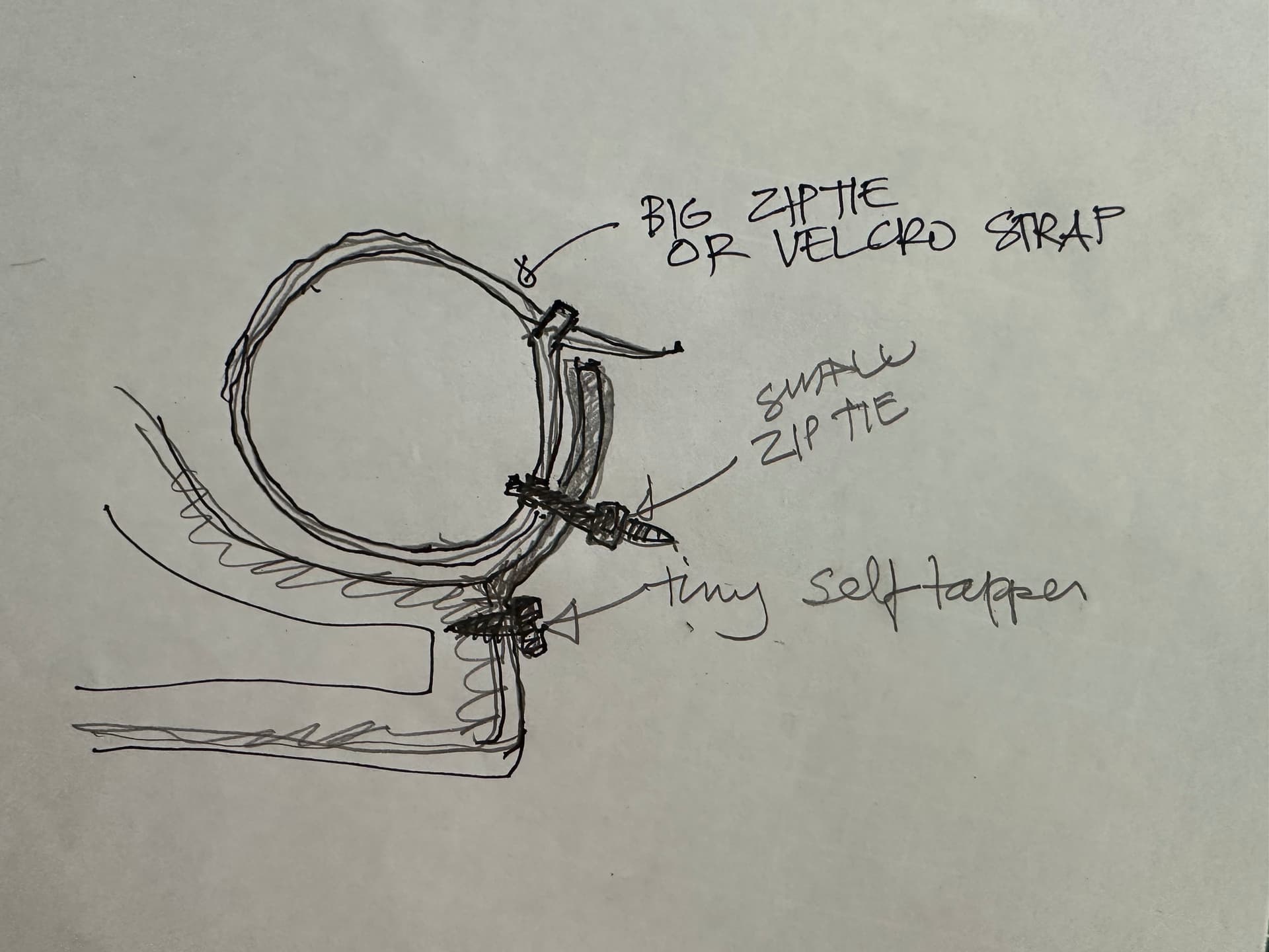

The answer is simple and one I use often - the old “why use one zip tie when you can use two” trick.
Run a zip tie around the brace upright thingy (sorry couldn’t be asred looking up the real name) with holding a large zip tie (I prefer velcro tape) parallel with the brace - instant parallel clip!
Sorry, midgecad is a bit shaky this morning!
Just a small self tapper will do the trick - you don’t need much at all.
