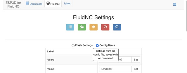

Is there a video guide on how to use Fluid nc auto square? Or in short, how to make your machine square without changing its endstops (it is within 1mm out of square as it is now). I am using the jackpot board

Ha ha ha Yes, it’s a bit important…Lowrider v4
Squaring it with fluidnc its a combination of the diagonal measurements and some edits to motor 0 and motor 1 pulloff under the y axis in the firmware
In the WebUI you can add to your Y axis pull-off distance to correct any skew. Scroll all the way down and hit save. Back on the main screen use the “Save” macro to make the changes stick after a re-boot. This is a little different on the UI V2 and V3, the important part is using the save macro.
