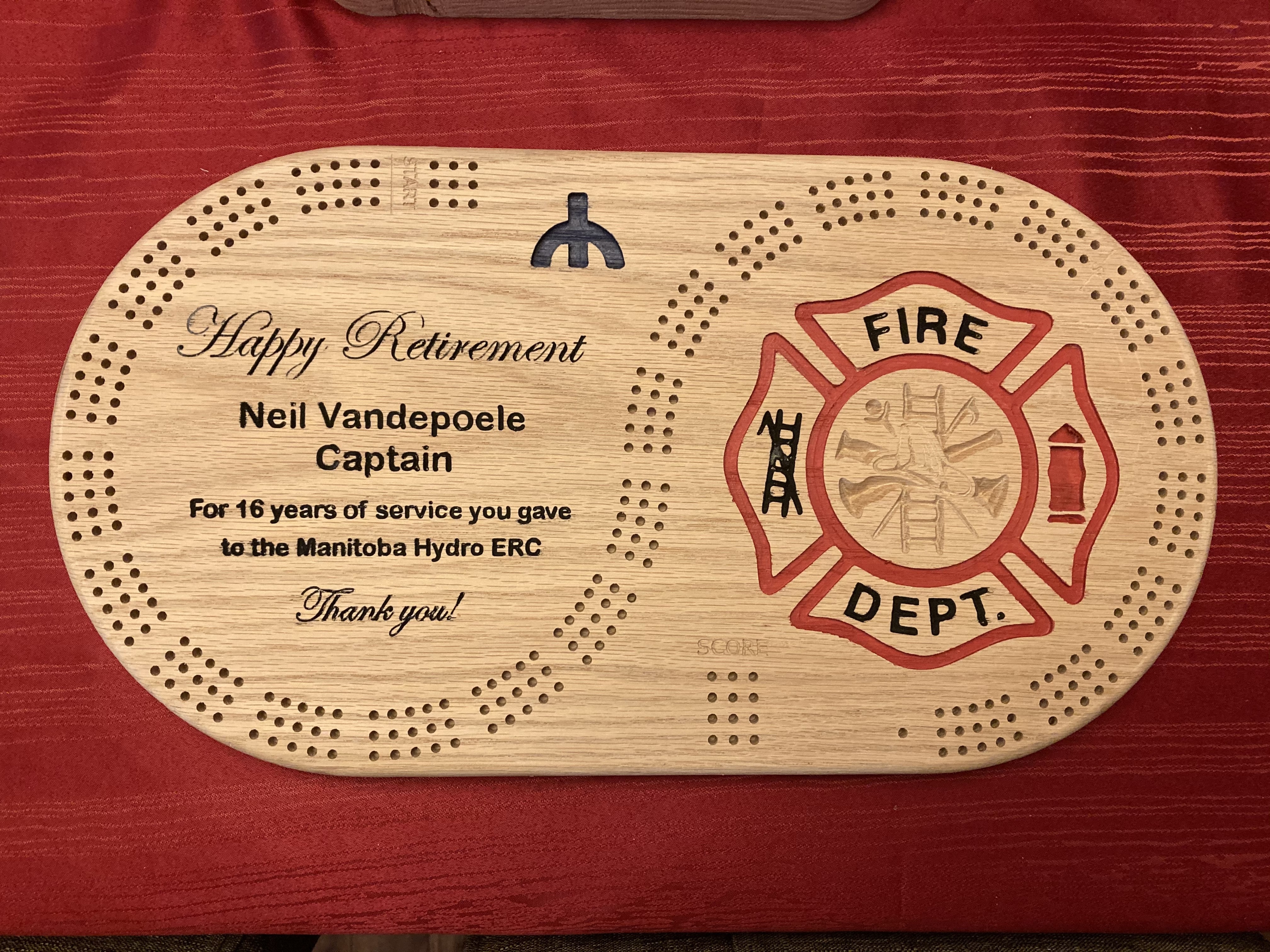

Made this one out of oak

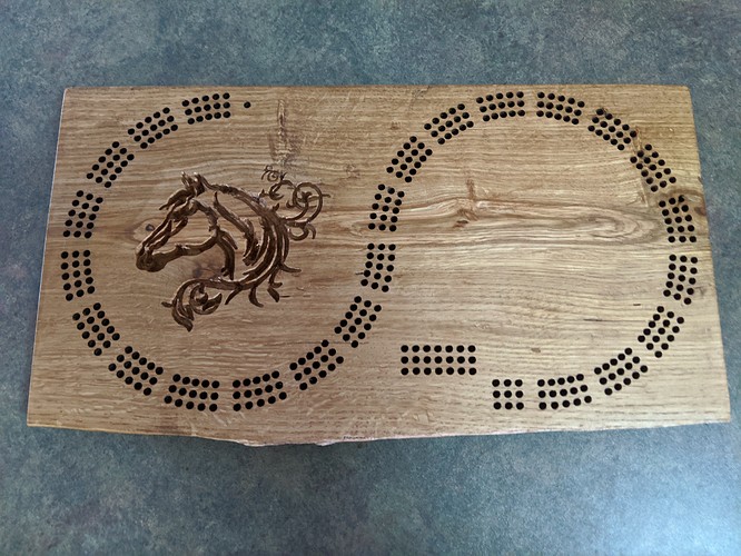

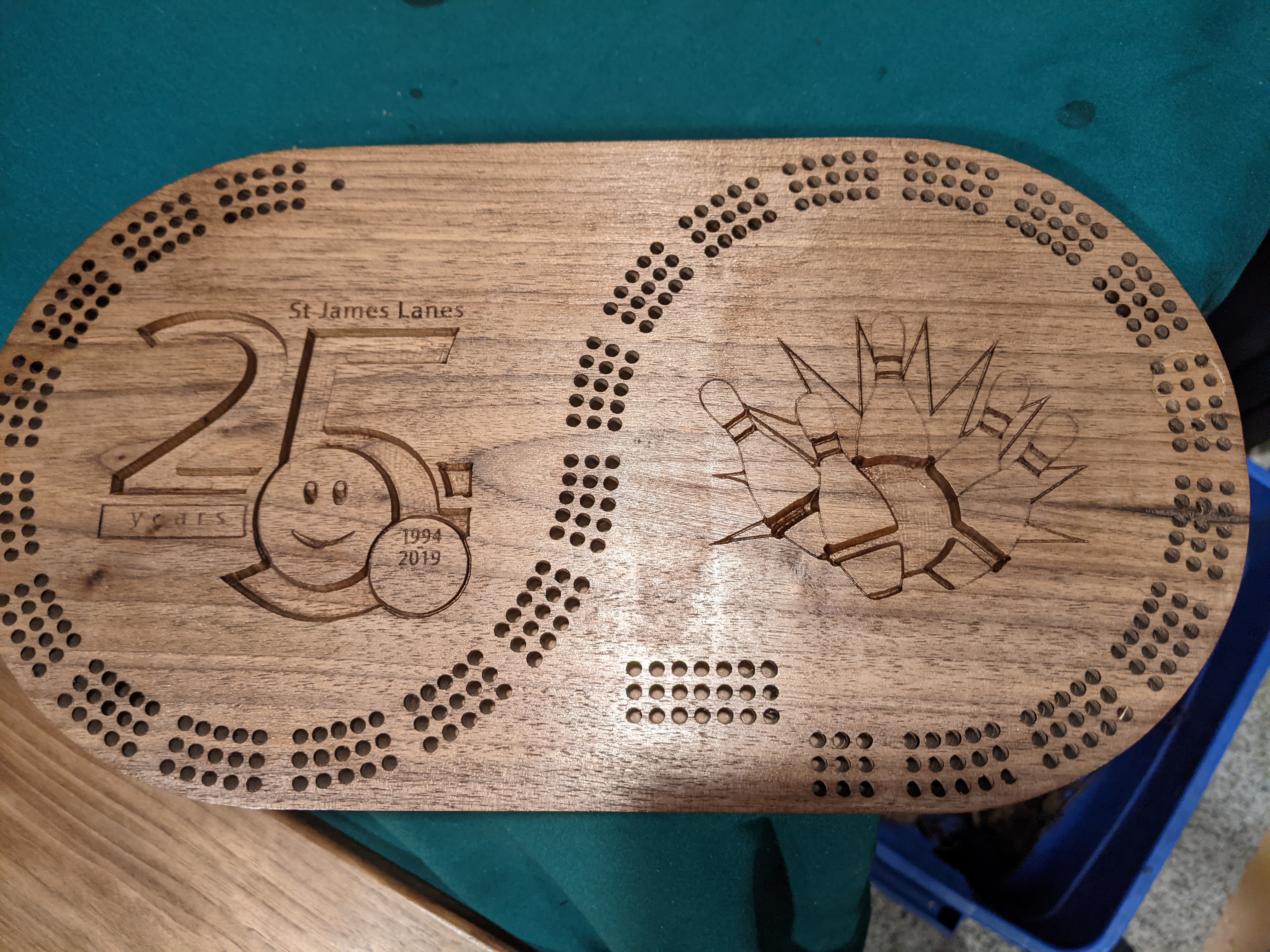

Very similar to mine, I use walnut mainly, but have done some oak too. A couple examples.

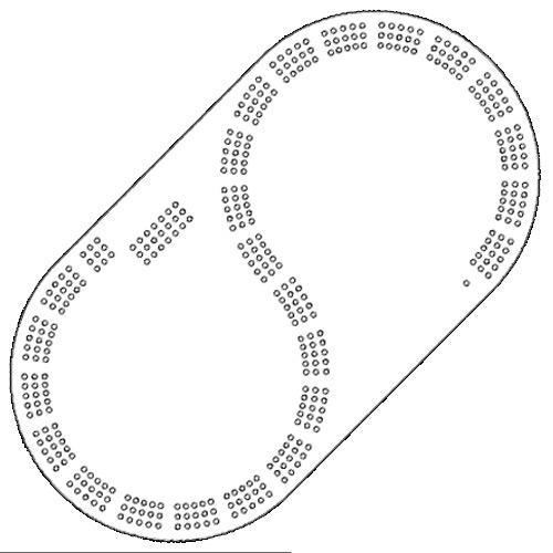

You don’t happen to have a file with the hole layout you could share do you? My CAD skills are pretty minimal and I just haven’t been able to get all the holes laid out nicely at all.
Thanks
Jon
I got it from here
Thanks for the pointer. I had never run across that site before. Lots of cool stuff there.
I was trying to do a custom board on a map of Manitoba but I gave up. It really isn’t easy to line up all the holes (with my limited experience). I found mine online somewhere as well. I added the start line, skunk line and score area. Here you go.
