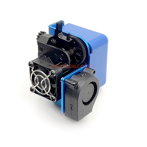

Phone rang and I walked away… this is what I came back to…

When you start to get a blob, the melted plastic tends to balloon in the sock rather than just oozing away
In my experience, with the sock you get more melted plastic, and higher up on the head, which causes the wires to get trapped
Cleaning the Heather block and nozzle is pretty easy, but those thin thermistor wires? :scream:
And even if you don’t break them cleaning it, they get all crispy and rigid :confused:
On my printer I have a whole spare printing head to switch to when this kind of things happen, while I cleanup everything
I have spare printers… but I don’t have an extra Hemera sitting around.
I got the blob off, but the silicone sock is pretty thoroughly turned into an injection mold at this point. Fortunately the wires were mostly spared.

Silicone grease is supposed to tolerste up to 300°C so maybe… but since in this case the problem is that the darn PLA won’t stick to the bed, I do not want to add grease into the equation. What happened here is that I finally got a first layer to stick, but looks like on the third layer, the nozzle picked up the entire print and started dragging it around the bed. I seem to have far fewer problems with PETg, this was with PLA, on a PEI coated spring steel plate. I can get it to stick to painter’s tape, but I don’t like the surface finish. The whole reason for the PEI sheet is so that I don’t need to deal with that.
I’ve scrubbed the PEI with amagic eraser, and I use 99% IPA on it regularly. PETg works fine, but PLA just doesn’t want to. Now I’ve used up my last magic eraser, so I have to go buy more…

I recently got the same blob you did. In my case, the extruder had gotten loose from the core so that it was dangling down. The hot end rubbing across the top of the part I was printing caused it to grab the part and the rest turned into a large booger like yours.
I was able to heat the nozzle to 170c and then peal the entire blob off the printer.

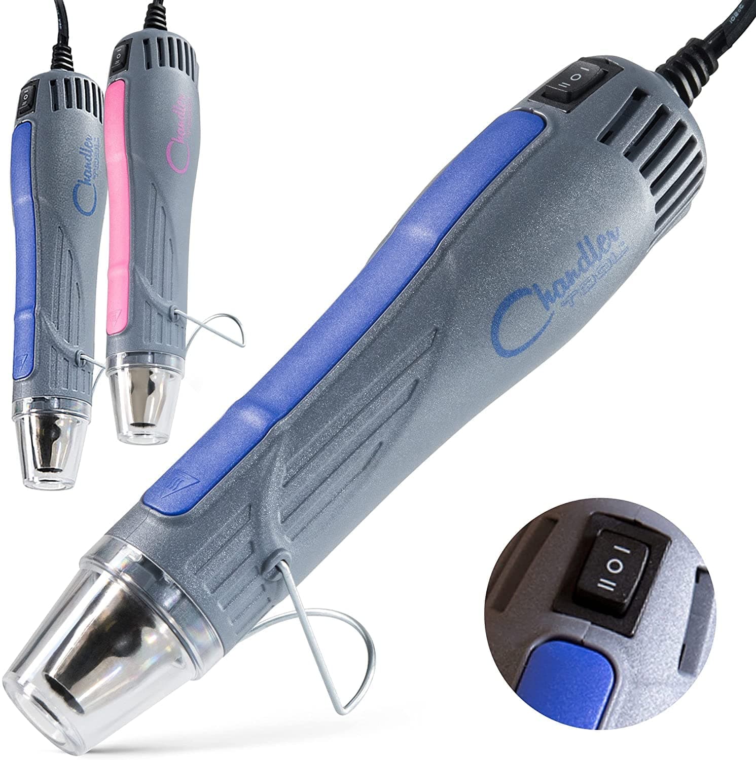

Embossing heat gun:
Best tool to clean up those things and setup nozzles, surprisingly useful :slight_smile:
