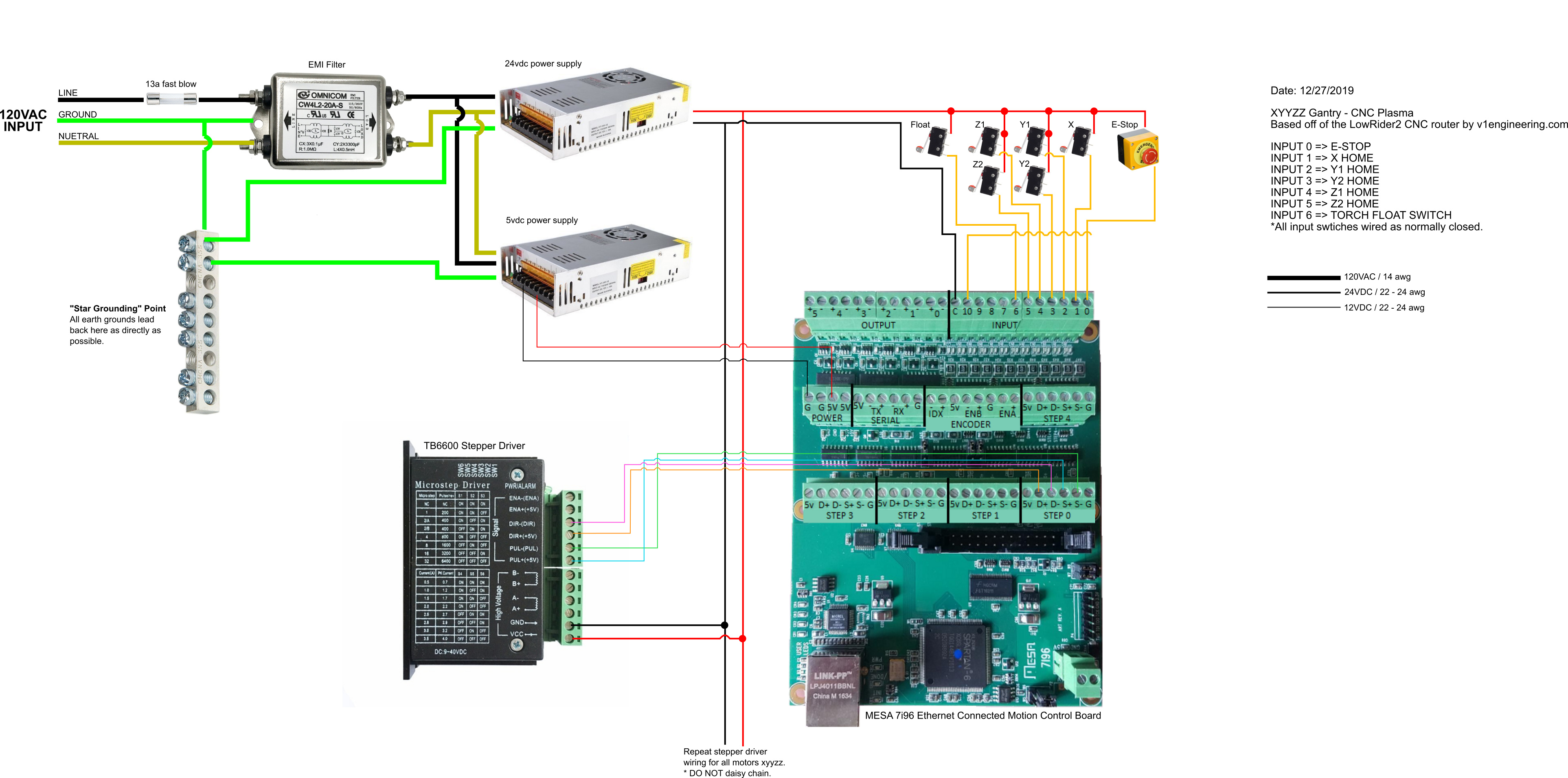

Yeah I planned on using them as homing only, no limits. I’ve just settled on how I’ll mount all of them, none of them will be mounted on the gantry anyway, they will all be attached to the table… Except for the float switch. The 2 y and z switches will be triggered by adjustable set screws that are attached to the gantry. I don’t figure the x needs any adjustability.
I’m using 24v logic with shielded wire also. I’m going to try using all mechanical switches for now.
Here’s the wiring diagram I’m working on:
