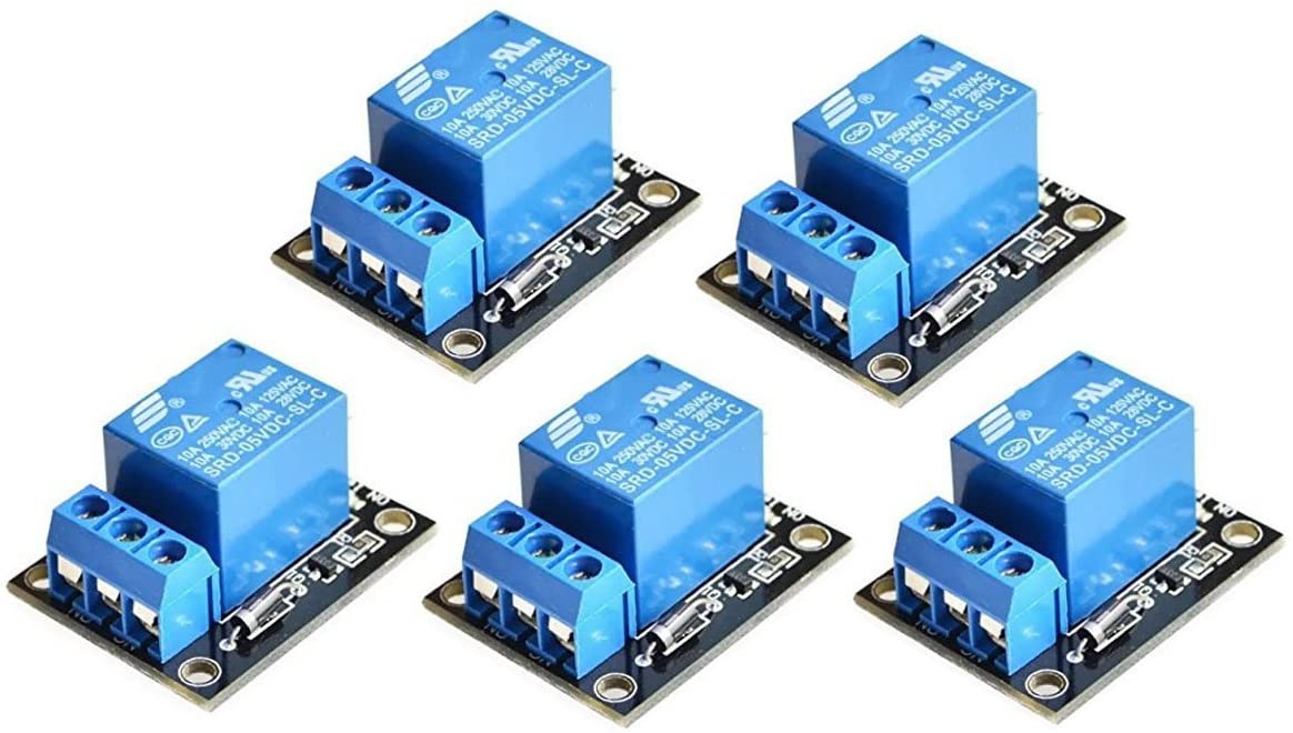

What relay is it? Most relay boards use a 5V in for power and just a 5V signal for control. A plain old relay needs some surrounding bits (a transistor and a diode, at least) to use.
Something like these:
But if you search for “Arduino relay”, you usually get a lot of good cheap choices. You would connect the output from Bob to the signal pin and 5V and ground from the power supply.

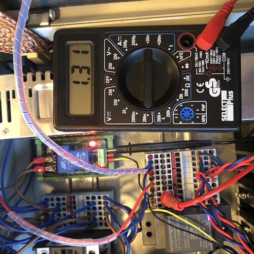

That should take basically zero amps on the signal. You can confirm with a multimeter. My guess is the bob isn’t actually toggling that pin. I would test these things:
  1. Using the voltage meter setting (make sure your leads are in the right place), does the bob output 5V and 0V, relative to the same ground used on the relay? Measure from the bob output to the ground on the relay.
  2. Using the current setting (make sure your leads are in the right place), how much current goes from the power supply to the signal input when it is turned on? It should be very small, 1mA or less. Remember to put your leads back on the voltage side :slight_smile:
Oke what I did is, put the multimeter between the 5V power supply and the ‘IN’ on the relay. The relay triggers and the reading I got when I put the switch on 20m, is 1.3. So this means the IN pin draws 1.3 mA right?
Yeah. That should be small enough for any output.
