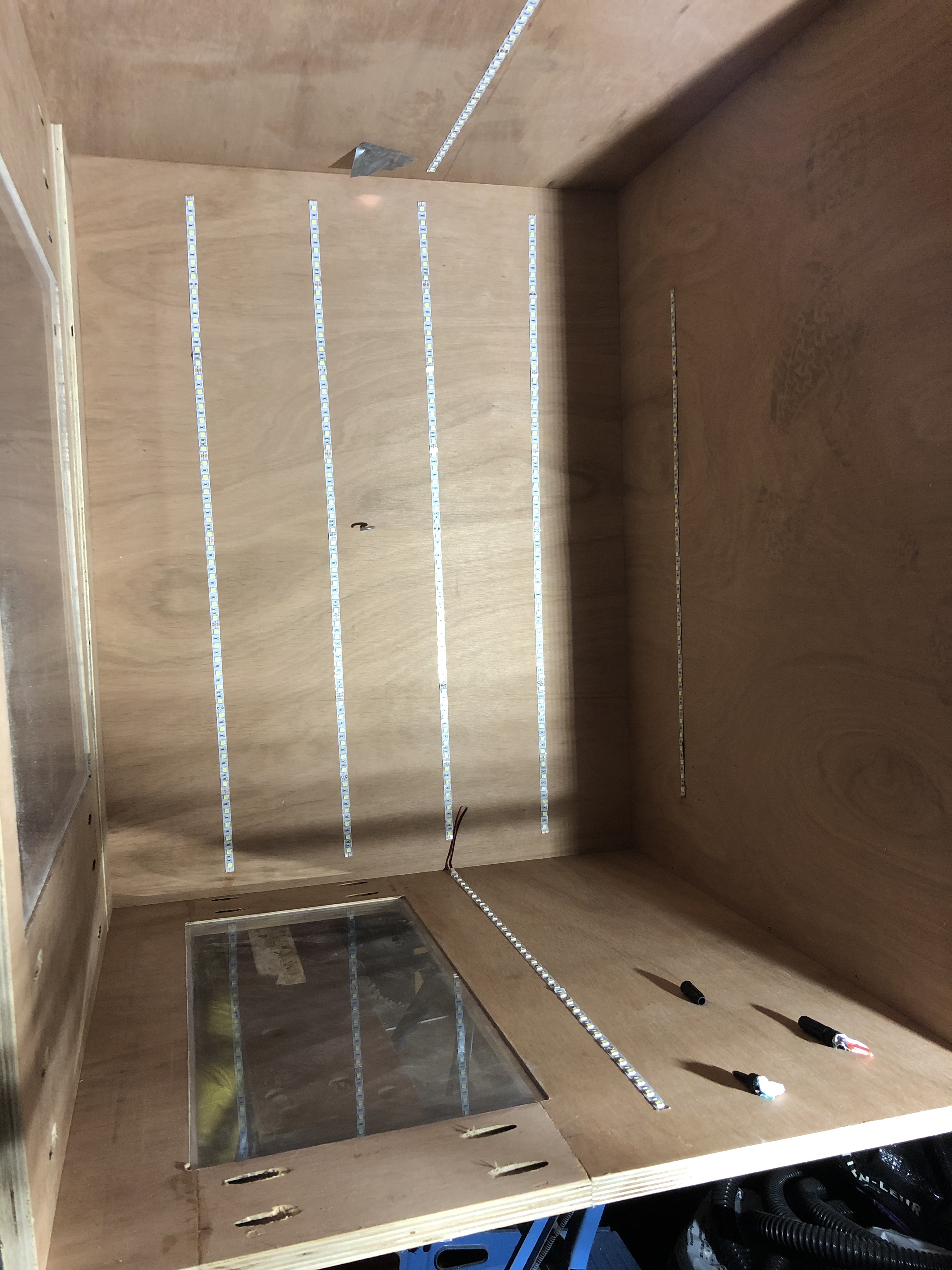

Oké I received my LED strip, I cut it in pieces and sticked them inside my enclosure.
Now my question is, do I need to connect them from start to end… or can I start in the middle (I think yes, but just want to be sure). I want tot connect them by soldering with wires.
In the photo, the enclosure is on the side… so at the top off the photo where the strip is going out side the photo, that’s going to be the start ( from the power supply)
Then going down I’m in the middle, 2 strips right, 2 strips left and 1 at the bottom.
So do I need to go far right and go left, or can I go right and left at the same time.
I hope my question makes sense…

I think in this situation it’s entirely up to you and the materials you can source and or have access to.
I did one long strip and just folded it to make 90 degree turns where I need.
I think I know how to do it… I will wire them in series. BTW nice build
