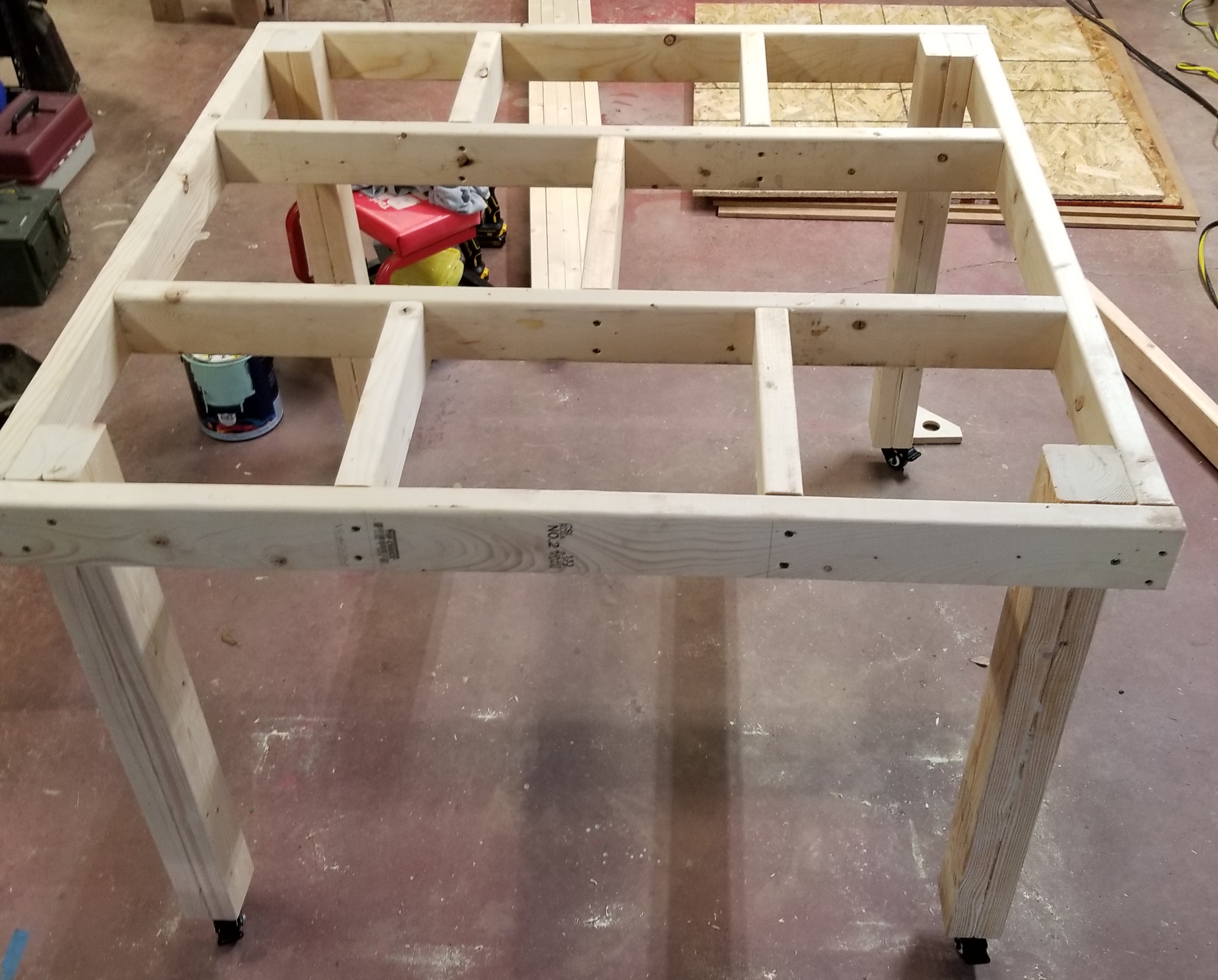

Got the table together. Going to add a sheet of osb then 1/2 MDF to the top. Not sure what I am going to do with the space underneath yet

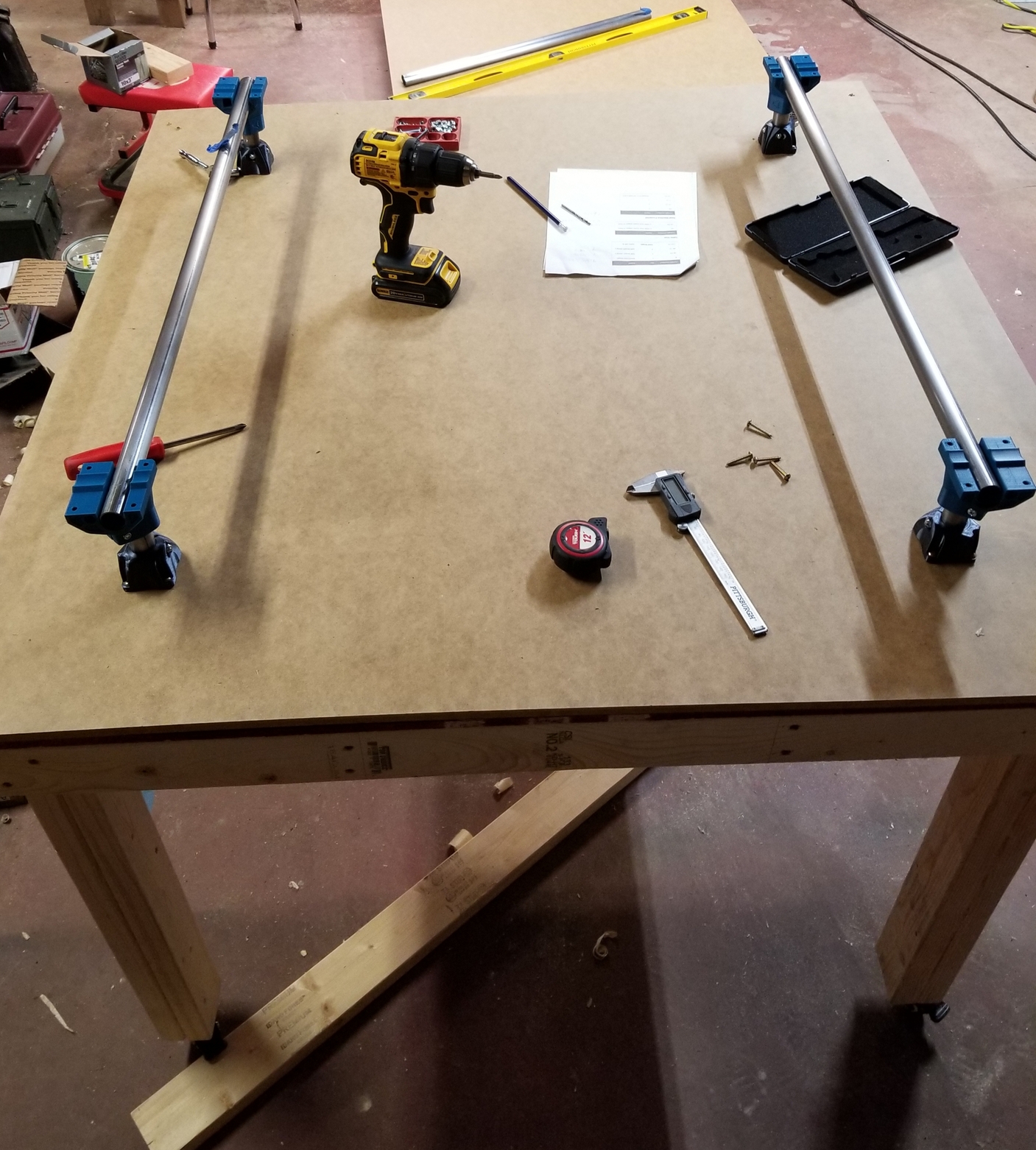

All squared up, I measured diagonally probably like a hundred times every time I tightened something :rofl: It is spot on however my one corner is off like .90mm from the opposite corner and sitting kind of funny will have to try adjusting it some may need to check the pipe it may have a little lip on it or just need a little wiggling.

Sorry for the lack of update have gotten it all together last week. Up and running with the test crown.

  • install a spoil board. Thinking about lamenating two 1/2 pieces of MDF together.

My mpcnc spoil board is two half inch mdf boards just screwed at the corners, no glue. The bottom one just raises the real spoilboard up. I countersunk the screws, cuase I tend to try to cut them otherwise…
