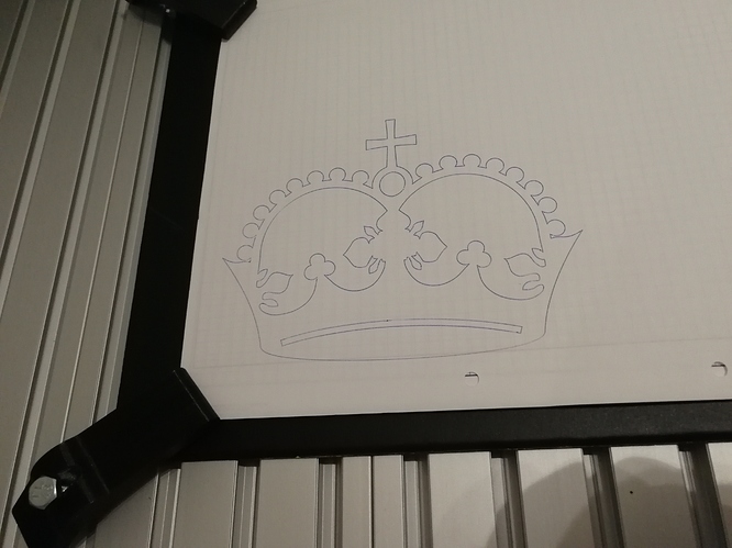

Finally yesterday evening the crown test was successfully completed:
Right before I noticed that all my end stop triggers were broken as the screws were overtightened. Have to modify those parts a bit and print them again.
However I was not able to home the axis with the dual end stops, move the pen to the new origin of the paper sheet and reset the origin to that new position.
I thought that should be possible?!
