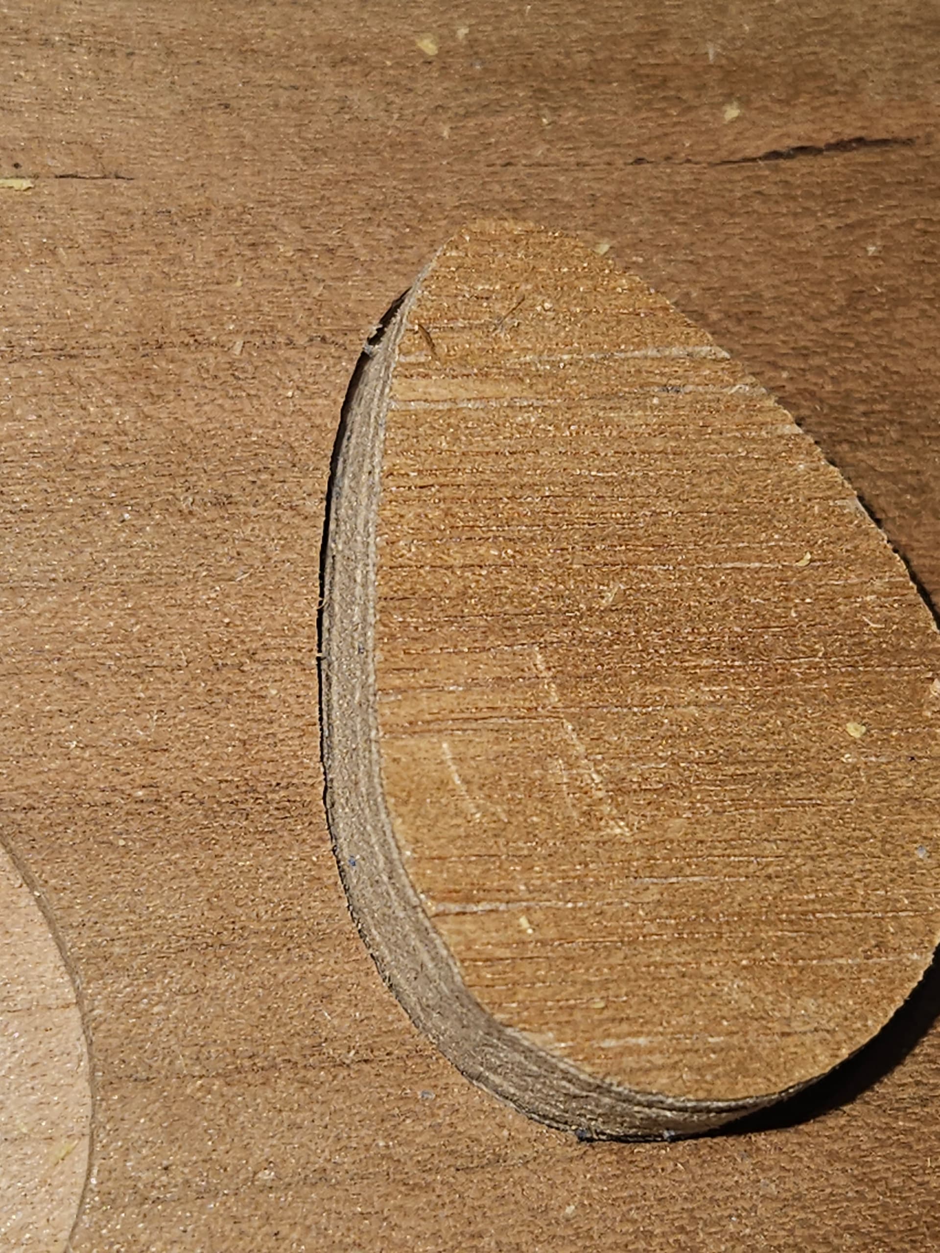

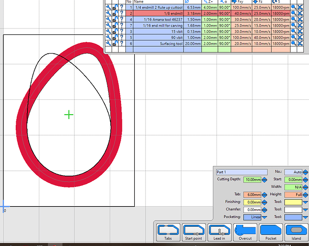

I am still trying to get an inlay to work without success. I decided to go back and start simple.

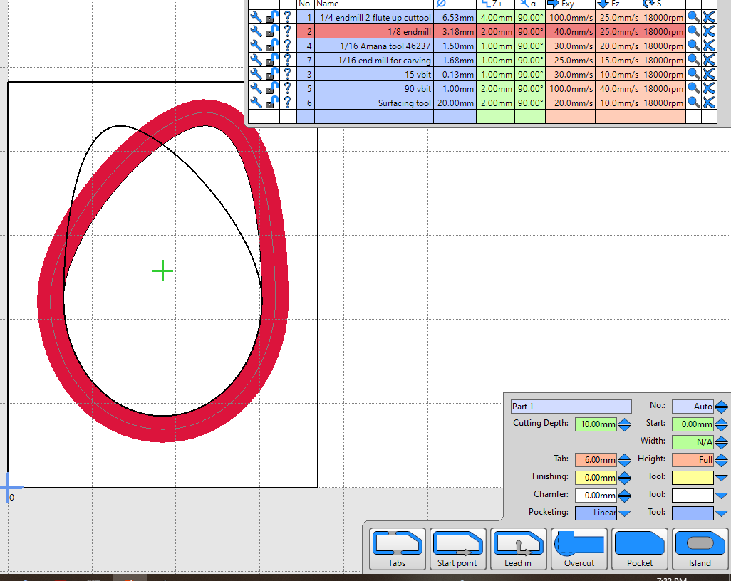

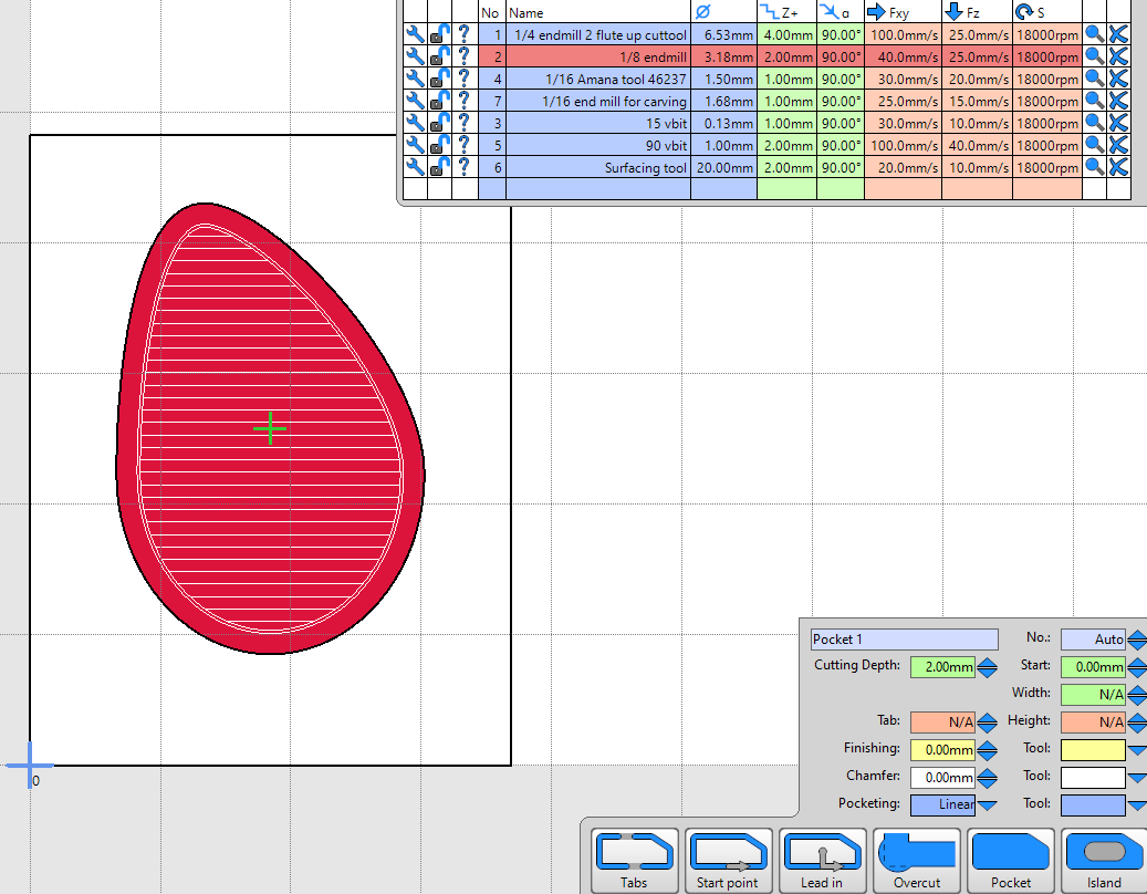

Here is an egg shape that I pocketed and then parted another to fit together. Straight bit no carving. the image is 1 in x 1.5, I know its small. There is the slightest gap along the upper left side but npot much. I put no finish allowance in the cut. I expected it to be really tight but it’s close but not tight. My question is, is that within the +/- of the machine/bit or do I need to make an adjustment.
Here is the estlcam:
I’ll post a pic off the gap from my phone.
Is maybe not the best angle, but you can see it on the upper left.
To get good accuracy, it is recommended that you use a finishing pass.
I would try to cut out a 100mm square or similar and see how close to ‘on dimension’ you are. If you cut it in both directions (one clockwise, one counter-clockwise) and they come out different, you know you’ve got deflection during cutting.
Having a finishing pass at ~10-20% cutter width helps a lot with that, assuming that it’s not deflecting more than that on the main pass.

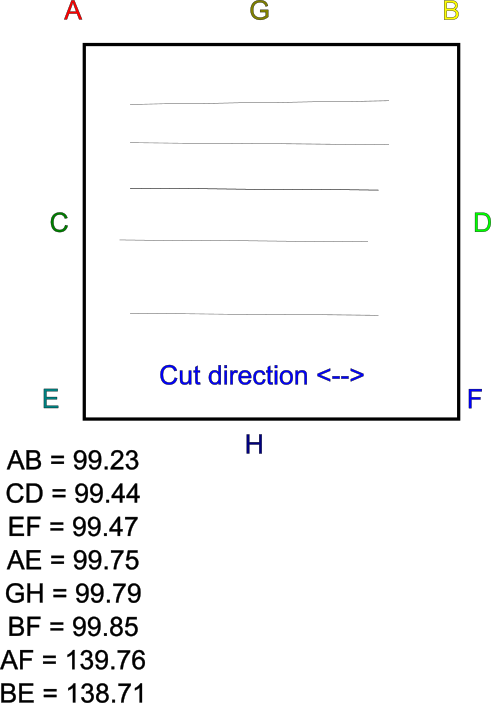

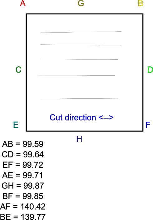

Here’s first 100mm box with measurements:
Nice, looks pretty reasonable. Was that cut clockwise or counterclockwise? Also, was that using a finishing pass? For this test, a finishing pass would mess up the results.

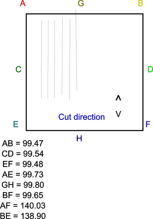

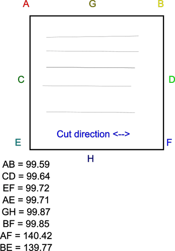

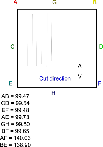

The cut did include a finishing pass. Linear cut in X axis and the linear cut in the Y. I managed to get the homing on X axis to work so I repeated the process here are last results.

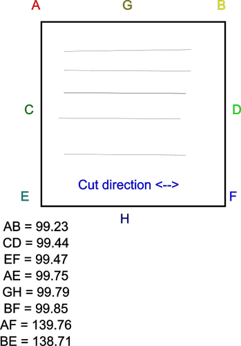

So I cut out the 100mm squares. The climb was almost spot on ranging from 100.12 to 100.25 and the diagonals were 0.05mm dif.
The conventional was 98.32 to 99.47 and diagonals were off about 1mm.
Now that is definitely an interesting result… Perhaps try stick a pen on the machine and see what it traces for a 100mm x 100mm square?
Ideally, you should see the machine trace a 100x100 square with the diagonals the same, then cut something like a 101mm x 101mm square using climb milling and a 99mm x 99mm square using conventional milling, which would indicate that you’ve got ~1mm of tool deflection under load.
Having it be different in the 2 axes isn’t surprising, now that I think about it. I’m a little more used to the MPCNC which is symmetric but the LR4 isn’t, so presumably that stiffness is when it’s trying to rotate the core around the Y axis, rather than pull the core away from the rail by rotating around the X axis.
The diagonals being different is a little confusing, although that could just be an effect of the deflection being more in one way than the other.
So looking at that, I’d assume it’s maybe drawing a 99mm x 100mm square with the diagonals off by about 0.5mm as normal. Either way, I think that looks like it should be solvable by doing either a 1mm finishing pass or 2x 0.5mm finishing passes.
You could also try slowing down the cutting a little and seeing if that leaves you with less finishing to do, which may be faster overall.

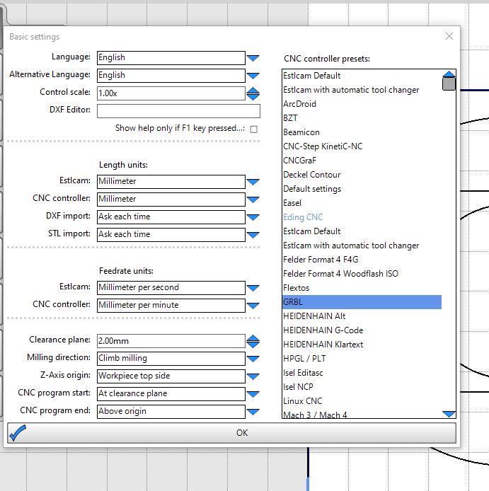

Maybe its a settings issue. I mostly use Estlcam
