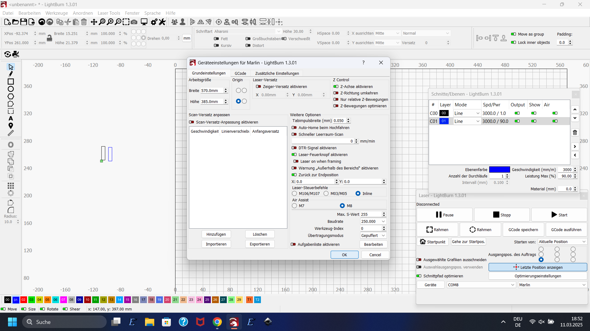

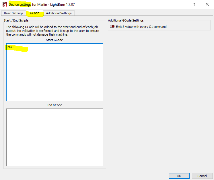

As you’ve tried, the M3 I needs to be put at the top of the finished g-code file. You can have it inserted automatically. In lightburn, you want Device Settings/GCode in the Start text box, enter M3 I.
Note that M3 I only works if you have your output set to Inline
Good morning! I’ve entered everything into Lightburn and created the g-code. The laser switched on correctly but unfortunately always at 100%. When the code is finished the laser stays at 100%? When I plug everything in and start up the board and laser the laser immediately switches to 100% and stays on, but if I briefly unplug the 2-pin supply cable to pin pc9 it stays off? By chance I hit a metal on the outside of the laser housing and the laser immediately switched to 100%? Do I have a grounding problem? What am I doing wrong? Thanks for your help Gerhard

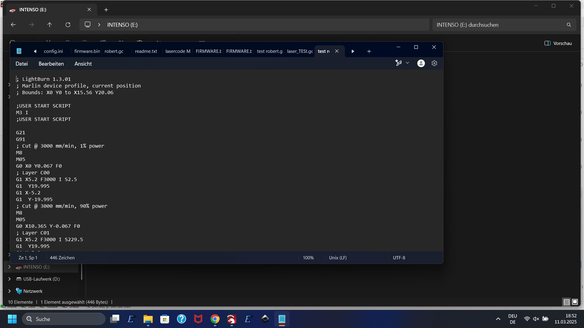

First, I’d like to check your g-code file. Use the upload icon in the ribbon of tools and attach a copy of your Lightburn generate g-code file to a post. The icon looks like this:
Beyond that, we need to check what that pin is doing using a multimeter. As mentioned before, a couple of wires with Dupont connections make checking pins safer.
The multimeter will allow us to check if the issue is the SKR Pro pin or the issue is in the laser. If the issue is the pin, you will need to find another PWM pin and make new firmware.
pin Pc9 I measured 1.9V Thanks for your patience
; LightBurn 1.3.01
; Marlin device profile, current position
; Bounds: X0 Y0 to X15.56 Y20.06
;USER START SCRIPT
M3 I
;USER START SCRIPT
G21
G91
; Cut @ 3000 mm/min, 1% power
M8
M05
G0 X0 Y0.067 F0
; Layer C00
G1 X5.2 F3000 I S2.5
G1  Y19.995
G1 X-5.2
G1  Y-19.995
; Cut @ 3000 mm/min, 90% power
M8
M05
G0 X10.365 Y-0.067 F0
; Layer C01
G1 X5.2 F3000 I S229.5
G1  Y19.995
G1 X-5.2
G1  Y-19.995
M9
M05
; return to starting pos
G0 X-10.365 Y0 F0

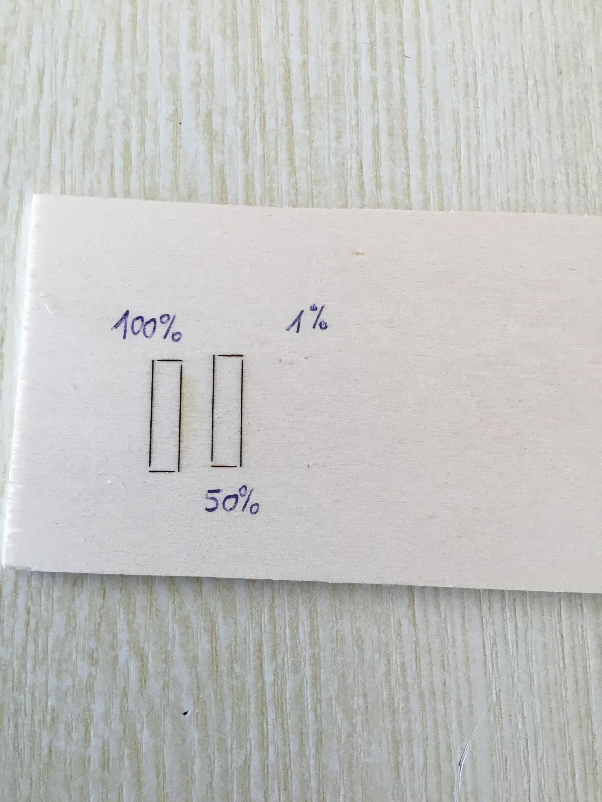

So now I’ve probably done it right: 100% approx. 3.3 volts, 50% approx. 1.6 volts, 1% approx. 0.7 volts on the multimeter. I then put everything together and ran it through on the machine, including the laser, switching the laser on at the beginning and then off properly at the end. Unfortunately, the rectangles aren’t connected correctly? I’m already happy about this small step :pray:
How or what do I need to change or configure so that the lines line up exactly when lasering? What else do I need to change so that it works in Marlin mode? I can switch to Marlin, but no cards or USB are recognized? :pray::pray::pray::pray:Thank you.
I’m not sure about the lines not connecting. I’ve seen this behavior with M03/M05 for control, but the problem has always been solved by using inline commands. The g-code you posted uses inline commands.
It is possible there is a mechanical issue with your machine. Try the same rectangle at lower power and much slower speed and see if that changing anything.

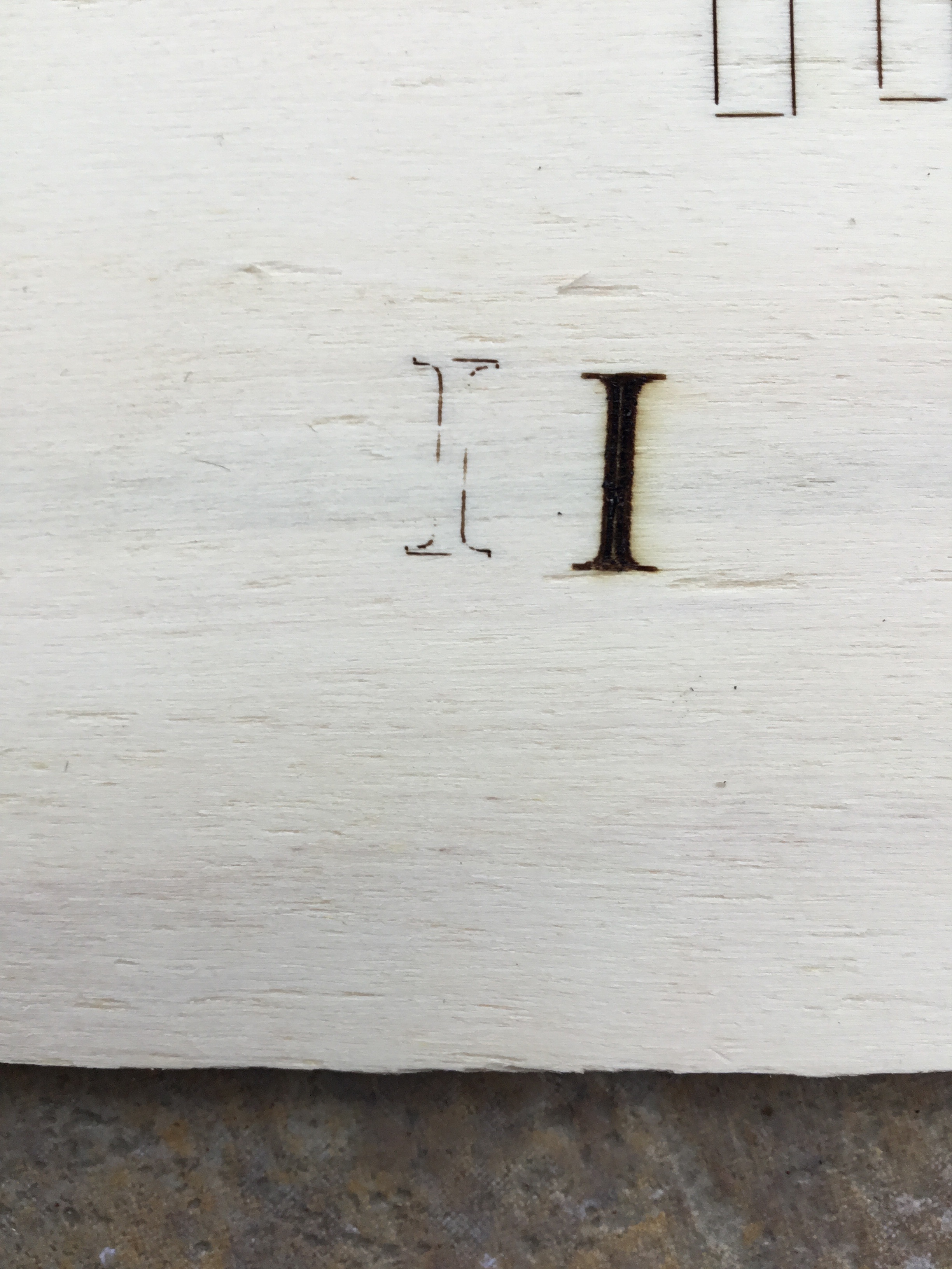

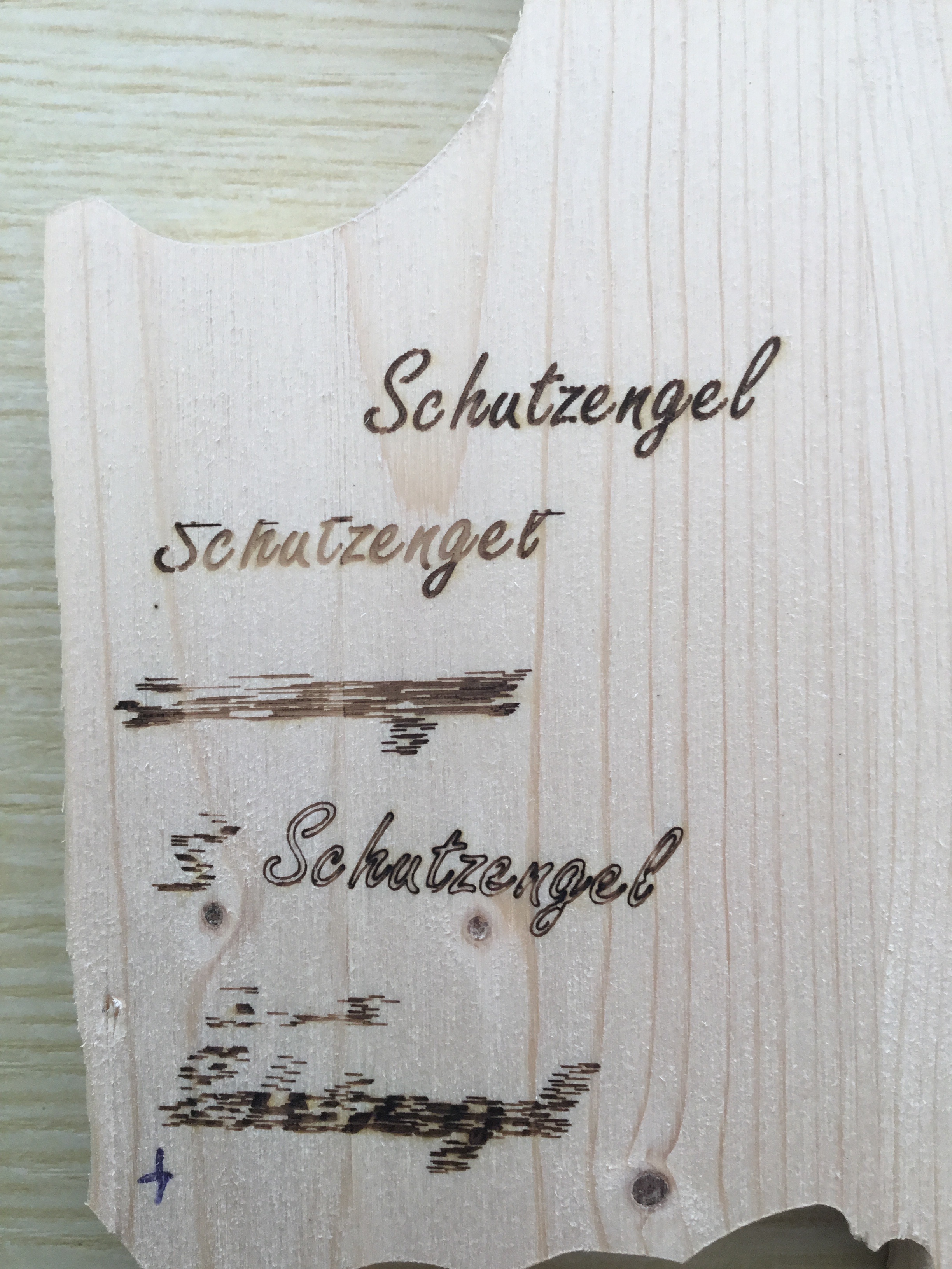

Thanks Robert for your great help! Same thing with slow movement! I tried filling with 3000 rpm 40%, if you enlarge the photo you can see the inaccuracy of the laser! The laser also makes a different noise when lasering than before the problem? Could this possibly be caused by the PWM frequency? I’ve read a lot on the internet and in forums but haven’t found a clear solution! I also tried something with the router with good success!! The mechanics should be fine! Perhaps you can find a solution with your great general knowledge :+1::+1: Thanks Robert Regards Gerhard

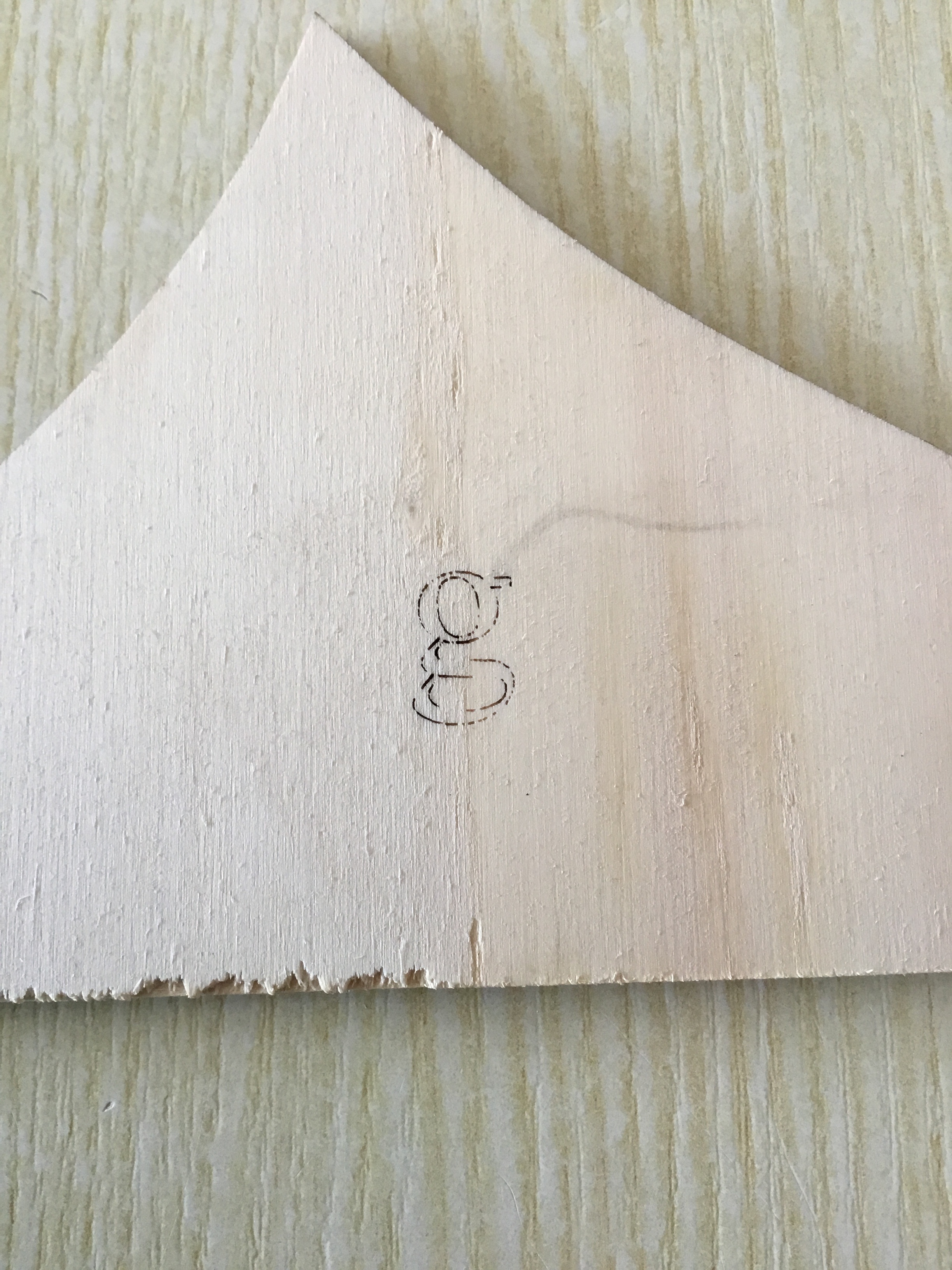

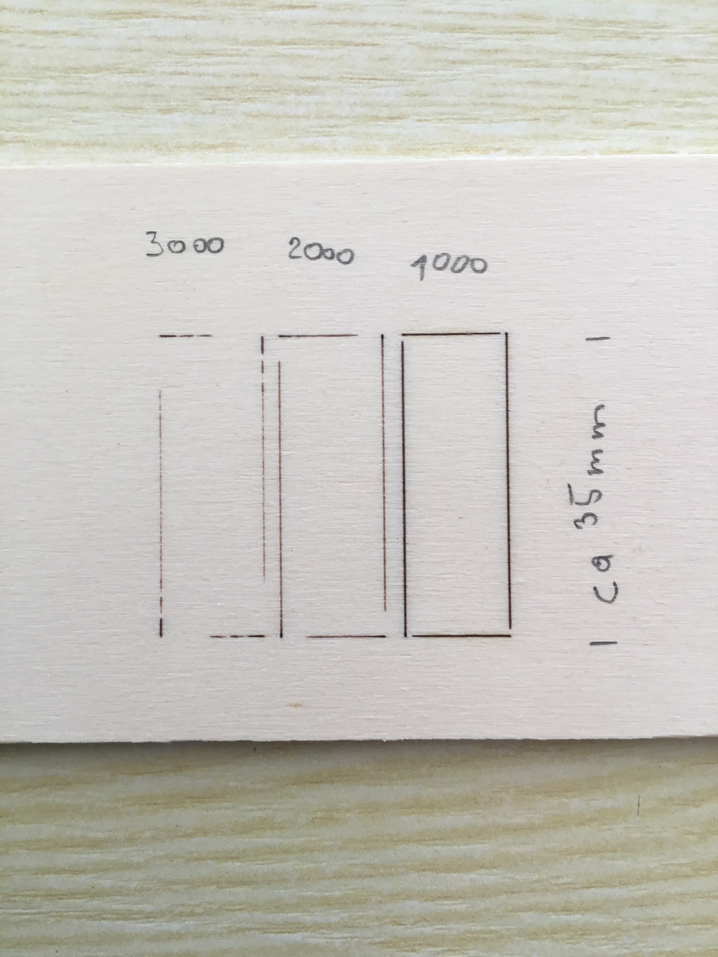

Hello everyone! A few things have improved: the micro SD card now works on board in Marlin mode on the display, but unfortunately the current firmware no longer supports them! In touch mode, both work on the display. I wrote something in Lightburn and lasered it; the settings for both types of fill and lines were 3000 rpm at 40% power. It could be better, but it’s a small step forward.
When I want to laser a rectangle, it looks different. The laser is running clockwise, with settings of 3000/2000/1000 rpm and 40% power. The faster it goes, the sooner it switches off. Does anyone have any idea what’s going wrong? Thanks for your help. :pray::pray: Regards, Gerhard
I’ve thought a bit about your problem. When laser cutting and engraving, the CNC has to decelerate as it comes into corners, and then it has to accelerate back up after the turn. With inline commands, the firmware knows it is dealing with a laser and it moderates the laser output as it slows to make a corner turn, then turns the laser back up as it accelerates on its new course. It is possible there is something going wrong with the PWM signal to the laser or the way the laser is processing the PWM signal. If so, you might have:

Hello Robert and Jim! Thanks for your help! We (Michael and I) got the machine running again! Michael found an old Marlin firmware from March 2021 that I was using back then, and now everything’s working perfectly again! I use pin Pc9 for the laser. I’ll attach the firmware below; maybe someone with a similar problem can use it! Thanks for your valuable time. Regards, Gerhard
firmware.zip (113.4 KB)
I’m glad you got it fixed, though I’m puzzled by the fix. Lots of people use V1’s latest firmware with NEJE lasers without issues.
If you get a chance, post one of your laser projects to the forum.
Hi Robert, yes, that’s really amazing. I installed the old firmware and removed the M3 I from the start code in Lightburn and created the G-code in Inline, and everything worked as usual again :thinking::thinking::+1::+1: . The good thing is that the SD cards on the display work perfectly again in Marlin mode; the micro SD cards on board were too fiddly anyway :joy: . Yes, I’ll post a few finished parts in the forum. Greetings from Austria
