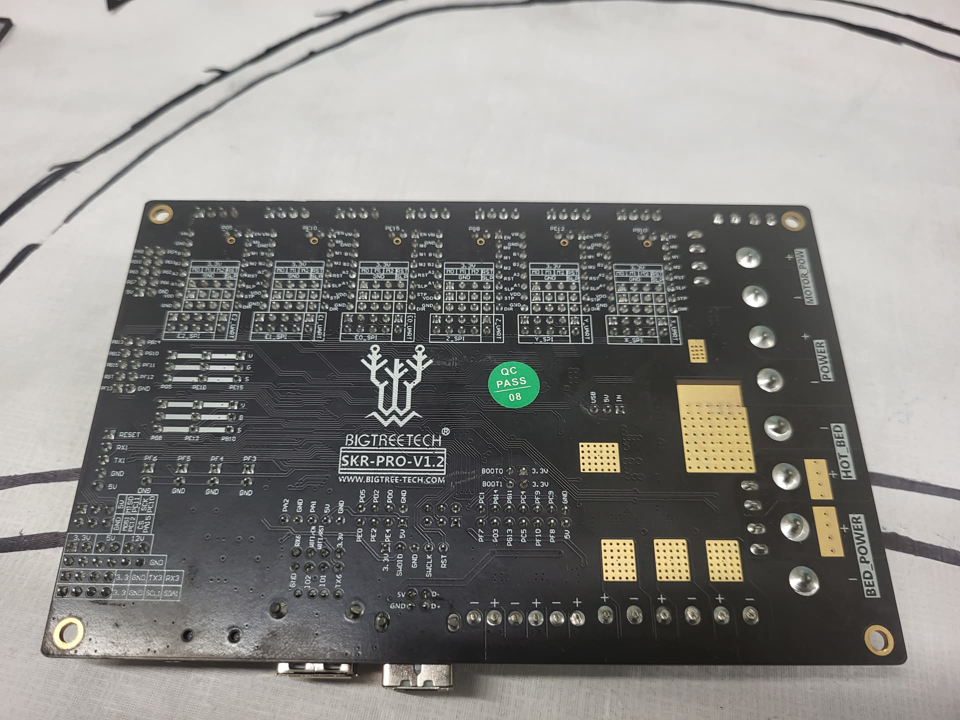

Pictures from the back would have been good I guess. @hhubred You could also wait for the new board. :slightly_smiling_face:
Here you go.
I am really not good at soldering, but I can’t see a bad solder. Maybe one of the others can. :sweat_smile:

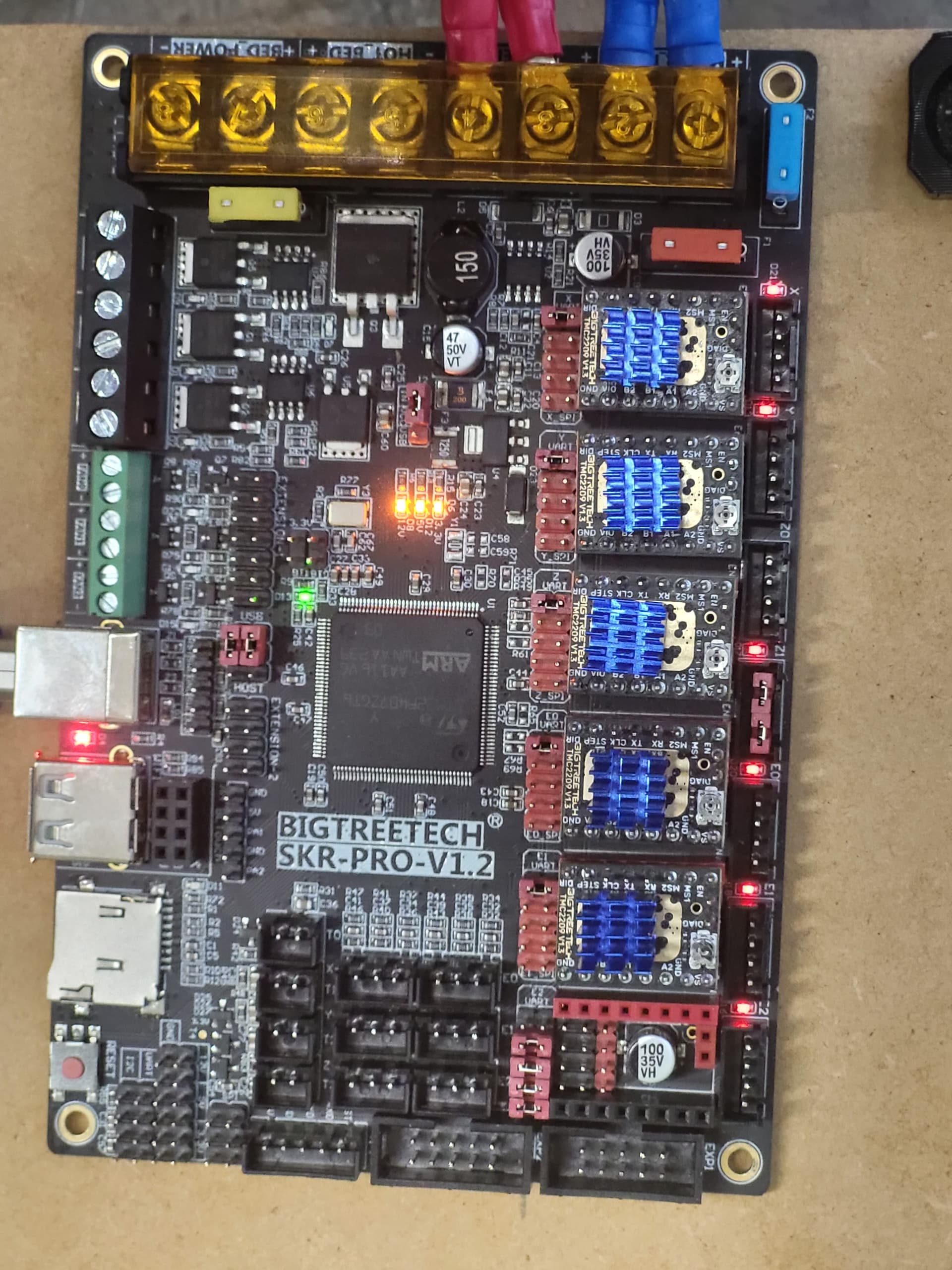

My last tid-bit for the day.
Note the light that is out next to Z0 label.
Also note the pins for Z0. The first pin is black as night. Or at least not silver like the others.
The SKR Pro doesnt have a light next to the Z0 label.
There are 6 drivers, and 6 end stops. Each endstop has an indicator LED that is supposed to come on when the stop is at logic high. (This does sometimes cause problems as well on this board.) It is only for the end stops, and reflects nothing about the actual driver. It is somewhat misleading to put the lights next to the motors, at least with V1 firmware. For example, the E0 motor driver might be running the Y2 motor, but the E0 stop manages Z2 on the LR. The E1 driver manages Z2, and the E1 stop is Y2. The E2 motor is unused, and the E2 stop is Z1…
The blackened pin might be trouble, that could indicate a poor connection that is arcing. That can cause missed steps on that channel. BTW that looks like the Y channel to me, not the Z0.
Your correct, Y has the burnt pin.

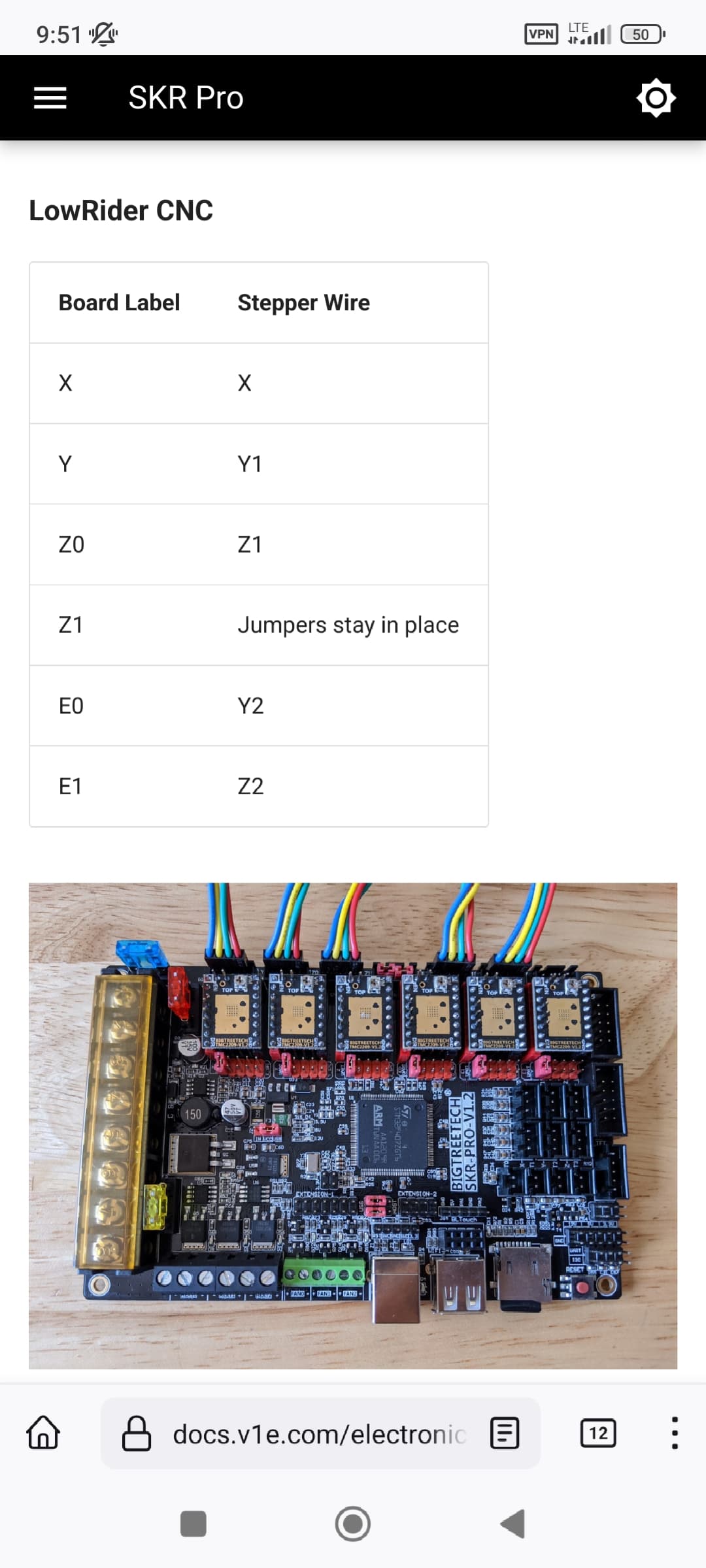

Also, as far as I know, the drivers are at the wrong places. One of those in the middle has to be empty.
As far as Stepper Motor Drivers. Slot 6 (E2) is empty (Its not used in Lowrider3). If you referring to the actual Board connection that goes out to the actual Stepper motor themselves. Then EO in the middle is empty and has a jumper. As per the setup documentation.
Okay, wasn’t sure since I use another board. Sorry I couldn’t be of more help. :pensive:
No, that is correct. The empty motor wire connector is the second Z Port, which is wires in series on the SKR Pro. (It has the jumpers on it to short the pins. No jumpers, and the motor does not turn.)
That is actually the Z1 port. The labels are on the other side. Starting at the power connectors they are X, Y, Z0, Z1, E0, E1, E2.

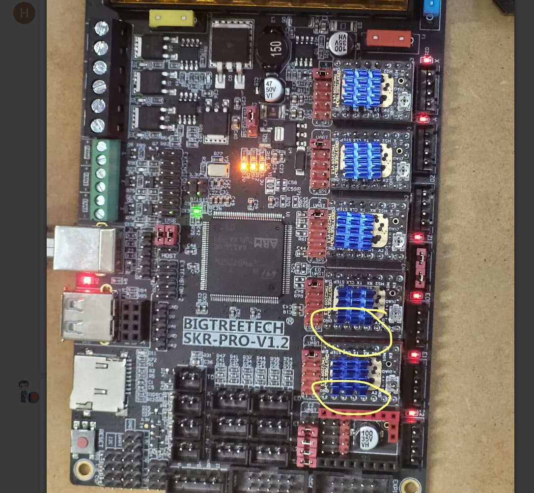

When you are booted up in the terminal type in M119 and show us the output please. That will help confirm what firmware you have.

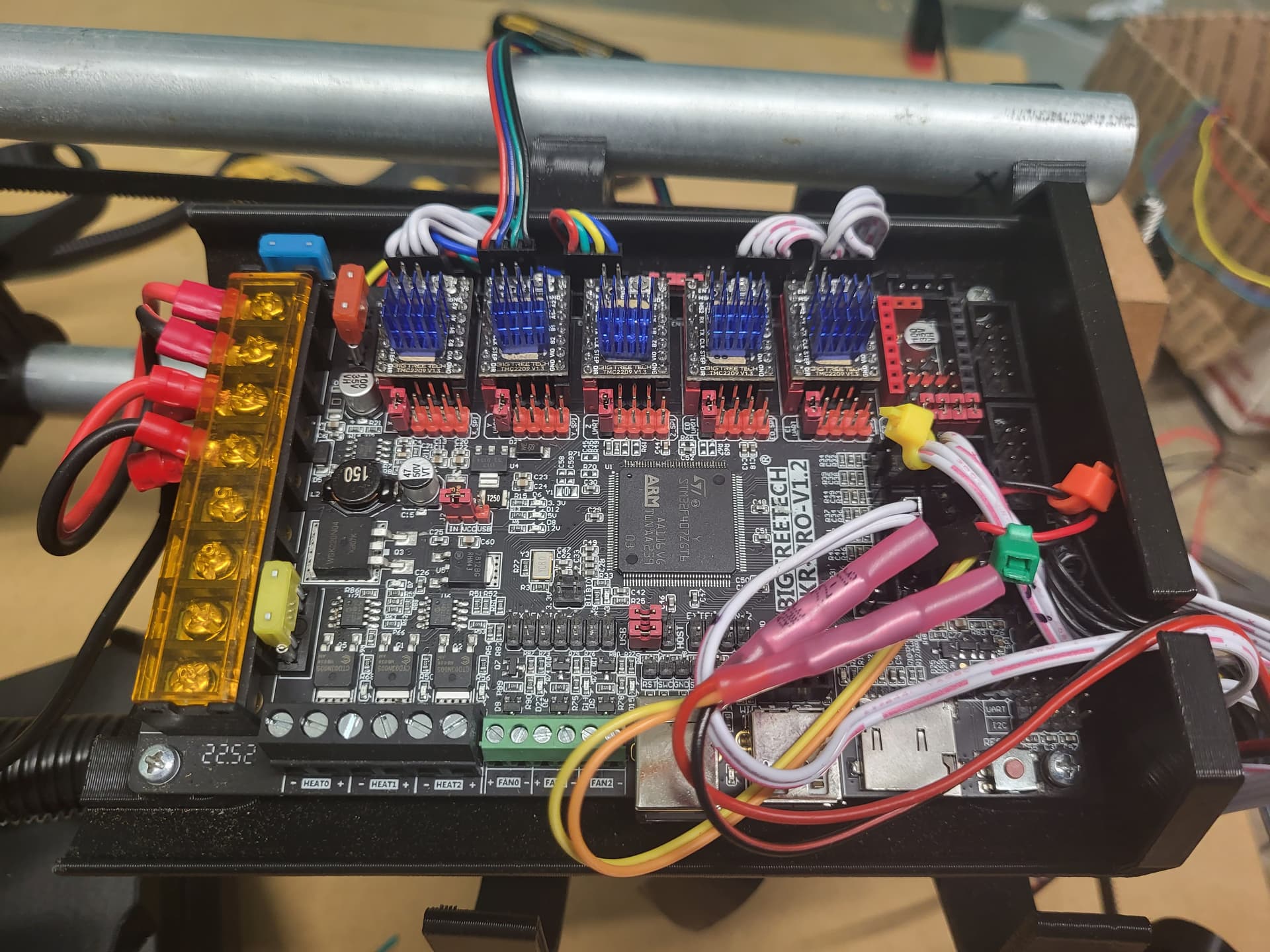

I know the heatsinks have a bit of room but are they touching the pins?
Just to be safe you should remove these as well I am not sure how the SPI and UART work but I have always removed these to match the others.
