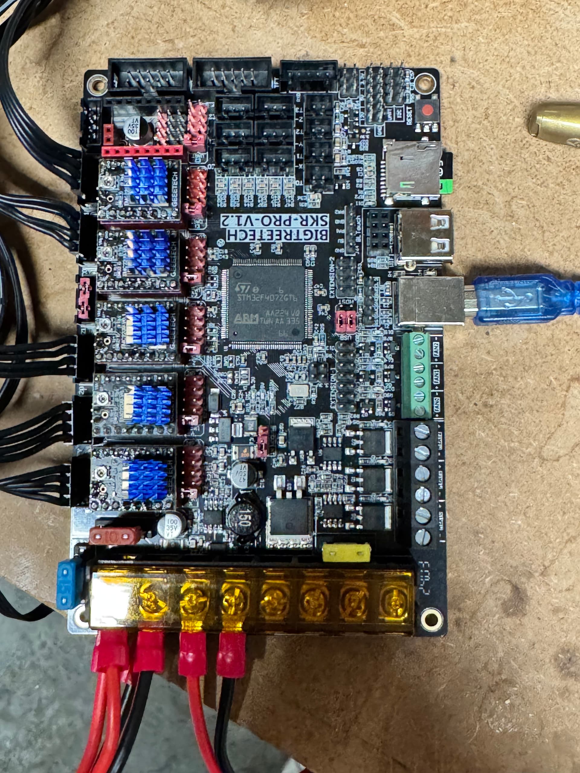

The power supply is wired to 1&2, then 1&3 and 2&4 are connected. The stepper motors are wired the way that the documentation recommends. I need to find connectors for the endstops so for now I was just using the firmware.bin file that doesn’t use them. When I plug the power supply into the wall no lights turn on. The red light (D4) just above the port with the blue wire in that photo turns on solid red when I connect the cable to my computer’s USB port.

I’d recommend you pull the wiring back off the SKR, then with the wires isolated measure the voltage coming from your power supply.
I’d also check all the fuses on the board.

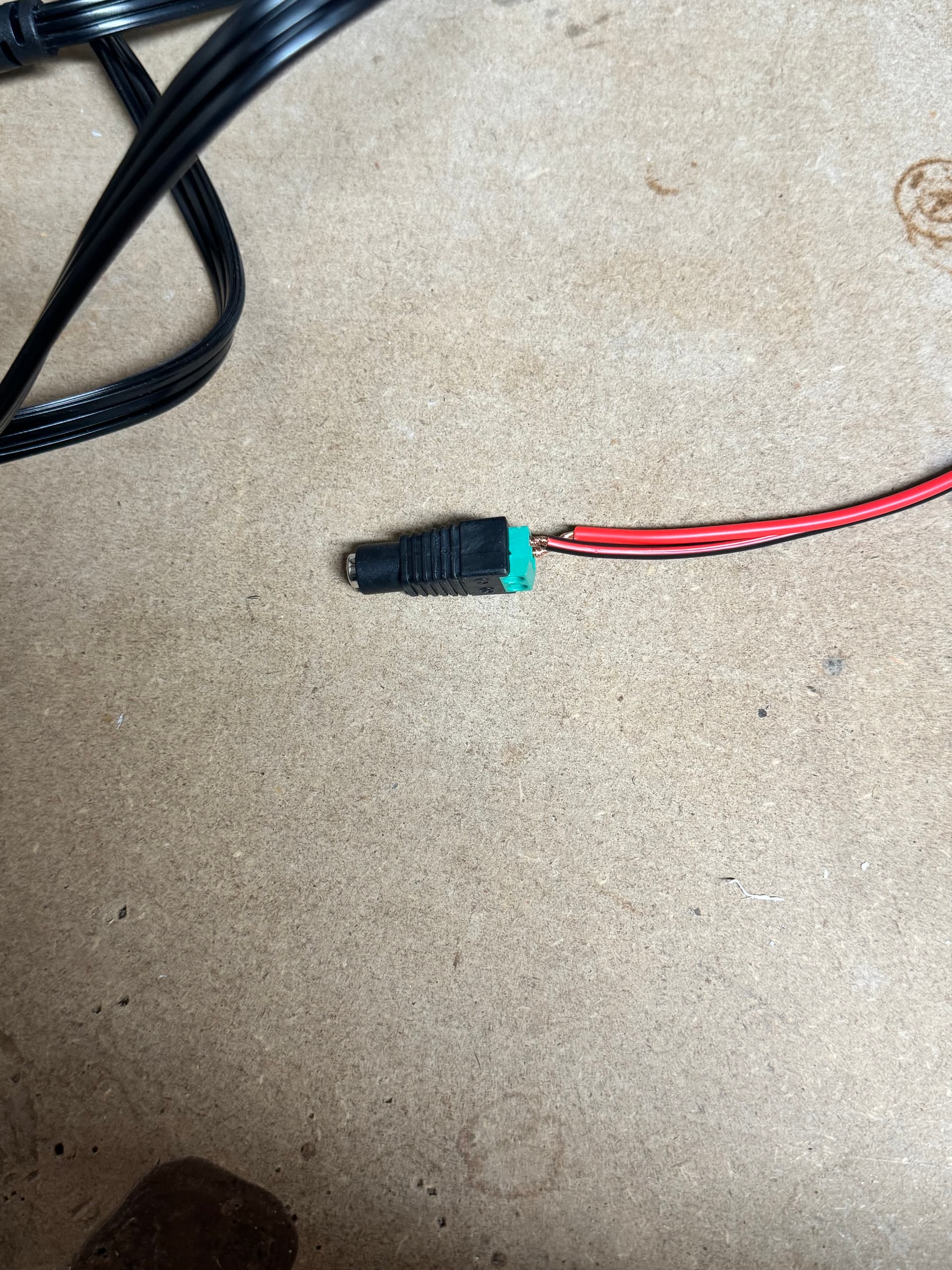

Checked the voltages and I think I figured out what the issue is. There’s 12V coming out of my power supply, but when I hook up the connector below nothing comes out. I’ve tested it both with the wires attached and just sticking the multimeter needles directly into it and it was 0V either way. Could it just be this piece that’s faulty?
This was the issue. I used some electric tape and connected the bare wires directly to the plug from the power supply and all the lights now turn on the board.

Also, I note in your picture that there is stranded wire going into a screw terminal.
That’s not best practice. Over time, the twisted wires will compress, and that loosens the wire in the terminal, allowing it to work out.
Far better for that is either to use a crimp ferrule (if you want to keep using screw terminals), or switch to a terminal block that uses lever or spring clamps to secure the wire. Those keep constant compression on the twisted wire so that problem goes away.

The problem is that you left a bunch of bare wire sticking out from the green screw terminals , and they are touching each other and shorting out (hence the 0 volts).
Wiring directly to the SKR board is probably more reliable overall, but with proper installation, the barrel connectors are fine to use (just don’t leave any exposed wiring).
