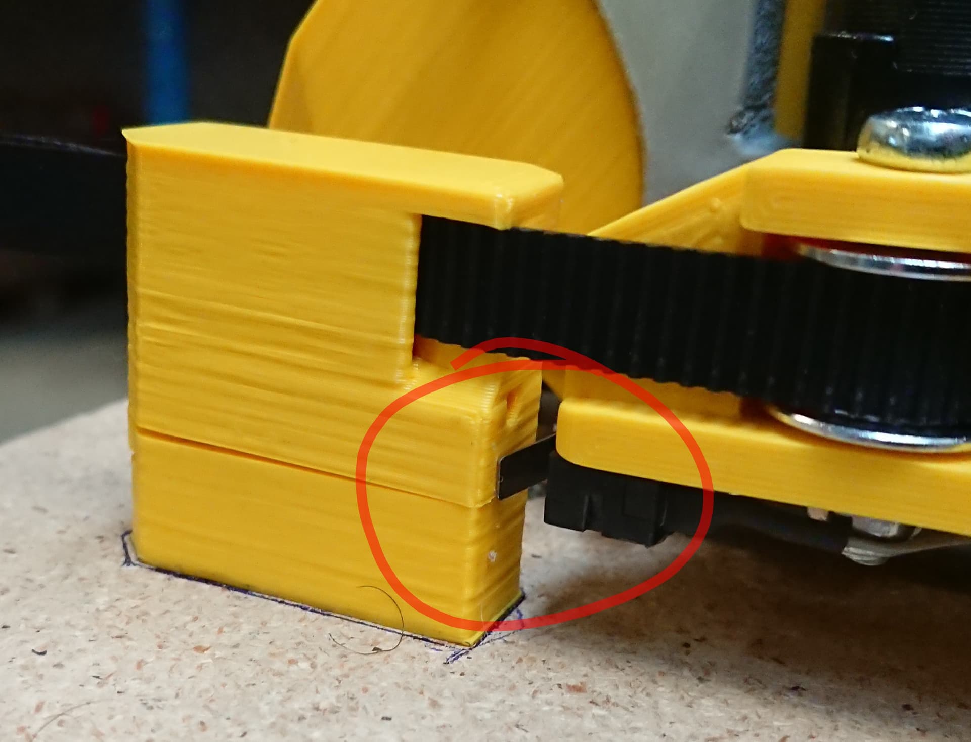

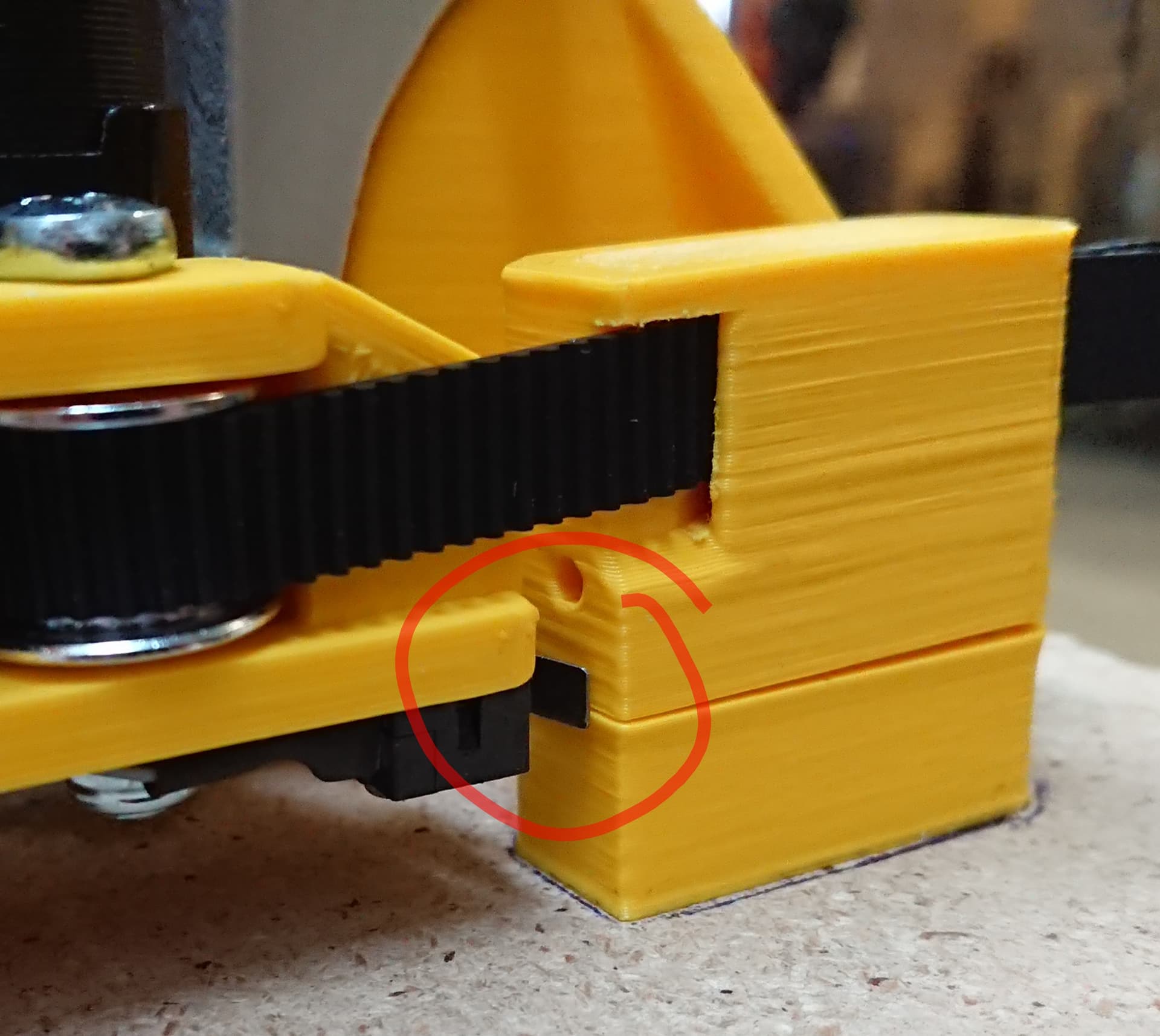

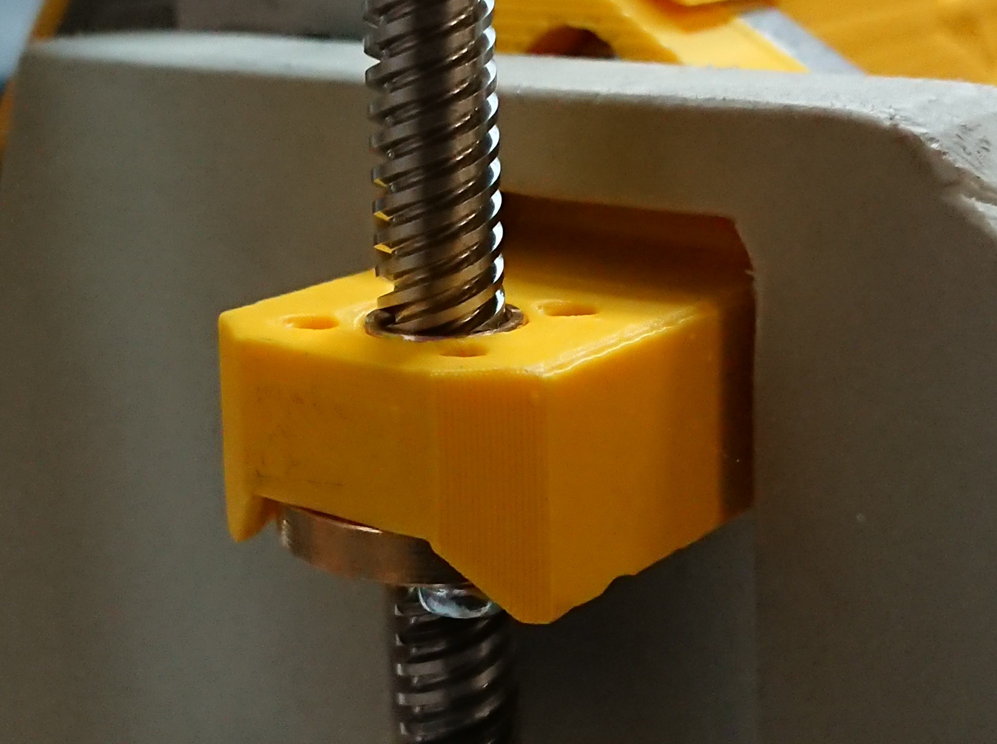

You can remove all of the endstop LEDs if you want to. But we need to make sure that is your actual issue. Are you sure that your XZ plates are able to reach your limit switch? Sometimes you have to bend those down a little bit for the endstop to be able to trigger before it hits on the YZ plate opening. On your Y is your endstop able to hit the block?
When the endstops are clicking, I have approx. 4-5mm between the top of the XZ lead screw stubs and the roof on the inside of the YZ plates:
On both sides, yes:
Yeah you have all of that correct. As long as your wiring is all good then see what happens after you remove the LEDs
