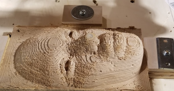

Biggest thing to keep an eye on is making sure your Z tubes clear any 3d relief cutting you do. Ended up not finishing a 3d relief of a face because the tubes about hit the end of the nose. Still had a half inch to go! Even the roughing pass looked cool though.
If you keep your z tubes above the bottom of your collet it should always be able to clear your work. I have mine closer to the top of my collet, which needs longer z tubes but less chance of collisions.

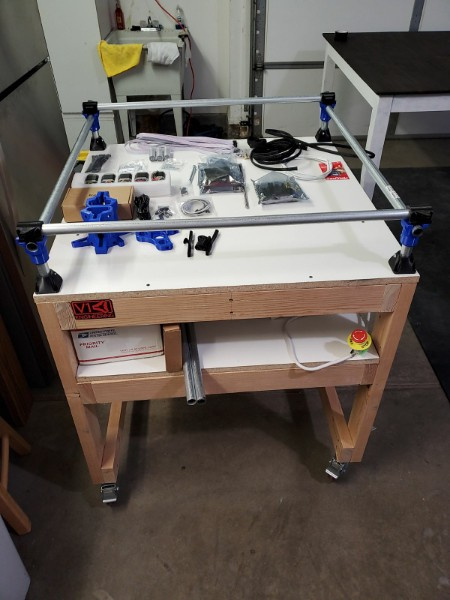

Thanks everyone for the advice and help! I started the build last night and I’m 14hrs away from the final printed part!
Im pretty sure by Saturday I’ll at least have it moving and maybe by next weekend I’ll have my first cut if everything goes well!

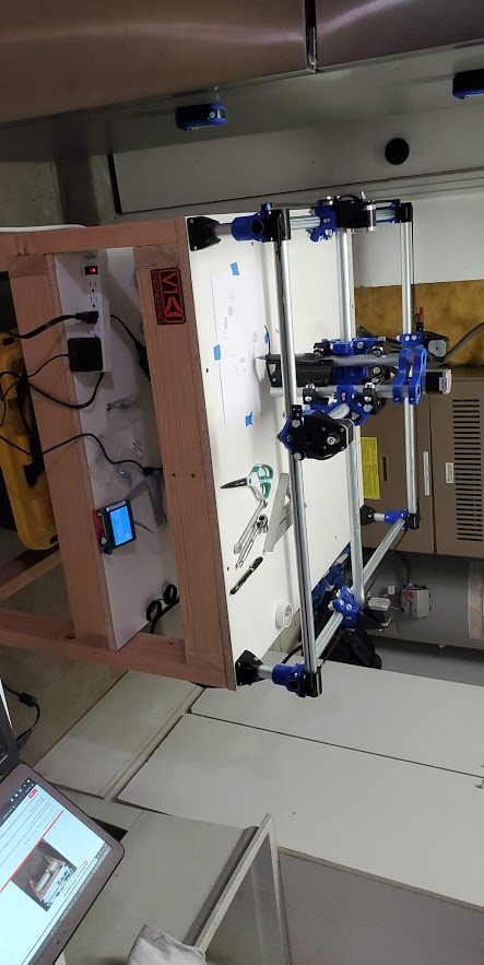

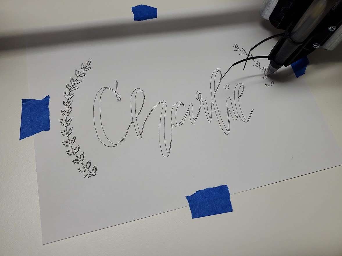

Its done! I built it all up today and got my first couple drawings!

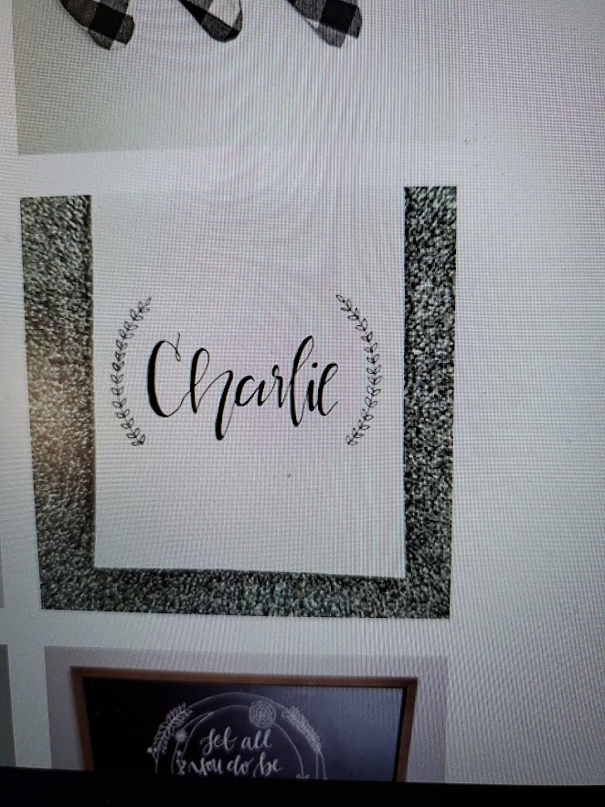

I even figured out how to convert some of my wife’s Instagram photos into vector files so I’ll eventually be able to carve them out of wood!
