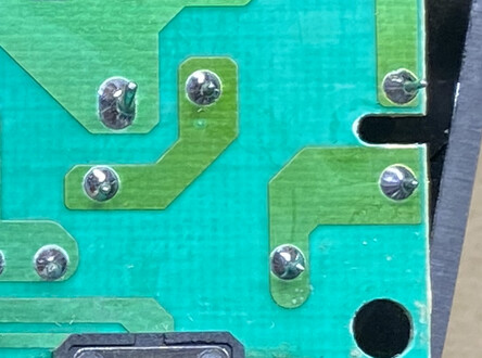

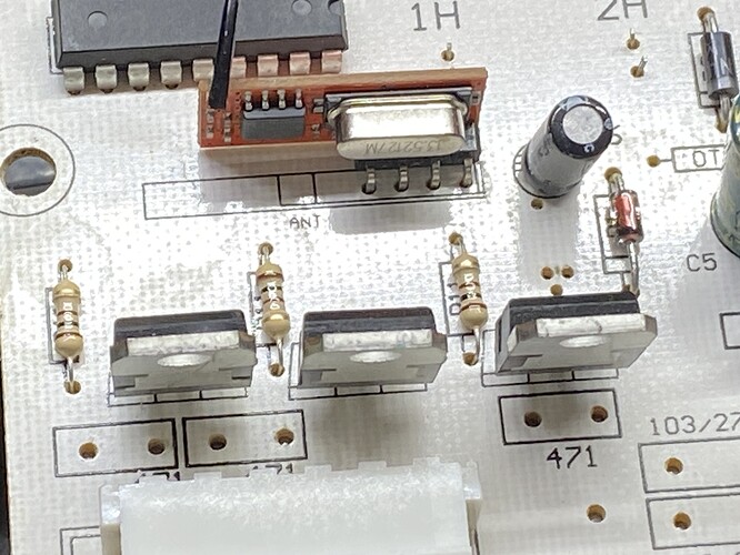

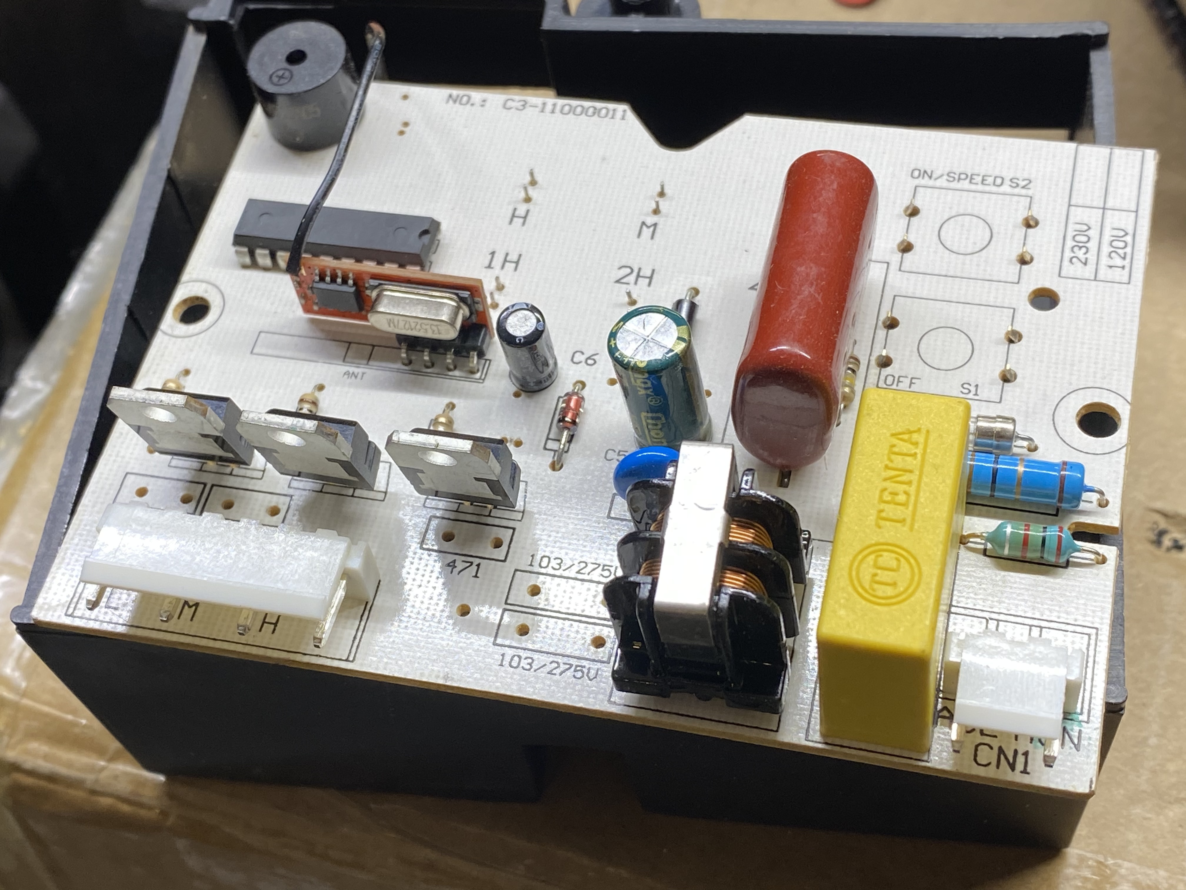

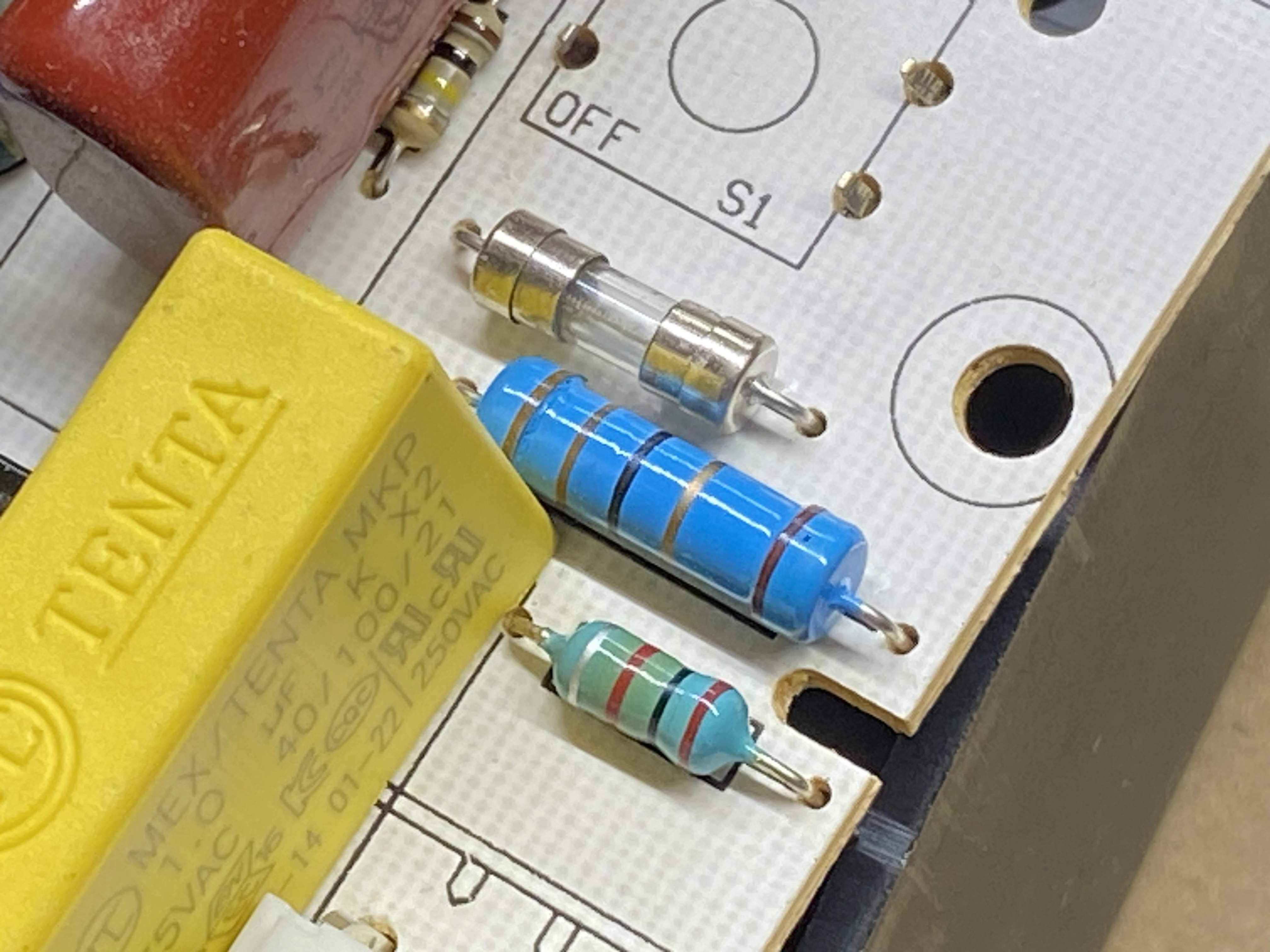

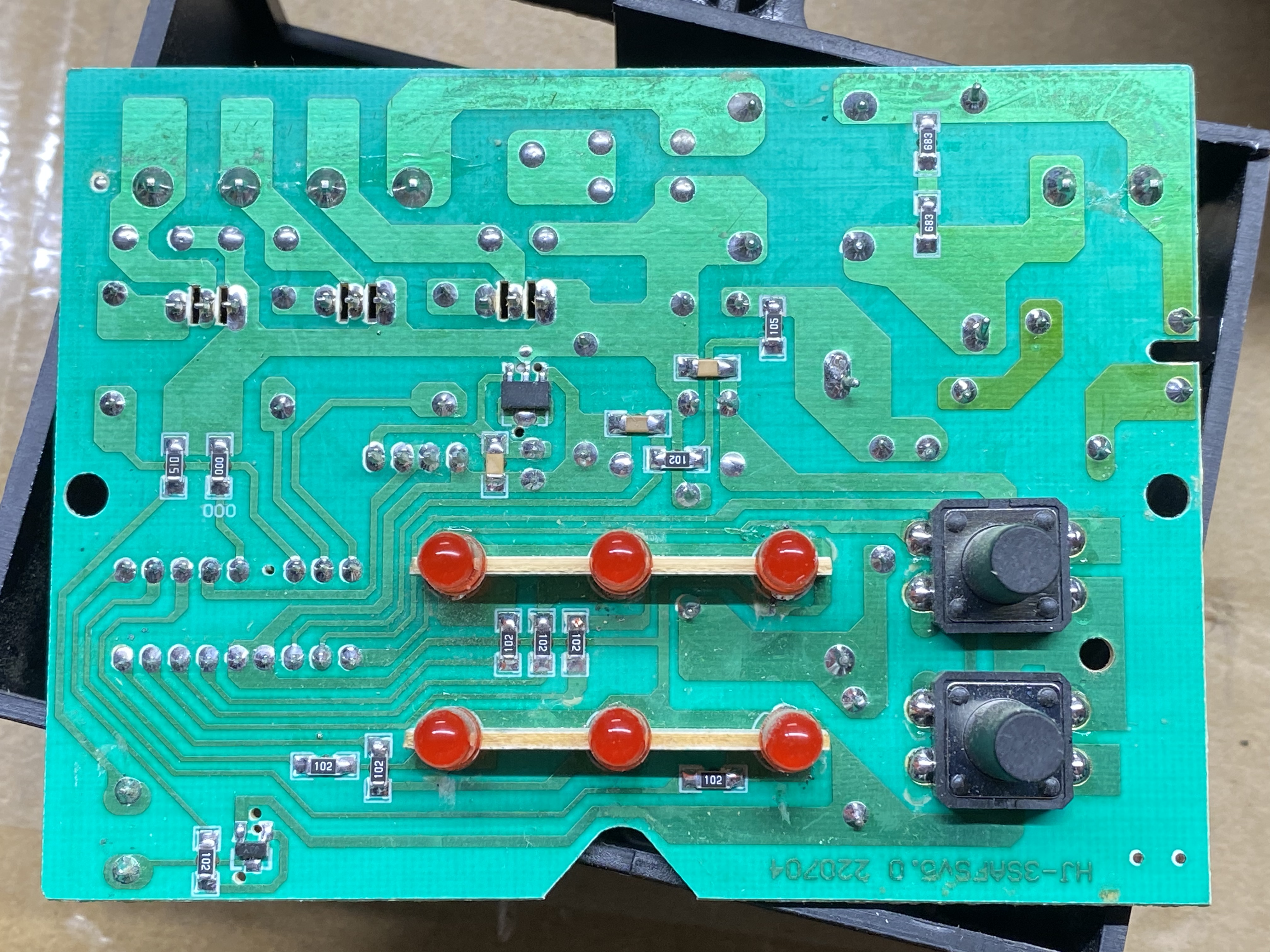

Also, I did get it dismantled and I got pics of both sides of the main PCB. I cannot really see any immediately obvious issues. I do see something on the PCB that looks like a small fuse.
@jono035 do you see anything in these pics that stands out to you? Any other advice?
Nothing immediately jumps out at me.

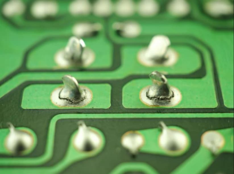

Single-sided PCBs are notorious for having cracked solder joints, though, so I’d take a closer look at some of those.
Specifically with ones like that, it looks like it could have a circular crack in a ring around the pin. The soldering all looks a little hit and miss which could cause that as well.
Basically you’re looking for anything that looks like this:
Although obviously that’s an extreme version of the situation. If there’s anything like that, thoroughly re-heating the joint with a soldering iron and adding some fresh solder can help.

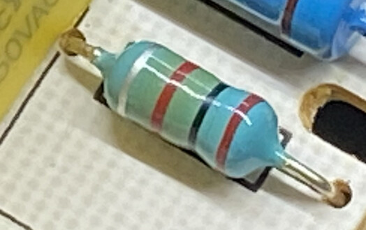

That resistor on the input looks like it has seen a fair bit of heat, along with the discoloured traces on the underside.
Perhaps give that a measure with the multimeter on resistance mode and see what it says. It should be 1KR (Brown Black Red Silver = 10 *10^2, 10% tolerance).
There’s also what looks like a mini voltage regulator which would be worth checking the output voltage of with the board plugged in. That starts to get a little sketchy, though, so I’d personally advise doing that only if you’ve got an isolating transformer or are confident working with mains voltages.
Beyond that, there’s not a whole lot there. The 3x TO-220 package devices are likely FETs, although the way the circuit is laid out is a little bit weird. They appear to have unrectified mains voltage across them which would conduct backwards via the body diode, so maybe they’re actually SCRs or something odd like a JFET… I feel like I’m missing something there. Either way, I suspect if they were the issue you’d either be popping the fuse or it would be beeping/flashing LEDs without the fan moving.
Pretty simple damn board all told, so there’s not a whole lot that should be going wrong with it. The fact that it’s doing nothing at all makes me think broken joint or open circuit resistor.

OK, my first test of the resistor was before desoldering it from the board, but given that my ohm test with my multimeter consistently told me 3.2 M ohms (note: M, not K) I’m thinking that resistor is indeed toast! I’m thinking I will check my stash of resistors and see if I have the right one, desolder old, solder in a new one, and see if I get success. Sound right?
That’s the general idea, although I’d expect that it’s a little unlikely you’d have a resistor that’s a correct replacement. It looks like a larger high power type, which would be consistent with the heat damage.
If you measure the dimensions it’d be possible to roughly guess the power rating based on that, but given that it has already been overheated once, I’d probably replace it with something higher rating. The main issue there being that it can be a challenge to get them to fit as they’re usually longer. What are the dimensions of the resistor?
At a guess I’d say it’s drawing 10-20mA which would be around 1-2W… Finding a 2W replacement would probably work, as would wiring a few 1W ones in parallel.
It’s also worth noting that the resistor could have just failed due to being under-rated for the application or due to a persistent high-line condition or similar causing it to run hotter than normal, or it could be due to something else having failed, leading to it drawing more current and the resistor eventually failing. With faults like this, all you can really do is fix the first and most obvious one then give it another try.
I’ve desoldered the resistor, and it reads as “OL” (overload). It’s about 7.7 mm long and at its thickest point it’s about 3.3 mm in diameter. It looks beefier than my stash of resistors. It’s way bigger (fatter) than the 1K resistors in my stash.

My next step would be going to Digikey.com and using their parametric filters to find similar resistors. We know it’s a 1K 10% resistor and is ~3.3mm OD, ~7.7mm long.
That size doesn’t quite match up with common lengths, but the resistors are measured from where the metal terminals start and you might have measured the main body length, so I’d assume it’s maybe 9mm long.
That gives a couple hundred results:
Hopefully that link works, if you wanted to look for yourself.

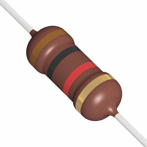

The highest power is 2W so I’d think that’s a pretty reasonable assumption.
So for replacement, I’d probably try a 2W 1KR resistor.
Something like this:
Alternatively, if you wanted to give a bit of headroom or you could more easily find 1W resistors, you could use a pair, either 2x 2.2K to make 1.1K parallel or a 2.2K and a 1.86K, that kinda thing. 2x 2W resistors would give you 4W total so would run roughly half as hot as a single 2W, for instance.
If you wanted to do a quick test with resistors on hand and you’ve got 1/4W ones, you could do the same thing by using 8 or more 1/4W resistors in some combination of parallel/series to make an equivalent to a 2W one.
8x 8.2K resistors in parallel would be 1K with a 2W rating. 5x 2.7K resistors in parallel would make 510R and then 2 of those sets in series would make 1K with a 2.5W rating. 10x 100R in series would make 1K @ 2.5W, etc. Any of those options work. For them being in parallel you can just solder the first one in and then start adding extras ‘on top’, tacking the legs to the previous resistor. It’s not the ‘best’ solution, but it’d work well enough.
